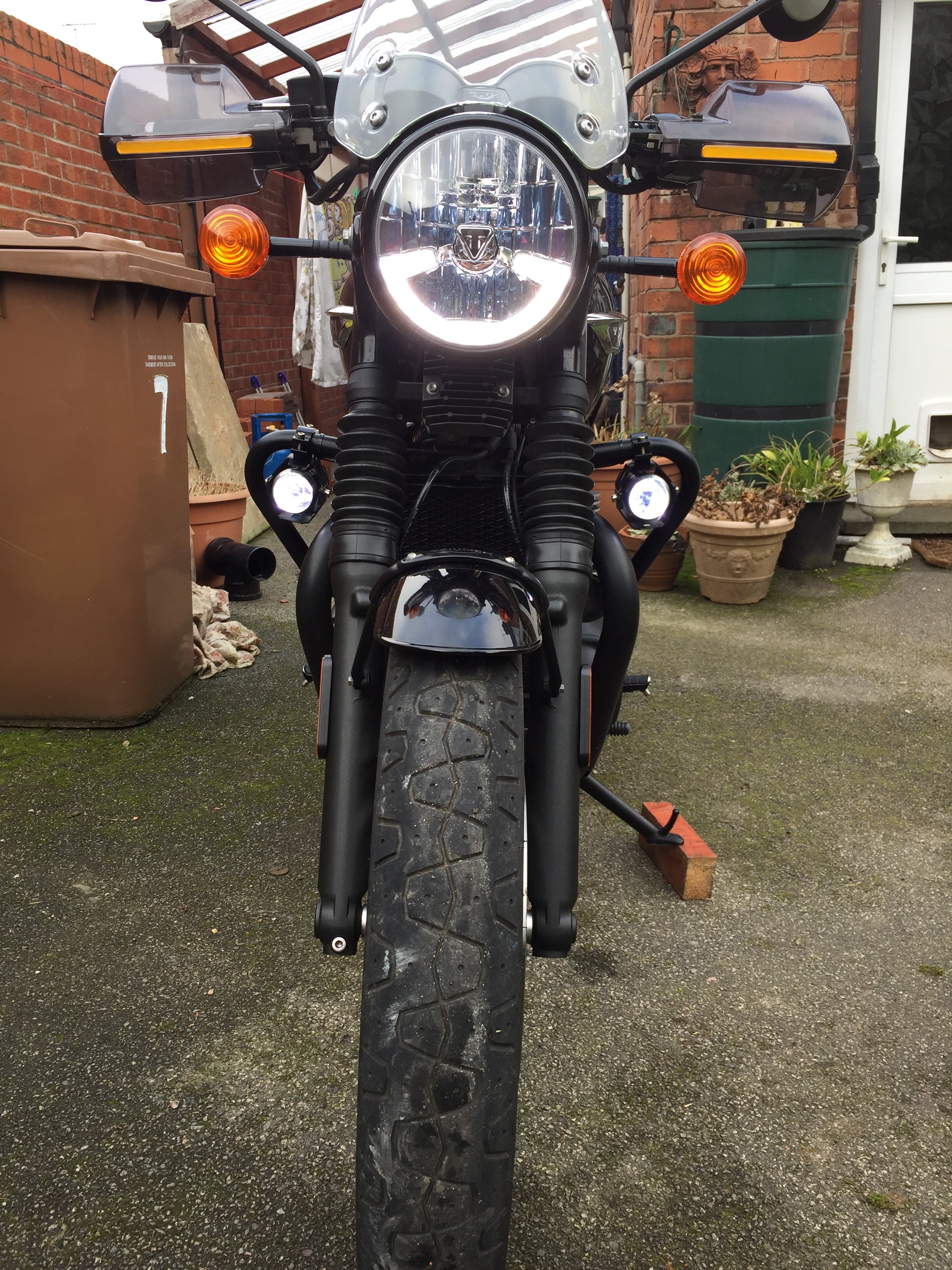

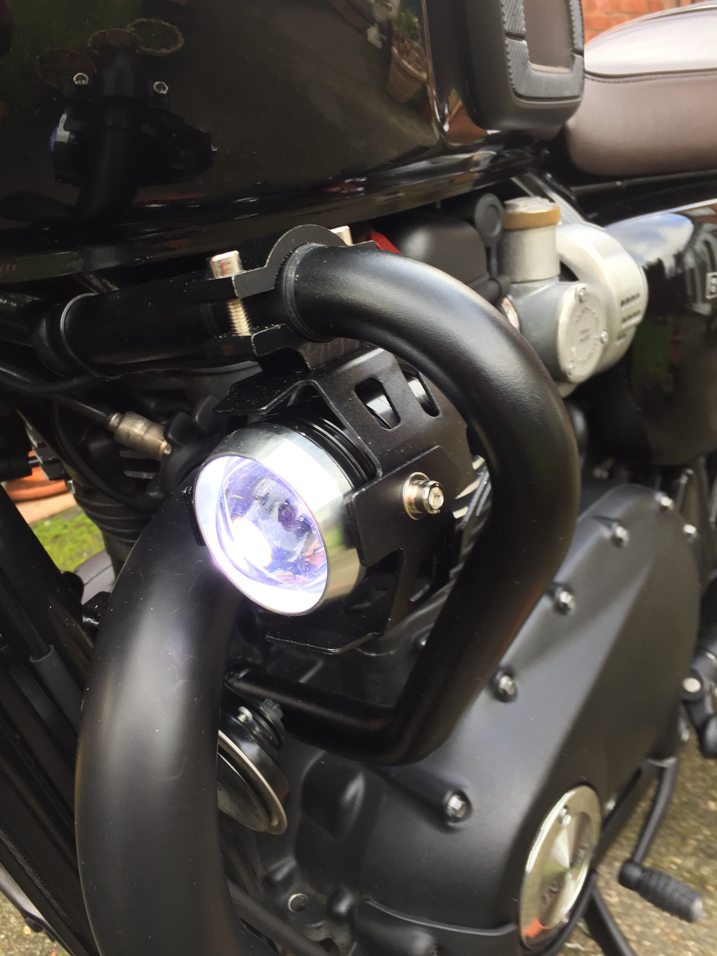

Have bought a pair of those Cree fog/spot lights, complete with switch and am planning on mounting them on the inside of the crash bars. Might even put the switch on the crash bars as well to save running wires up to the handlebars!! So, is there anywhere nearby to pick up the 12v from (post ignition switch, of course)? Thanks

Any thoughts on this anyone? Have took the seat off and lifted the tank. No sign of any auxillary power socket. Does the T120 have one? Has anyone else fitted any auxillary devices to a T120? Thanks
OK - Found a 12V ancillory socket under the tank and have wired the spots to it. Was a bit disappointed that the socket is live all the time, not via the ignition switch - will have a think about what to do about that another time. But spots fitted and working
Have just been out for a Sunday morning ride with the new lights glaring. I think a lot more cars that normal pulled over towards the kerb as I came up behind them I'll reserve the flashing mode for when filtering

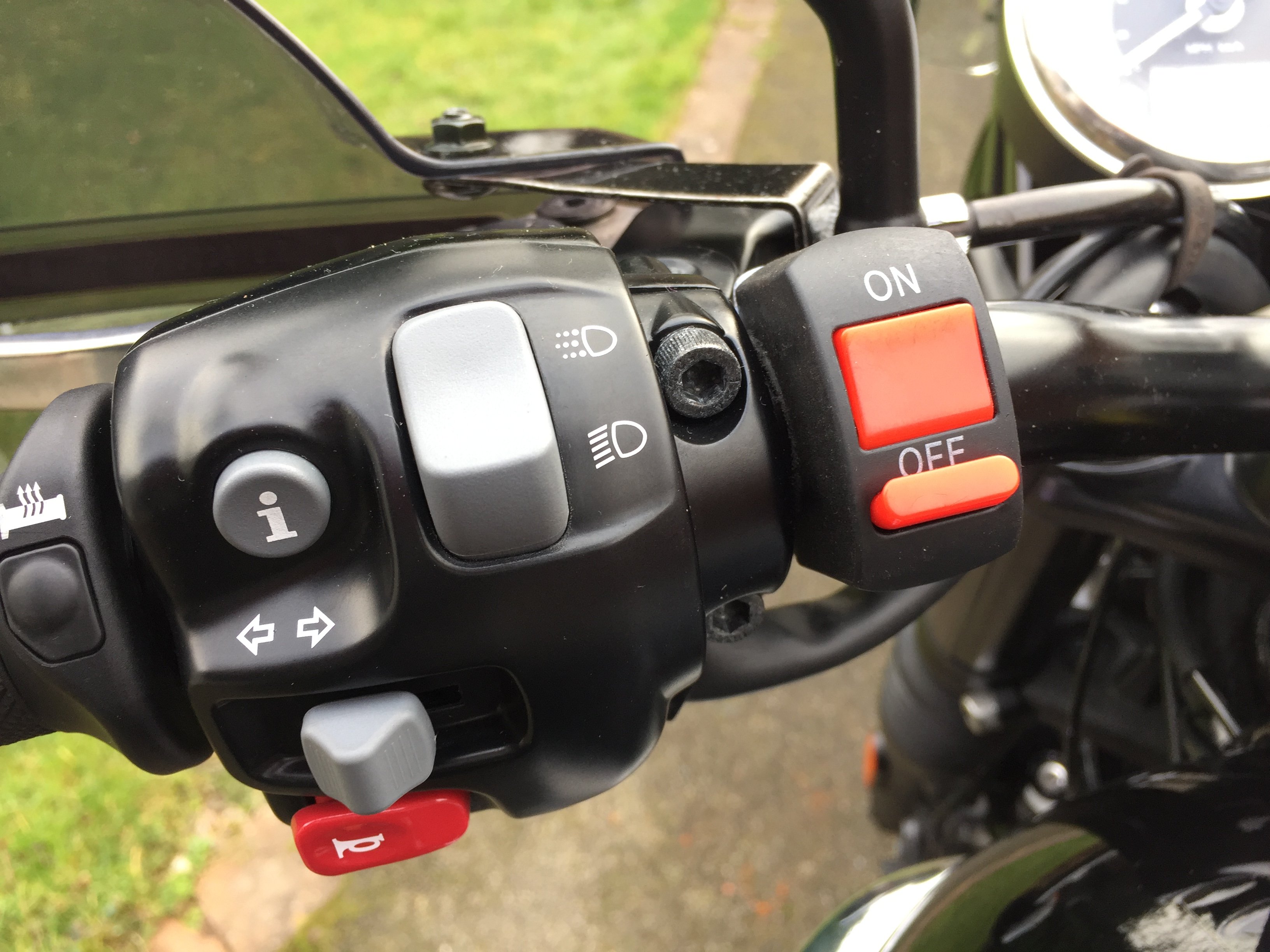

Can anyone recommend a decent switch for these that'll fit the 1 inch handlebars? The one that came with the spots has proved to be far from waterproof ;-)
Thanks Mischa - Those look ok but are pretty expensive. I've actually took a punt on one of these now - http://www.ebay.co.uk/itm/282230941054?_trksid=p2057872.m2749.l2649&ssPageName=STRK:MEBIDX:IT The ad. says the mounting diamenter is 24mm so I'm hoping its enough, or that there's enough meat on it to remove and make it 25mm Will let you know when it arrives from HK.
