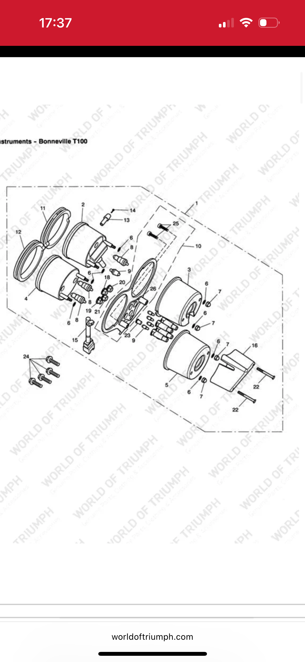

    Evening all. I’m looking at swapping out the single Speedo on my 2006 Carb Scrambler with the twin T100 Speedo and tack set up. I’ve got hold of the twin clock holder with a tacho but I’m trying to work out how it fits to the yoke/bars. The scrambler one bolts onto the top bar clamp but the holes are in different locations.
    Looking at the parts manual it shows the clock mount in one page and the bar and yoke in another but not how they are fixed together. Any help or part number for the mount would be useful

    Does your yoke have the four bolt holes?

    From memory the optional tachometer for that model was a smaller diameter than the speedo and fitted on the other side of the top yoke, nearer to the tank.
    I think that you will find that the top yoke (part 12) on the diagram is different for the scrambler and the T100. Check World of Triumph's parts for the 2006 T100.
    Then you have to establish whether the top yoke for the T100 will fit your scrambler - Happy days! best of luck

    Thanks for the reply. Having done a bit of digging the yoke is definitely different as it doesn’t have the mounting points. I’ve got hold of a T100 top yoke so going to attempt to swap it out.
