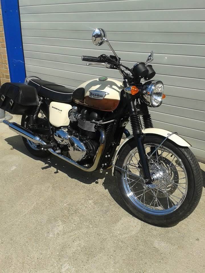

  18. TBone
    TBone New Member
    Dec 22, 2020
    25
    Bexhill-on-Sea
    piccy before it being in storage
