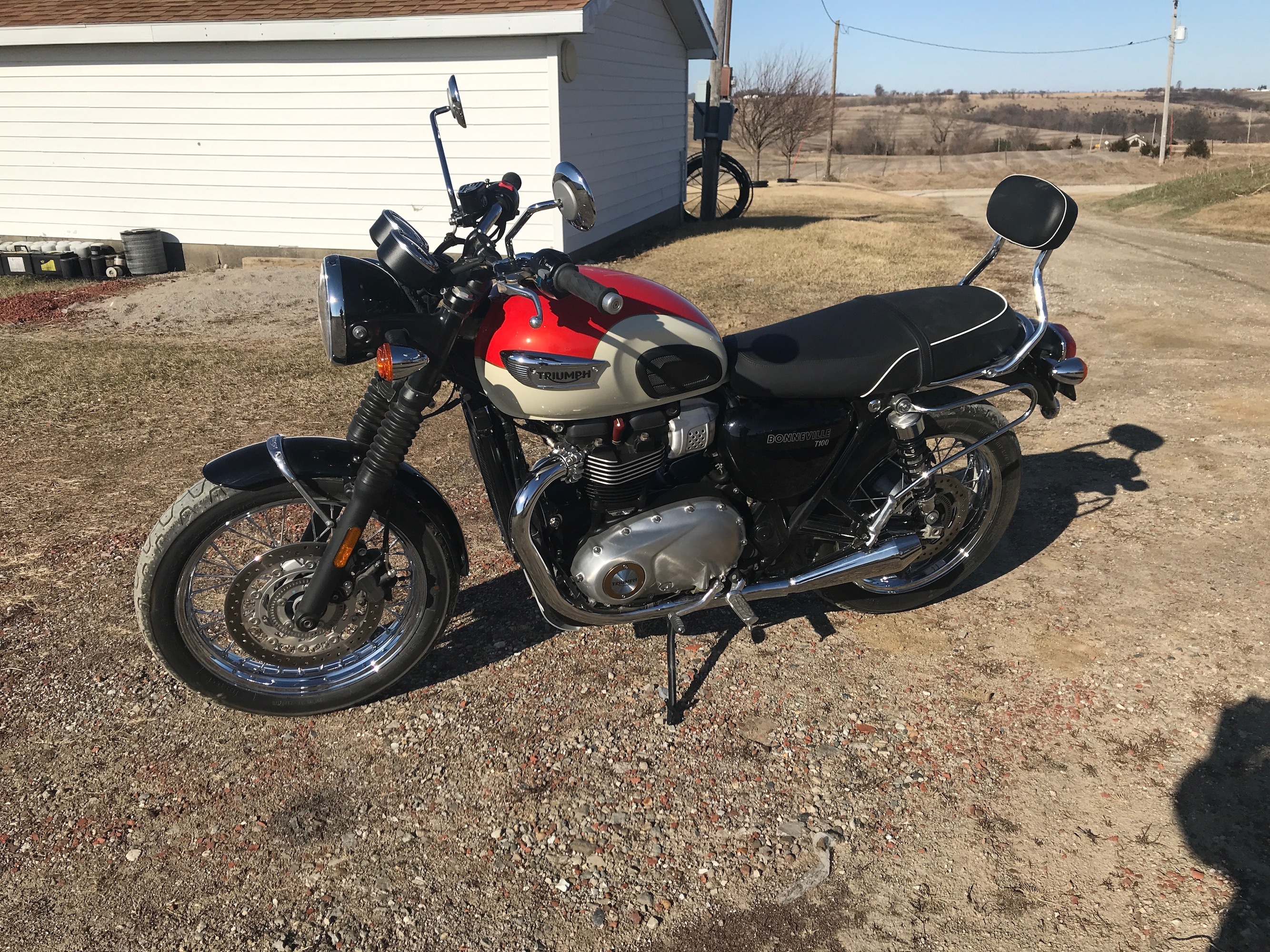

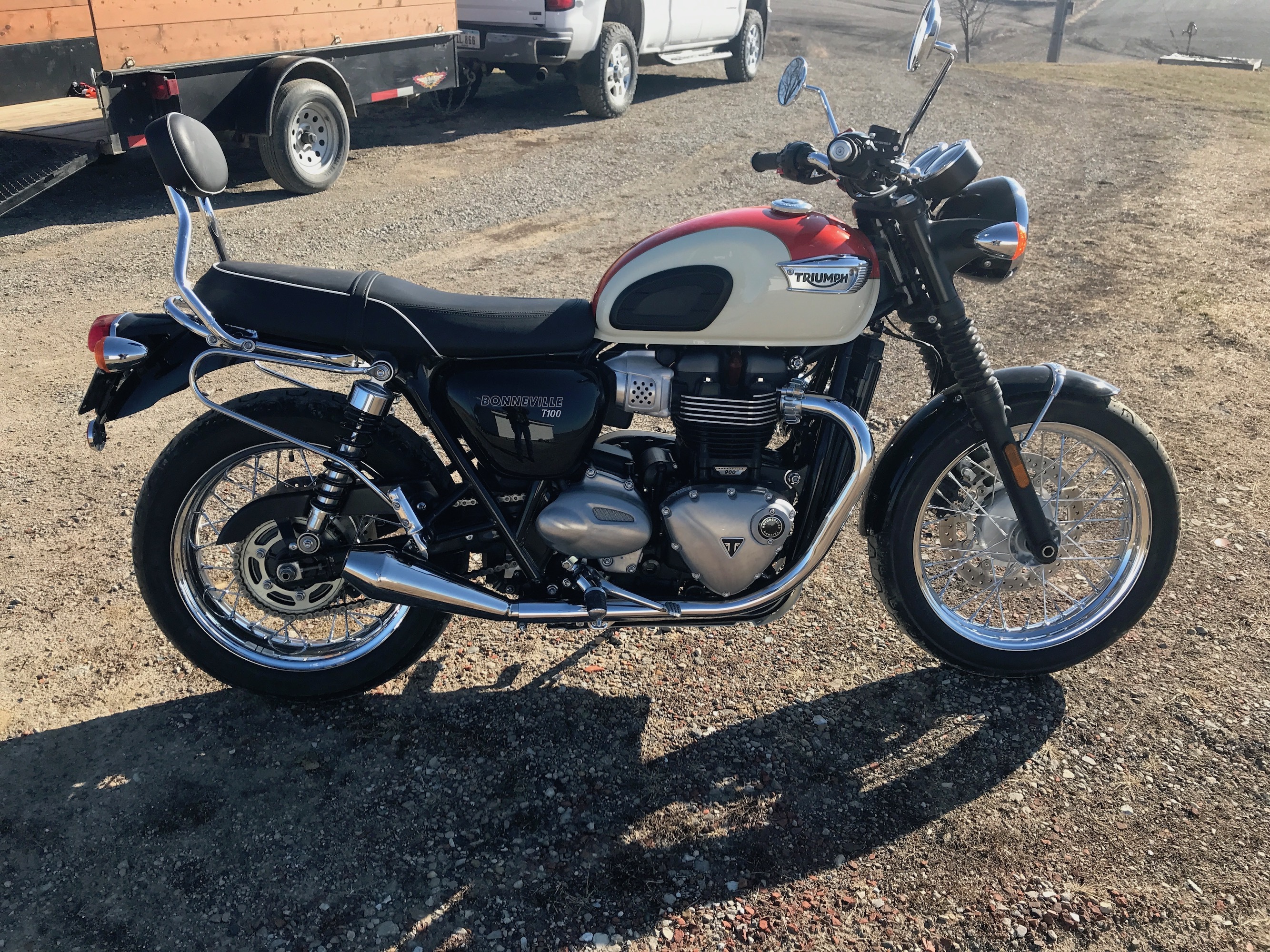

    Yeah, I have to travel a couple of miles of gravel road to get the nearest highway. I live rural and lots of twisties on the hard roads in my area. I really find no problem with the stock tires on my 2017 T100. I might try something different next go around but not certain on what yet. Really haven't spent a lot of time thinking about it.
    My concern this last week was de-catting the bike with a Motone x-pipe, installing a set of British Customs Shorty predator pipes, and installing a Booster Plug. Finished up last night. Really woke the bike up. Far greater performance and it really holds a conversation going down the road.
