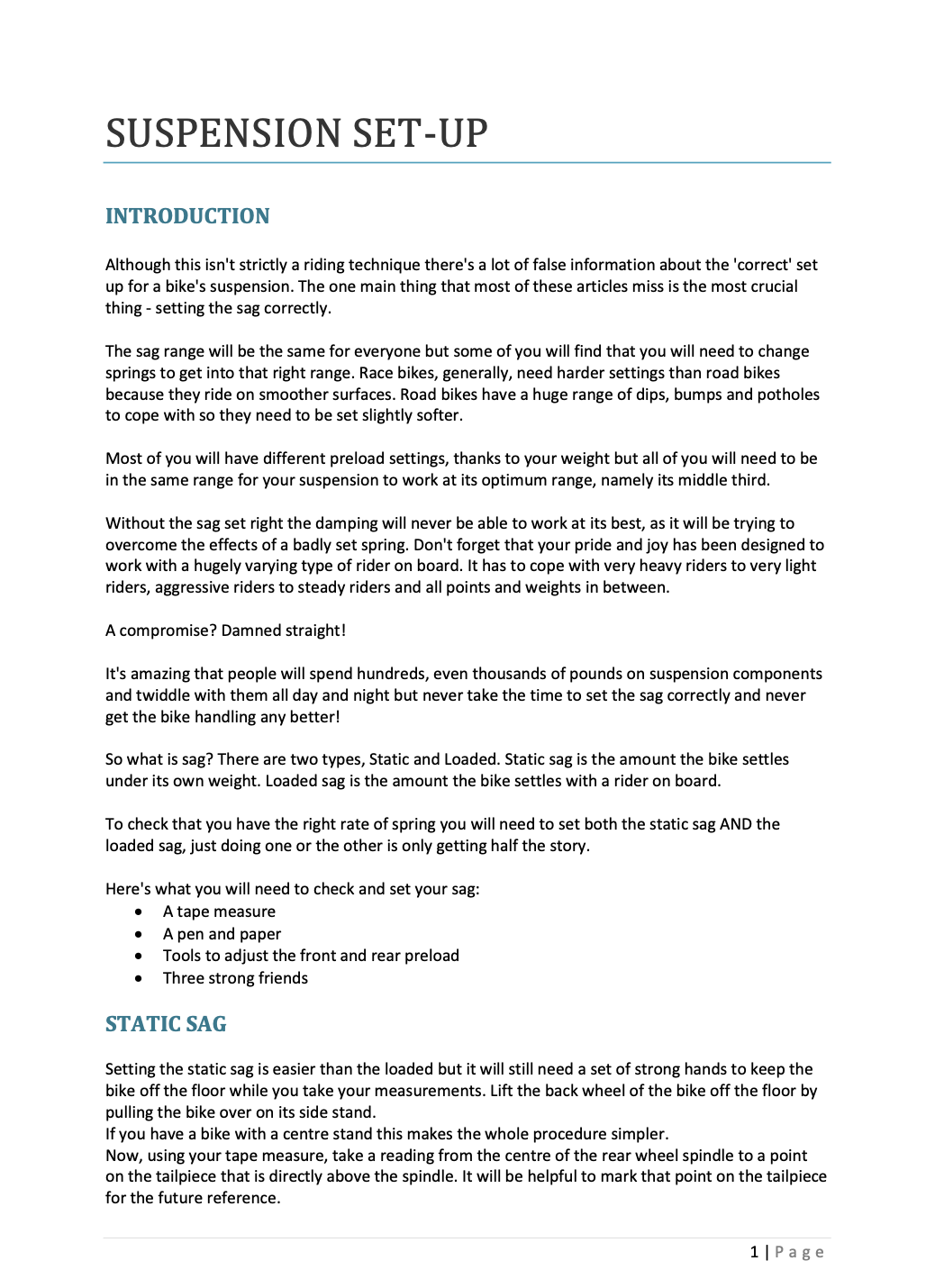

    Would anyone mind providing a suspension 101 for the middle-aged and overweight?
    2010 Tiger 1050.
    Front suspension.
    I get that there is rebound and compression adjustment. I get that there is preload adjustment.
    But...what do these things actually mean. And, not only what do they actually mean...but what does one actually feel?
    Do I want more rebound? Or more compression? What will I feel with which?
    What will less preload mean?
    I spend a lot of time finding with setup when it comes to positions of clutch or levers, handlebar rake etc...but never suspension as it seems like a dark art.
    I'm not racing or anything...just pottering round Oxfordshire, speed humps etc...may be a pillion now and again.
    Thank you!

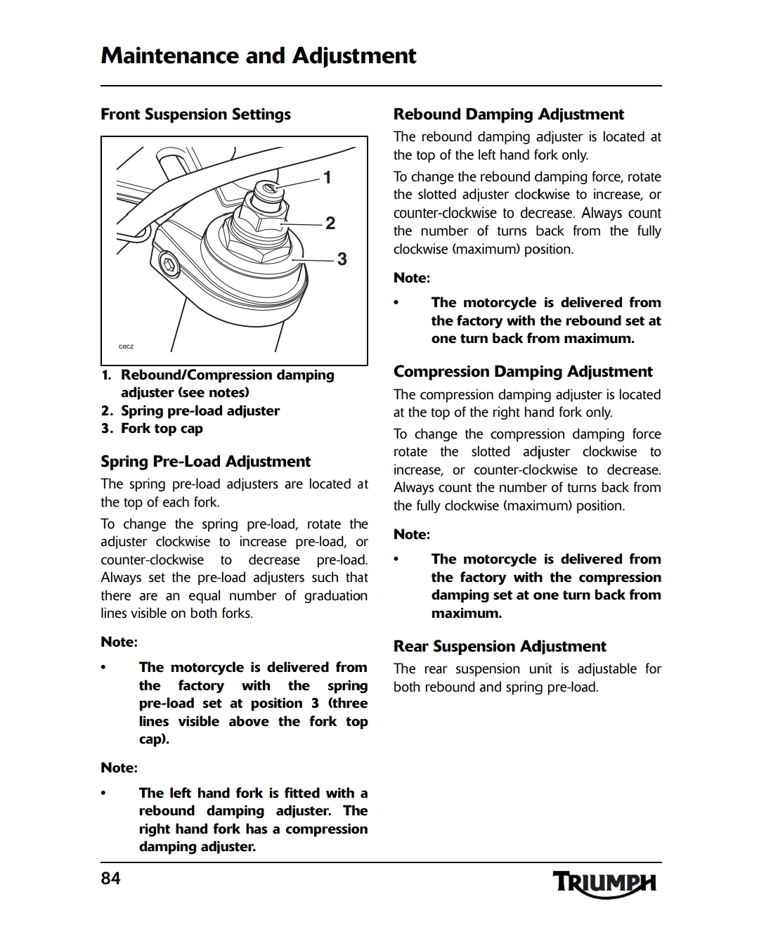

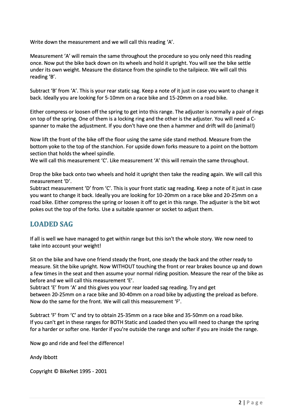

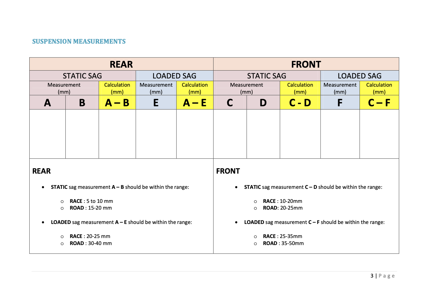

  4. Helmut Visor
    6,389
    Screenshot 2022-05-06 at 16.26.38.png Screenshot 2022-05-06 at 16.26.56.png Screenshot 2022-05-06 at 16.27.09.png

    This is excellent @Helmut Visor ; tonight's whiskey homework!
