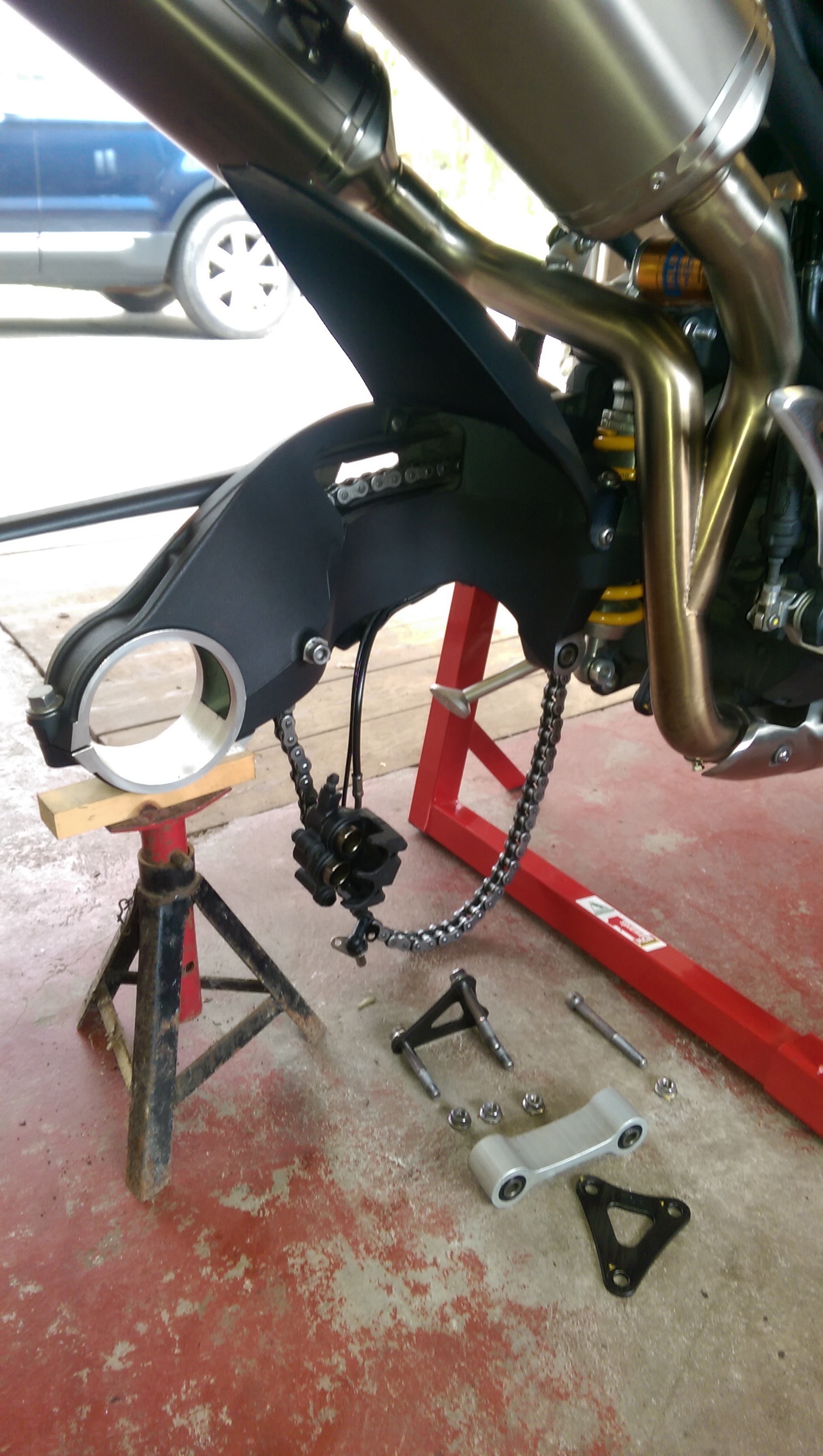

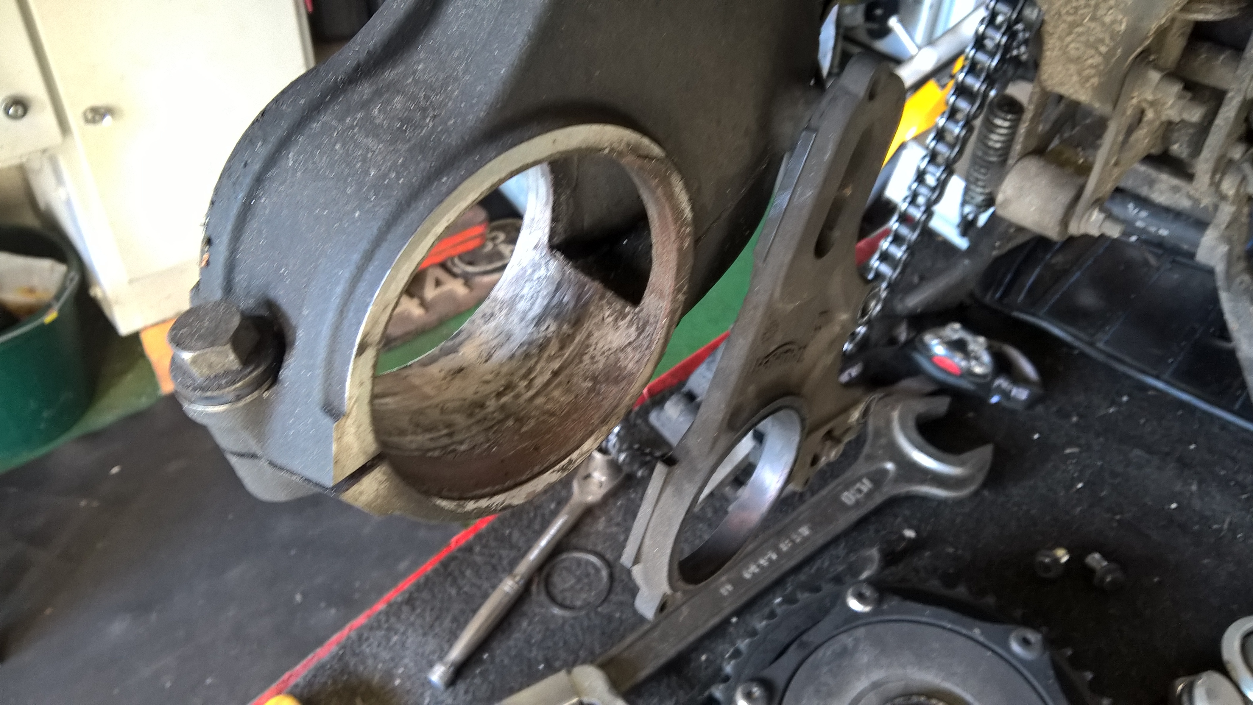

    Just completed a rear suspension and wheel bearing service as part of the full 12000 mile schedule.
    A few observations:
    Firstly this service is not complicated or difficult,it is however very time consuming if done properly, which is probably why dealers charge so much.
    The subject of this post is the rear suspension an wheel bearing part.

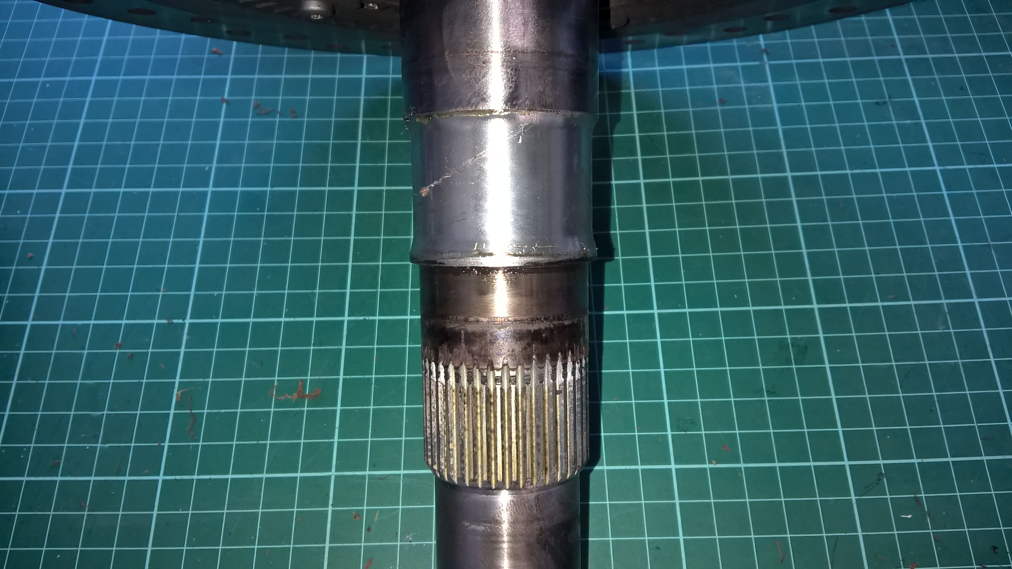

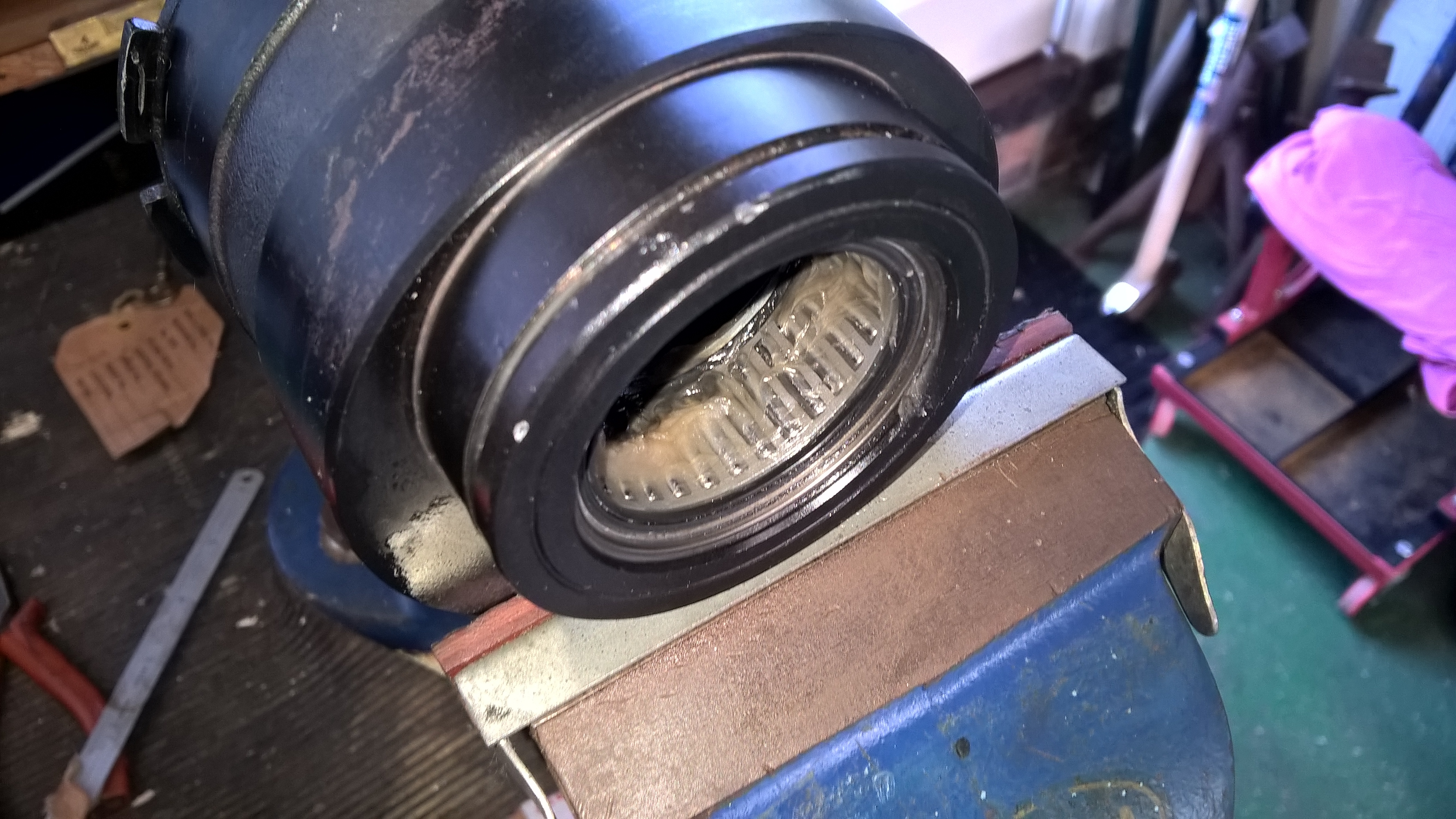

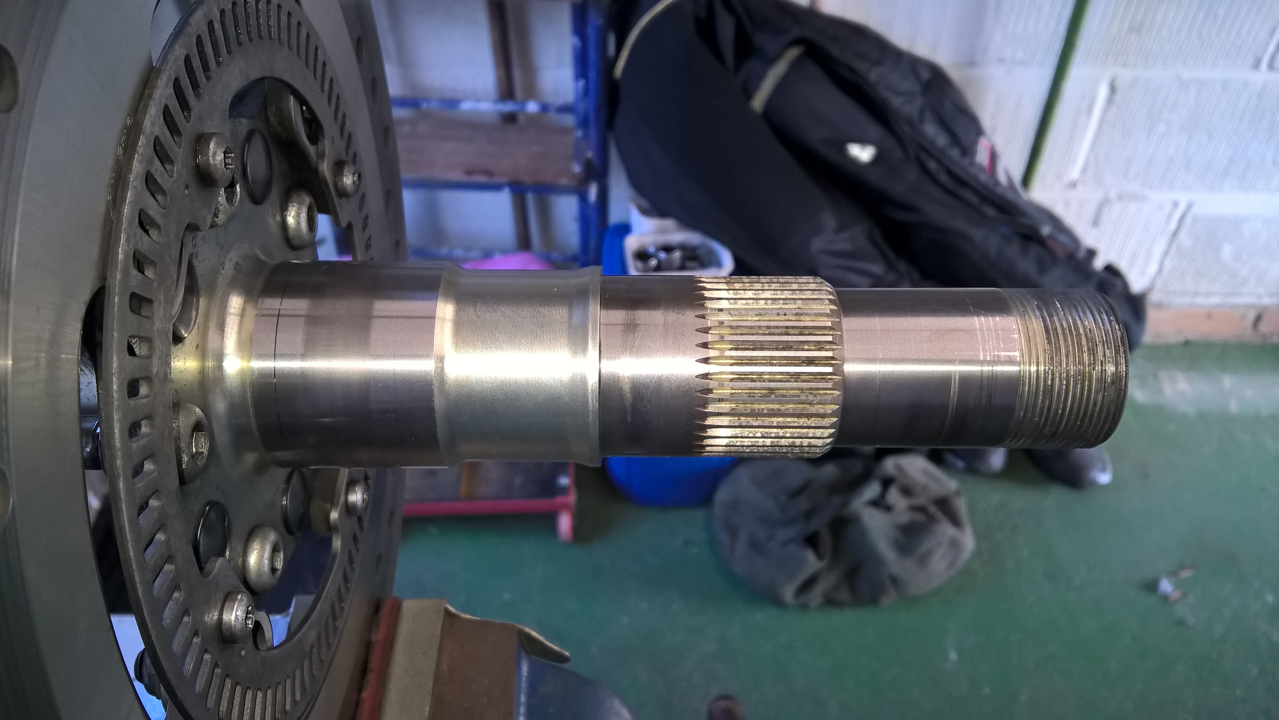

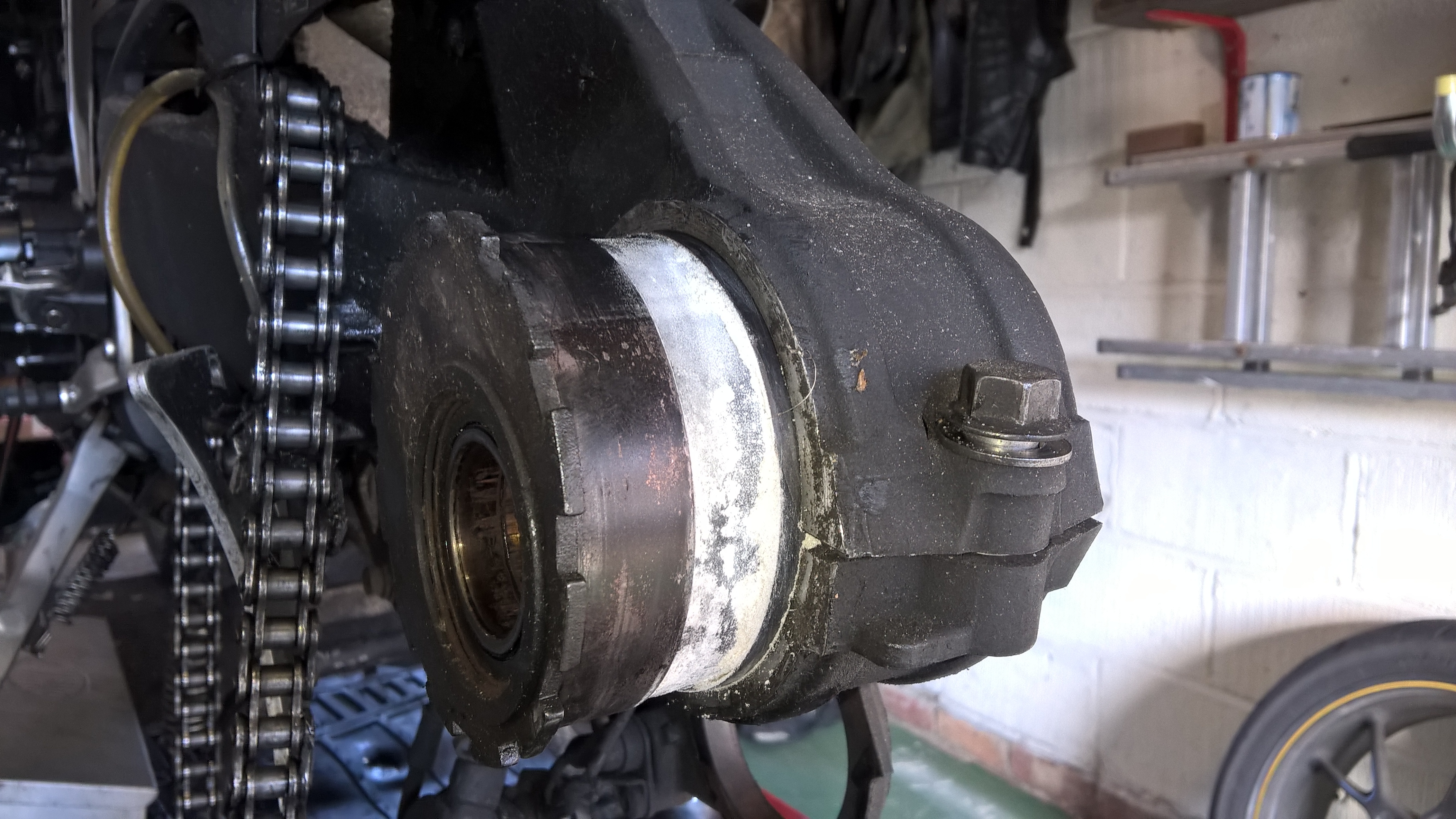

    After securing the bike on the ramp having first loosened the wheel and spindle nuts l removed the wheel and axle, there was not much grease to be seen in the needle bearing which is probably why it is a service task.
    I had noticed that the chain adjustment eccentric was tight to move so l decided to remove it to investigate.
    From the attached pictures it is easy to see why....full of white corrosion.
    If yours is a bit tight to move this is almost certainly the cause, water gets in through the pinch bolt slot and pools in the swing arm.

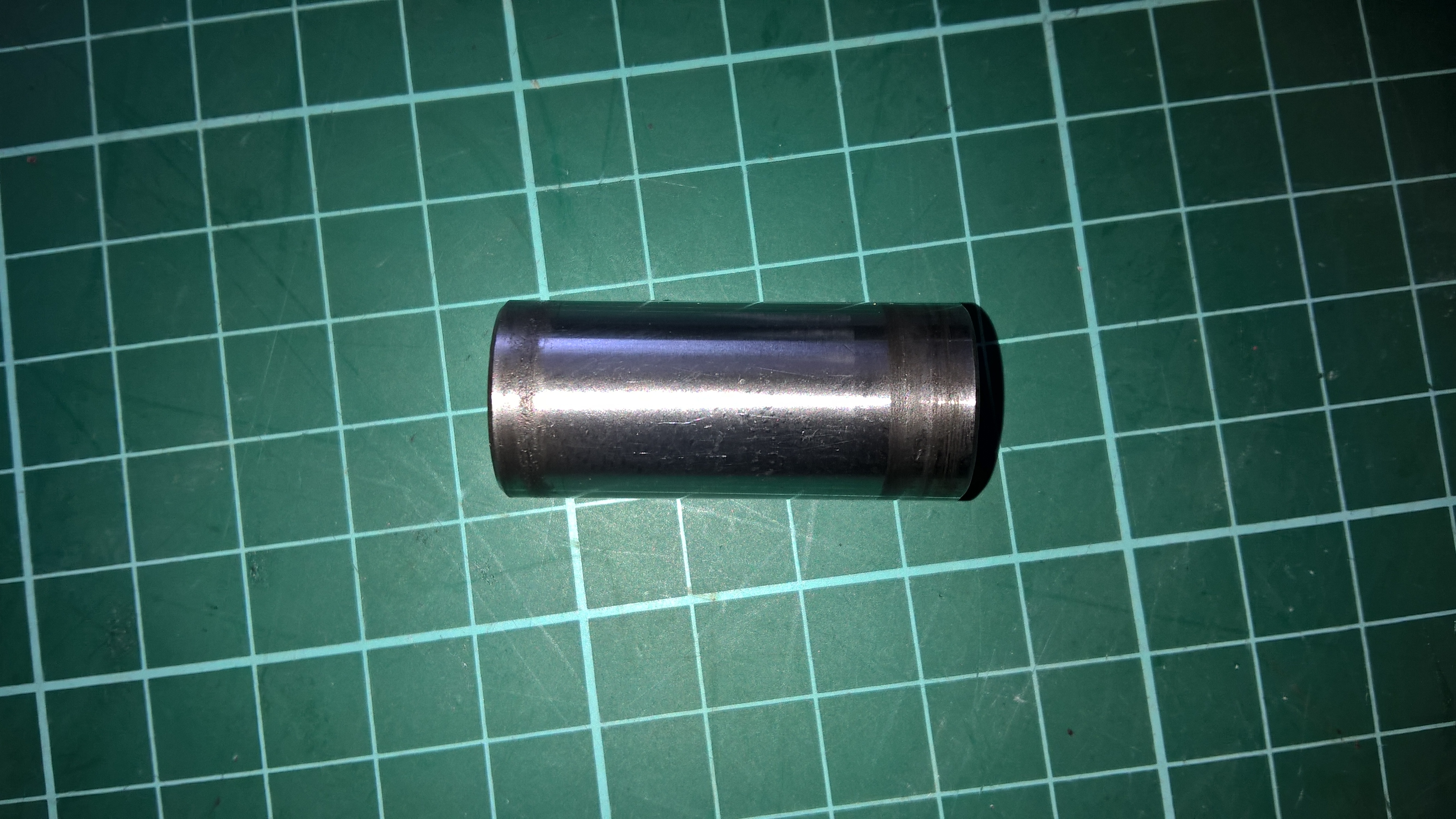

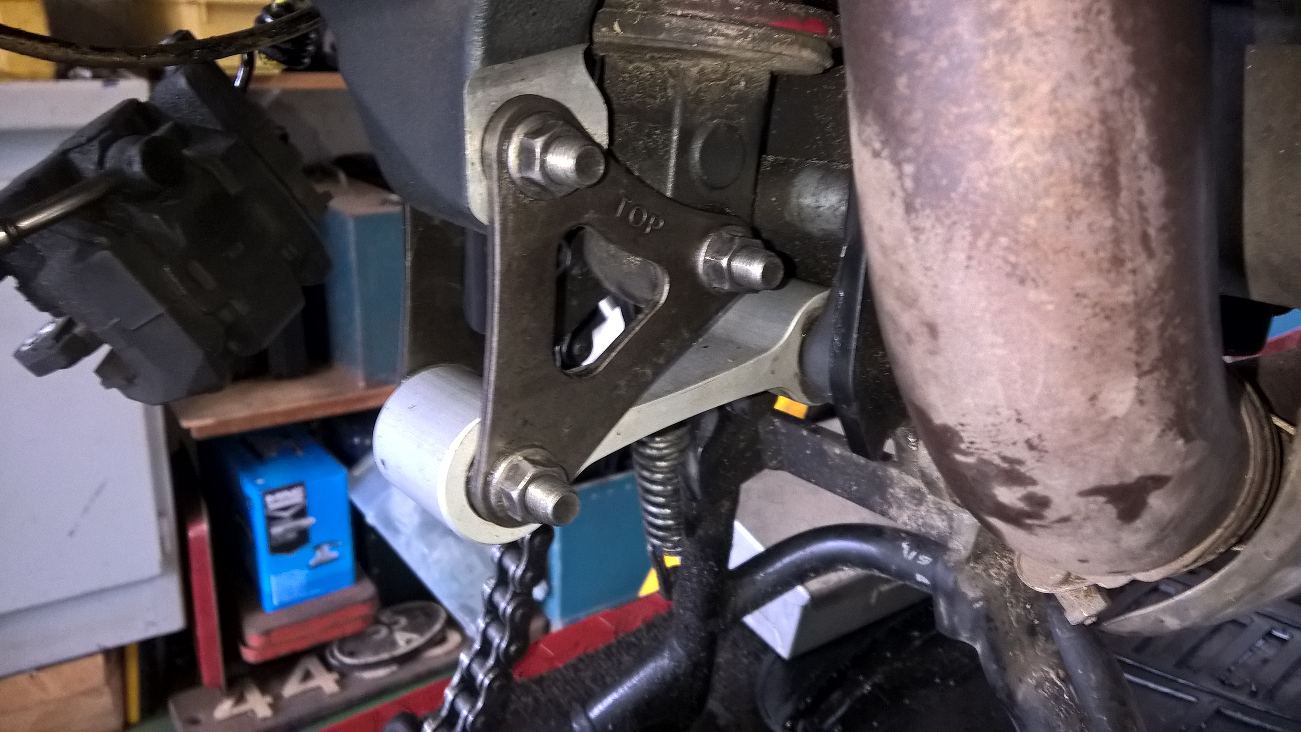

    The suspension pivot pins were also in need of some grease but were found to be unworn
    After cleaning all parts an greasing all was well.
    I am not sure if all dealers bother with this part of the service due to the time it takes but it is well worthwhile an in my opinion very necessary particularly for me as l ride a lot in the wet.

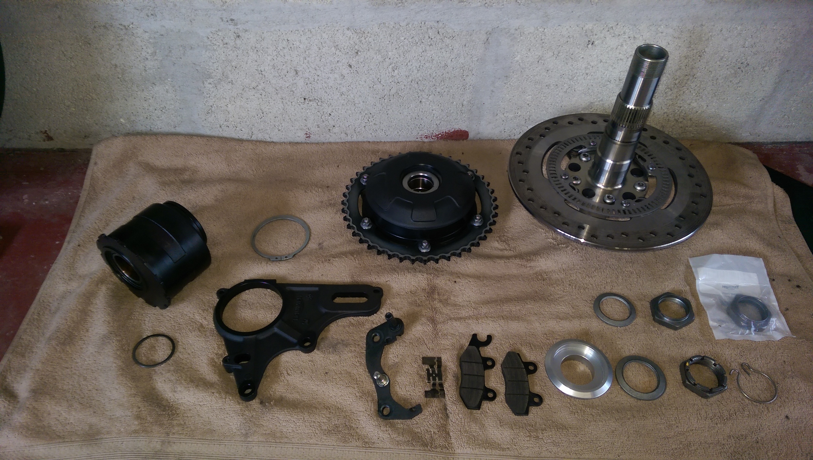

    just make sure the bike is securely jacked ( a center stand helps here) and be sure to torque everything up properly. Pictures show th bearing carrier on removal,the freshly greased bearing and th suspension pivot pin together with the axle.
