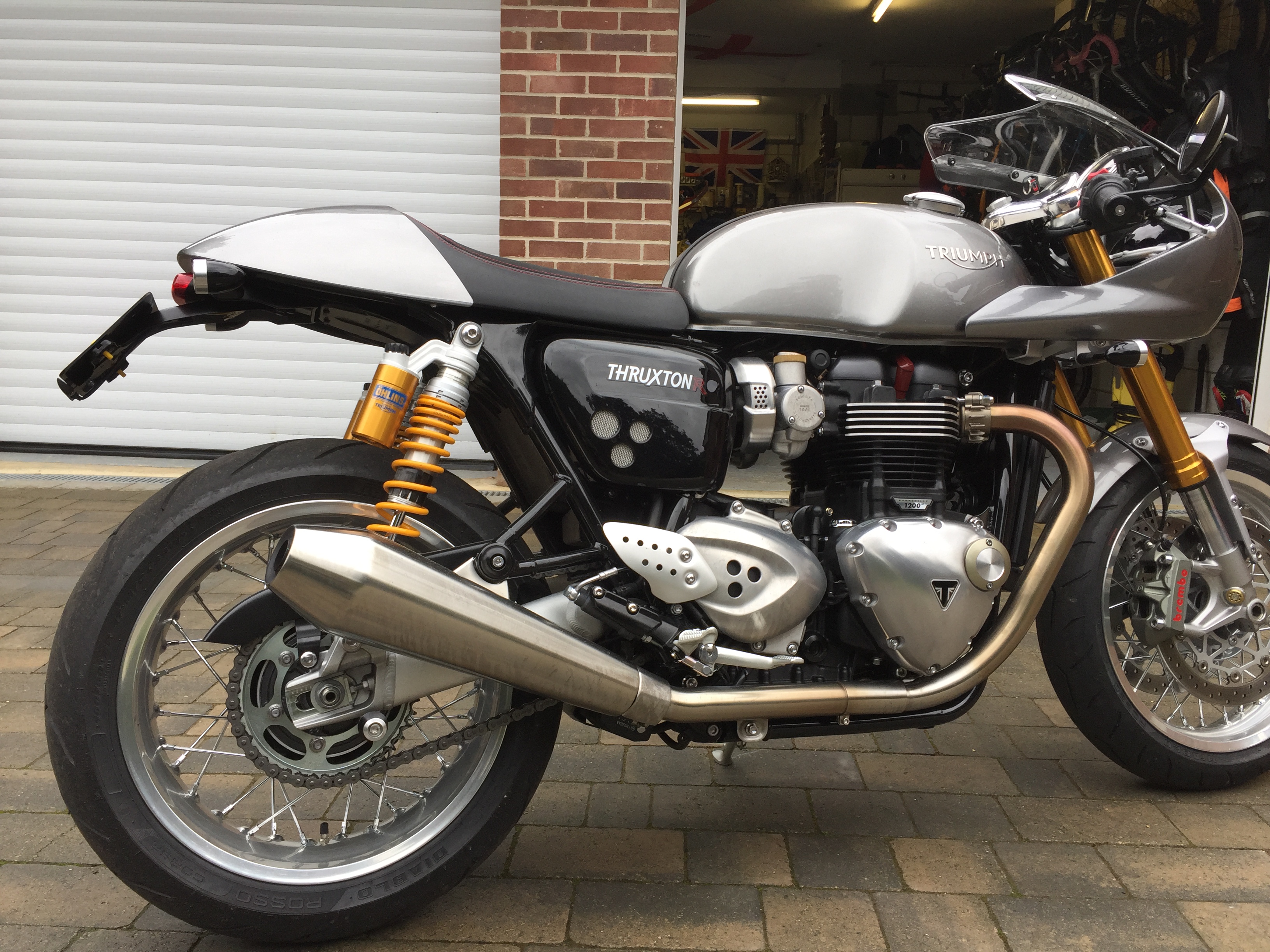

    Had a night to myself so I fitted the led indicators and tail tidy to my Thruxton. My initial thoughts were how well the tail tidy was made, quite a few components which were all good quality and went together easily.
    I fitted the front led indicators first the only surprise was how much wiring is tucked into the headlight and that the wire to the running light is very thin.
    The original mudguard, which is plastic, came off and the new assembly again fitted easily. My only slight bit of trial and error was with routing the wiring harness around the ECU as I didn't look well enough on removal.
    You then have to select the indicator type within the settings on the left hand screen, no messing with resistors, which I thought was cool.
    All in all a couple of thoroughly enjoyable hours well spent :cool:

    Tail light and indicators a great improvement on originals but does the number plate holder need to be so long? Just out of interest, The tail light doesn't bolt on to original mudguard does it?
  3. Giles
    Giles Well-Known Member
    Jun 8, 2016
    80
    Surrey
    I did think about reducing the length, it's not an easy thing to do as It would involve cutting, drilling and possibly bending to get all the items to fit. The easiest option would be to remove the centre bit completely and reattach the number plate.
    this may be done at a later date but I like the low profile look and configured like this will stilll be effective as a mudguard.
    the old mudguard is removed completely as is the light and wiring.

    Can you not just not put the extension bracket in? Looking at the Triumph images on the web theres pics of display bikes with the plate tucked up a lot closer to the seat hump.

  7. Giles
    Jun 8, 2016
    80
    Surrey
    so, with just a little filing and a bit of touch up paint you can make it look like this ;)

    Oh yes, far better looking. How did you do it, slash and cut?
  9. Giles
    Jun 8, 2016
    80
    Surrey
    not even that drastic. The centre section has the same bolt holes so it can be removed but then the rear section needs a notch cut into it so it fits properly. Half an hour all up. Think I may re-fir centre piece over the winter as it will provide much better protection.

    That has cleaned it up nicely.

    That's better!
