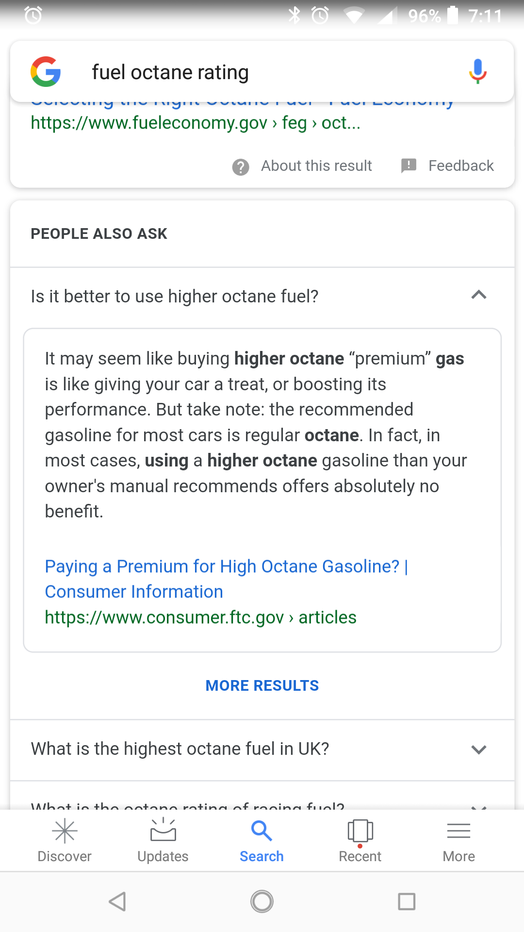

    Does that say car in the Google search or are my eyes deceiving me.:joy:
    We're talking about motorbikes Mr o. :p
