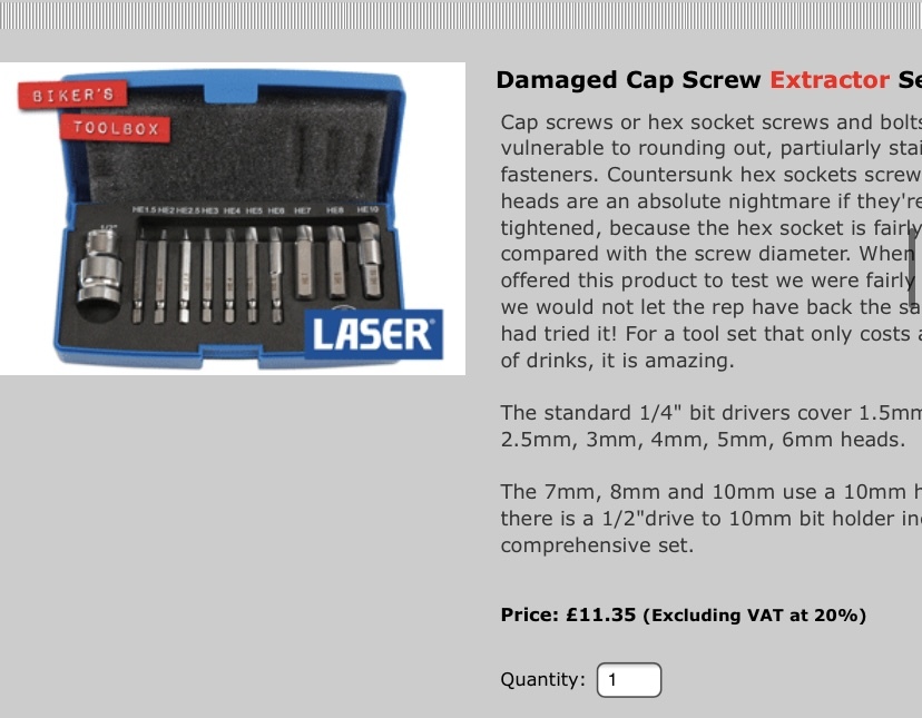

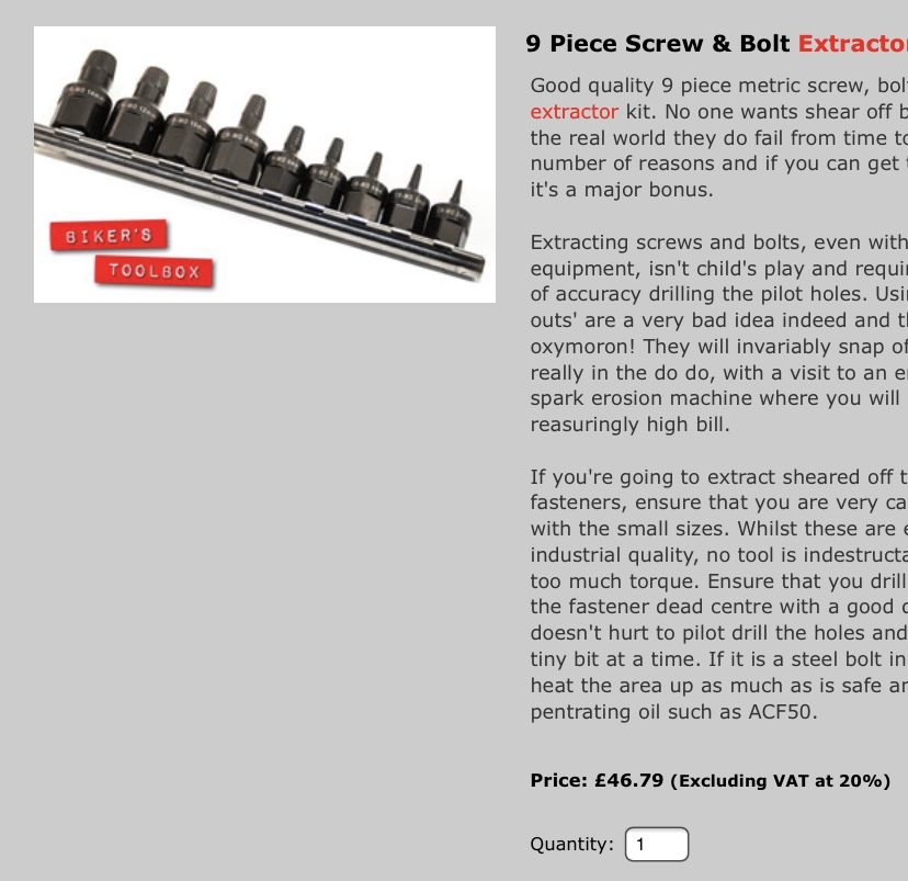

    When I was talking about the extractor not being up to it I was referencing the sets I’d asked about earlier...ones a little like these screw fix extractors.
    I’ve been looking on bikerstoolbox (a great resource, thank-you) but can only find the two other images below...are these the mortorq tools you refer to?
    Thanks again for all your help to-date.

    Hi StuarT595, the bolt extractor picture is the one, however as mentioned the tool I would use are the ones made to go over the stud, they look like a socket, however they have angular cutting edges that grip the bolt tightly allowing removal, I use an air impact wrench in tight spaces if the bolt is really tight, this tends to give it initial "shock" then remove with a ratchet or T Bar. If you look on on the 24mx website you will also see a set of high quality removal tools, you won't break these in a hurry, the company are based in Poland, don't let that put you off, I ordered some special tools for my sons Ducati Panigale 1299s 2 weeks ago for a job I was doing for him, they arrived free postage in 5 days. Blue Spot tools do a set of removal tools, I have bought similar items from Machine Mart, however I personally would never consider using budget tools, I find they are just not up to the job so to speak. I hope this helps
