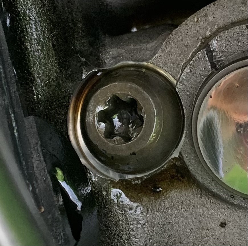

    I think you’re right, pegscraper, the torque is going to be too much for them. The Torx bit literally exploded under the pressure...all but 2 of the splines shattered off of it.

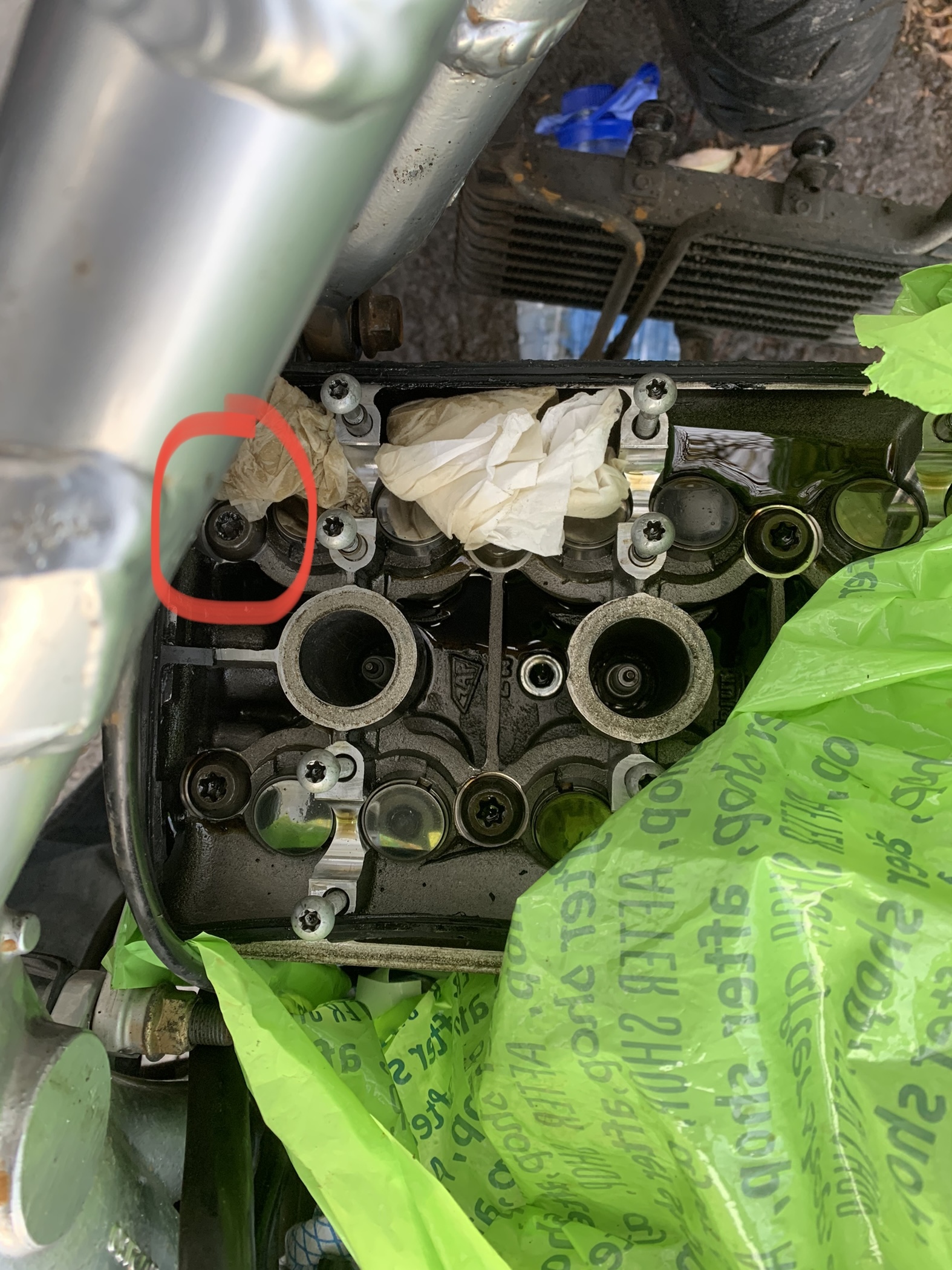

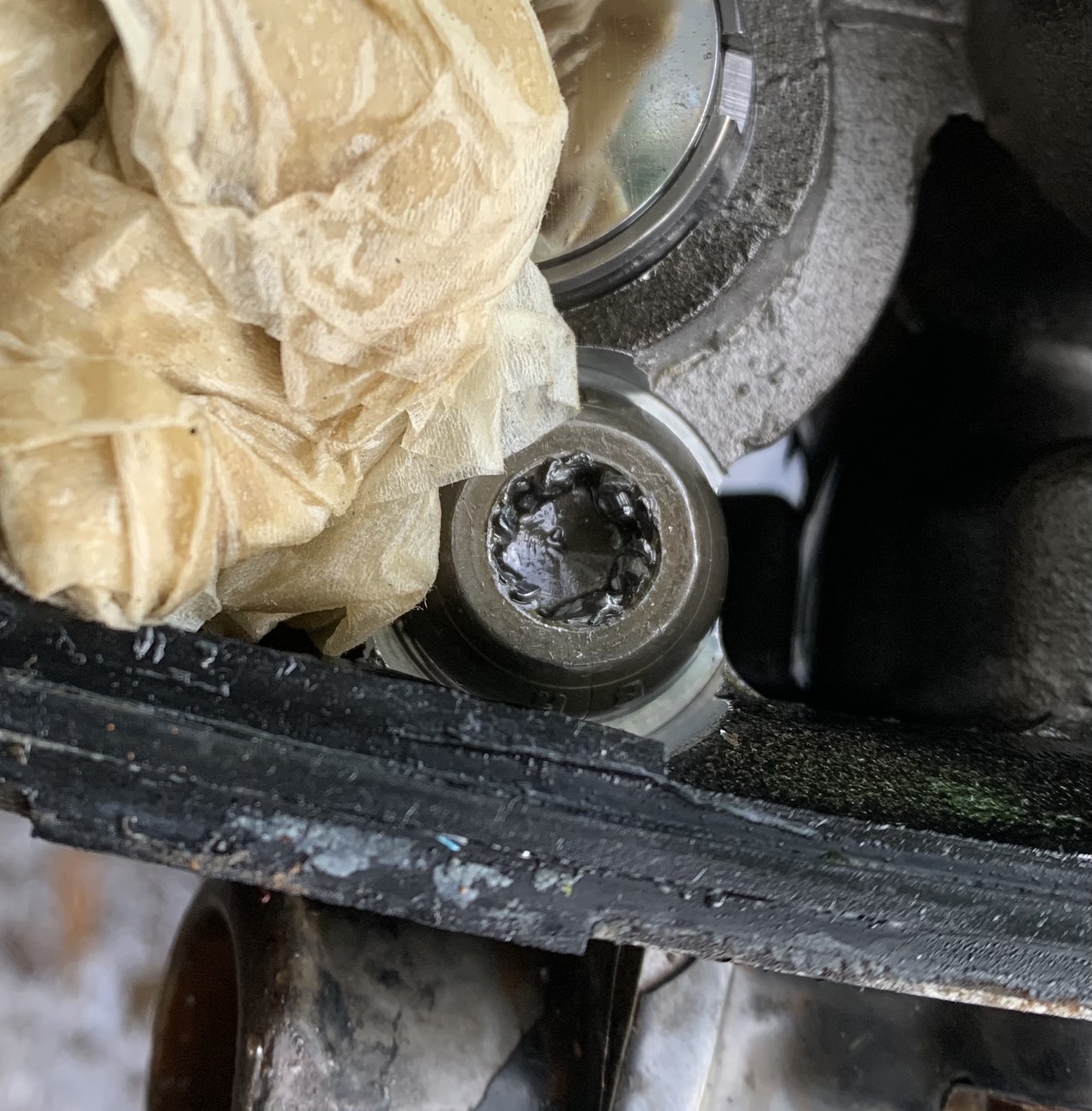

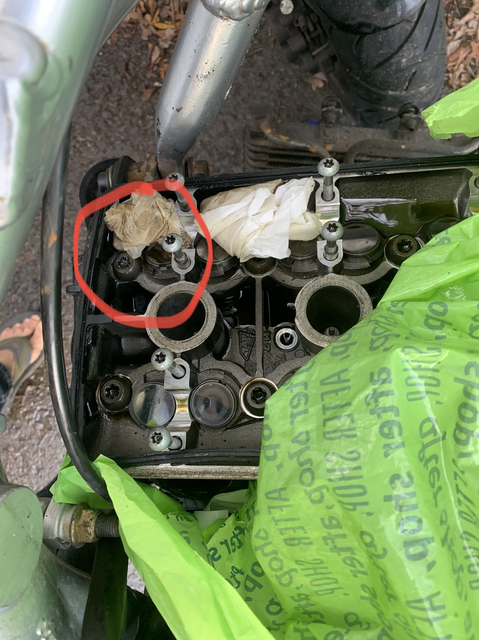

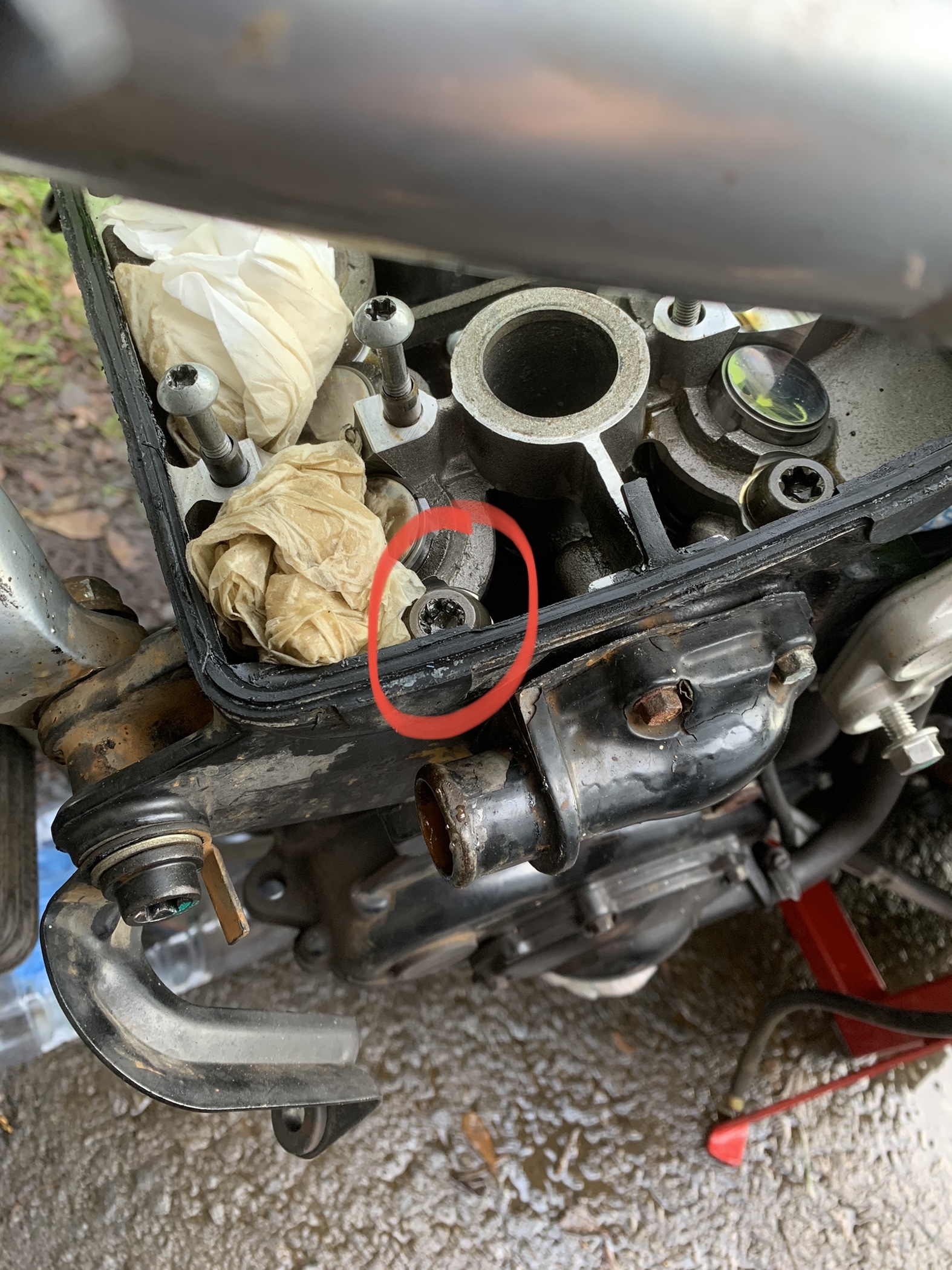

    @tcbandituk
    Here’s what I’m facing. A close up of the disaster and 3 shots from different angles to show access without taking the engine out.
  17. StuarT595
    StuarT595 Active Member
    Nov 19, 2020
    204
    South West UK
    As you can see, they’ve all been ‘got at’ before. Anyone know whether the head bolts would be Torx Plus? Can you tell from simply looking? The Torx bit I used felt a little sloppy in the bolt head, but that could be that they’re knackered?
    Torx Plus are slightly chunkier if I’m not mistaken?

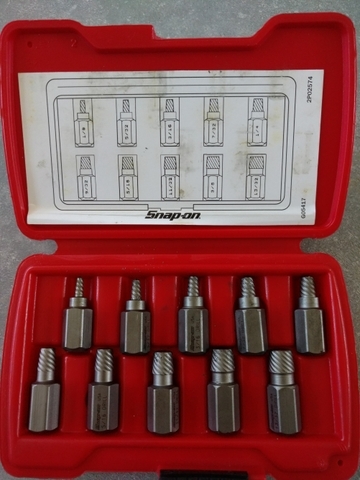

  18. Don the Don
    2,949
    A lot of head bolts today are designed to stretch when used so it is good practice to replace them as well, I have had success with two types of extractors: short type and Hurlinger type not the usual run of the mill types, but if you do not won't to purchase these maybe a Hex key socket would fit into the Torx head I have also had good results that way.
  19. StuarT595
    Nov 19, 2020
    204
    South West UK
    Wow, that snap on set looks robust enough to do the job. Nothing to lose by trying a hex either I guess. Thanks for sharing that!
