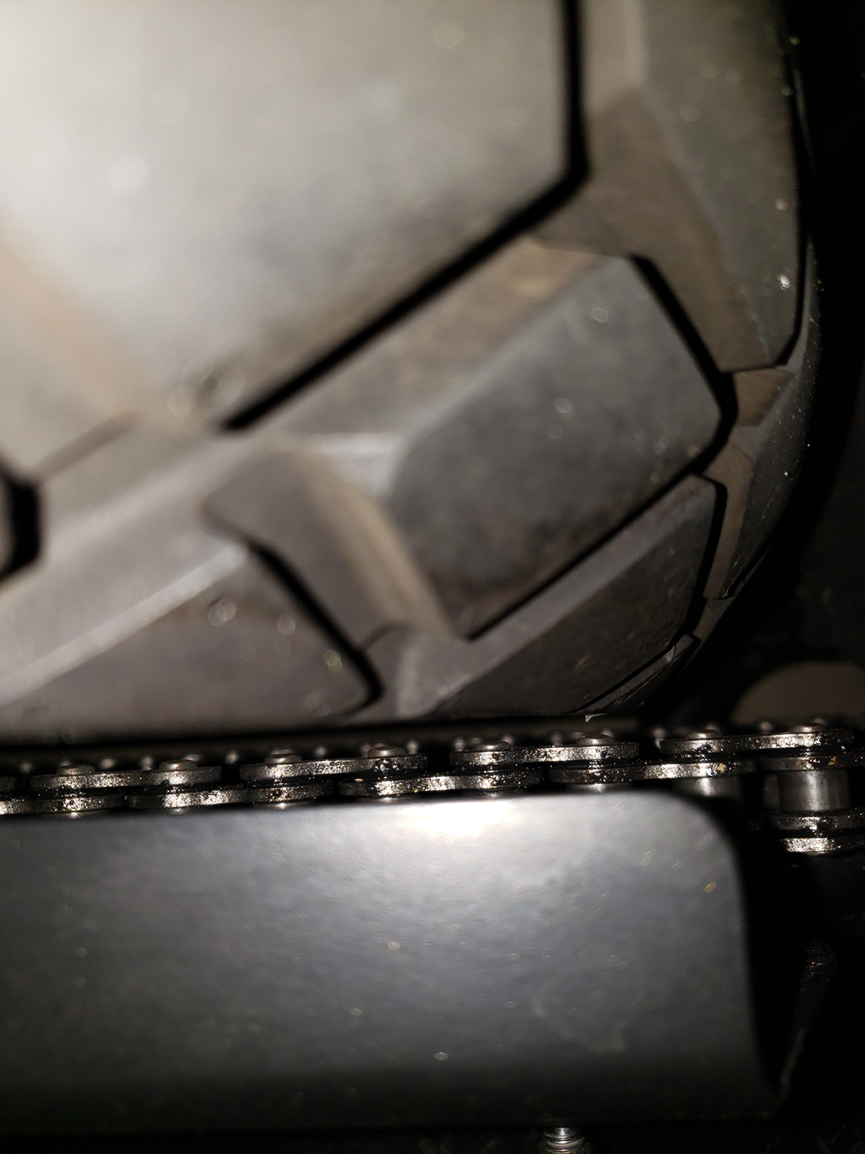

    The service advisor pointed it out at my last service. She didn't indicate that it was a "problem" but said I needed to watch it in case the chain loosens a bit. I've tried Googling it and haven't found anything, so now I'm asking the crew! Is this normal? No adjustments have been made to the bike and it is all stock. It has about 1/4 inch between chain and tire...about 6mm for my UK friends. Thank you all

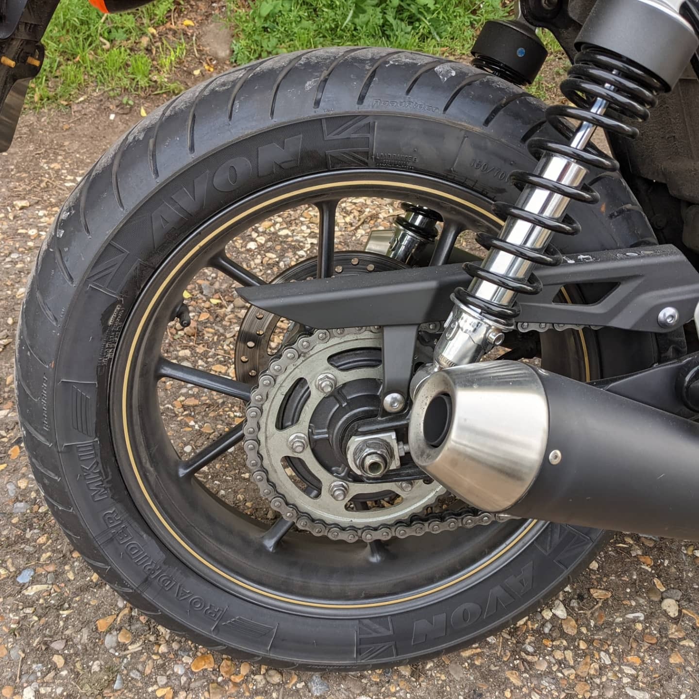

    6mm doesn’t sound right! Have you got oversized tyres perhaps?
    I can’t check mine until late December (Covid permitting) but here’s the closest photo I have of the chain/tyre.

    so they tire is Continental TKC70 Dual Sport Rear Motorcycle Tire 150/70R-17 (69V) and I just took a couple pics

    Photo attached of the chain run on my 2019 Street Twin yes the chain does run close to the tyre, there isn't any spacer between the sprocket and wheel, that is taken up with the cush drive. The spacer is between the sprocket and swinging arm so would not have any effect on the tyre/chain distance.
    I suspect that the only reason is the tyre itself and the nature of the tread 2021-12-20 16.01.08.jpg 2021-12-20 16.01.08.jpg
