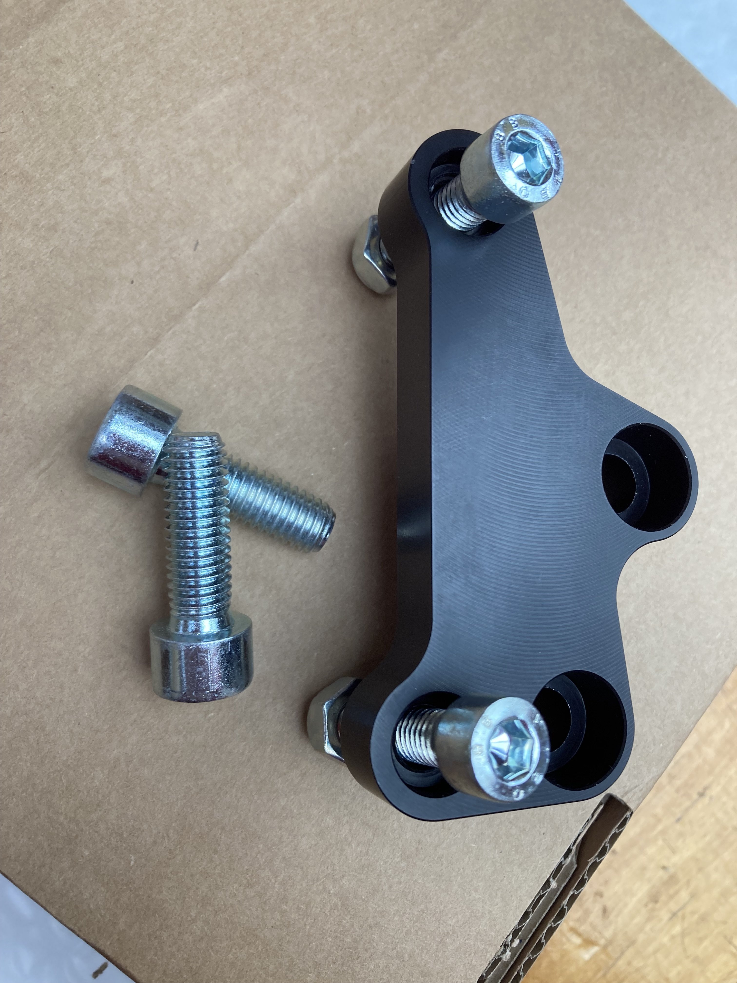

    Hopefully when the bits arrive and I've fitted the Brembo 4-pot + floating disc I will be able to confirm the improvement in braking.

    Free Spirits adapter bracket has arrived.

    I'm offering a pretty straightforward brake upgrade for the 1st generation Street Twin, with the 2-pot caliper. It consists of a Brembo 4-pot caliper and adapter bracket supplied by Freespirits. It IS compatible with the original master cylinder (says so in their blurb). If you google their website you will see how expensive these are.
    I'm asking £95 plus p&p (well below half price). You'll find a pic and more info in the 'for sale' section.
