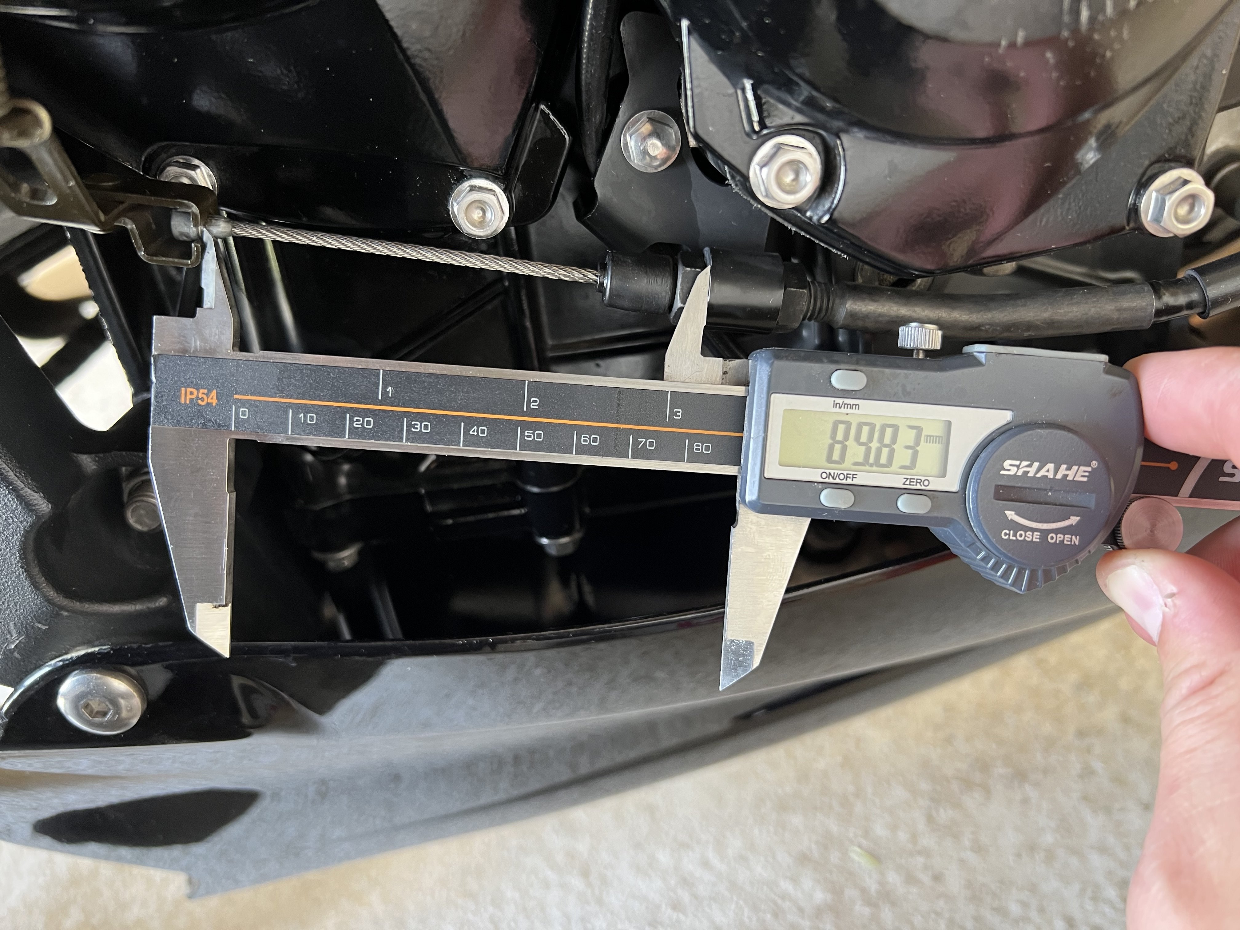

    Hello,
    I bought a bike with a worn out clutch, ive replaced all plates and also bought a used basket/inner/outer in better condition.
    While testriding: The clutch is not engaging properly when activated, Only way to get proper clutchactivation is by adjusting the cable slack to zero. ( I could not switch gear when i adjusted with correct slack, and the bike was going forward while 1st gear and 100% clutch )
    I wonder if this clutchlever is compatible with my bike, or if the travel is too short? (considering clutch not working with 2-3mm slack).
    I also posted a picture of a measurement i would like to know from one of your bikes, i would like to know the measurement with clutch in and out. The measurement im showing is when i have no slack.

    the new clutch had to be worn-in. No problem now
