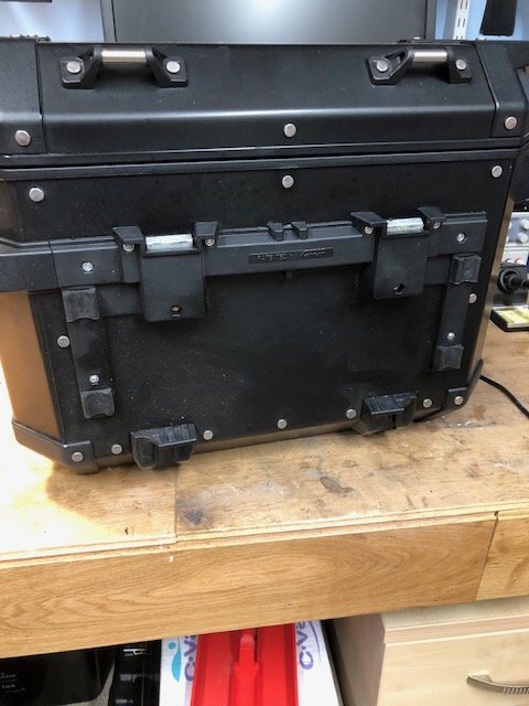

    If You're talking about fitting the aluminium expedition panniers supplied by Triumph for the Tiger 800s 1200s and 900s they use completely different mounting systems to the panniers for the Bonneville Street and T100/120 twins.
    I'm pretty sure that Triumph's Expedition Panniers are made by Givi, so your best chance of finding a mounting bracket for the Street Scrambler will be on the Givi website if such a thing exists.

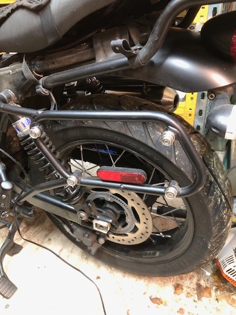

    If Givi don't make a mounting system then modifying a set of Givi brackets is going to be the way forward I wouldn't begin to know where to start with that. The other thing to bear in mind is that Triumph's rugged and leather pannier options for the Street Scrambler only have a LHS option because of the high exhaust on the RHS.

    Looks like there isn't an off the shelf solution so i'm going to have to bodge modify what i've got.
    I have a Rugged soft pannier mount on the bike and an expedition pannier that I want to fit (see pics).
    The soft bag mount is suprisingly sturdy and will serve so long as i'm not offroading with a fully laden pannier.
    Looks as though the expedition release system will unbolt from the pannier.
