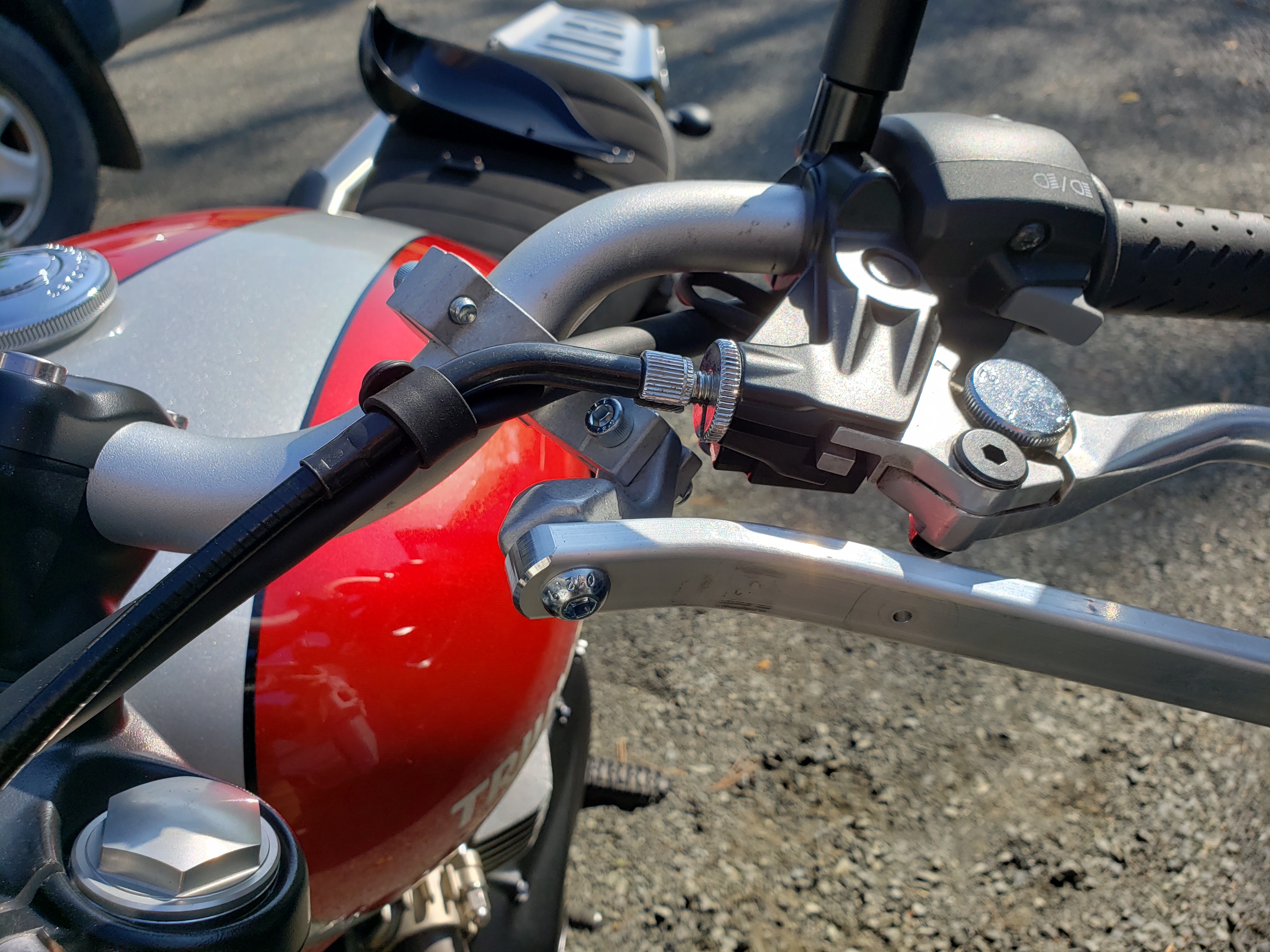

    Garethr, thanks for this info! Following this I mounted some Barkbusters Storm handguards today on my 2017 Street Scrambler. I love the look and the install went smoothly.
    Just wanted to note for others' sake that I did have to loosen up the control mounts for the clutch and brake levers just to move them out of the way to be able to tighten the middle bolts on the inner handguard mounts properly.
    About to try them out on a ride and head to the hardware store to pickup those M6x25mm bolts.
    Here's a few pics of the results and mounting arrangements on either side.

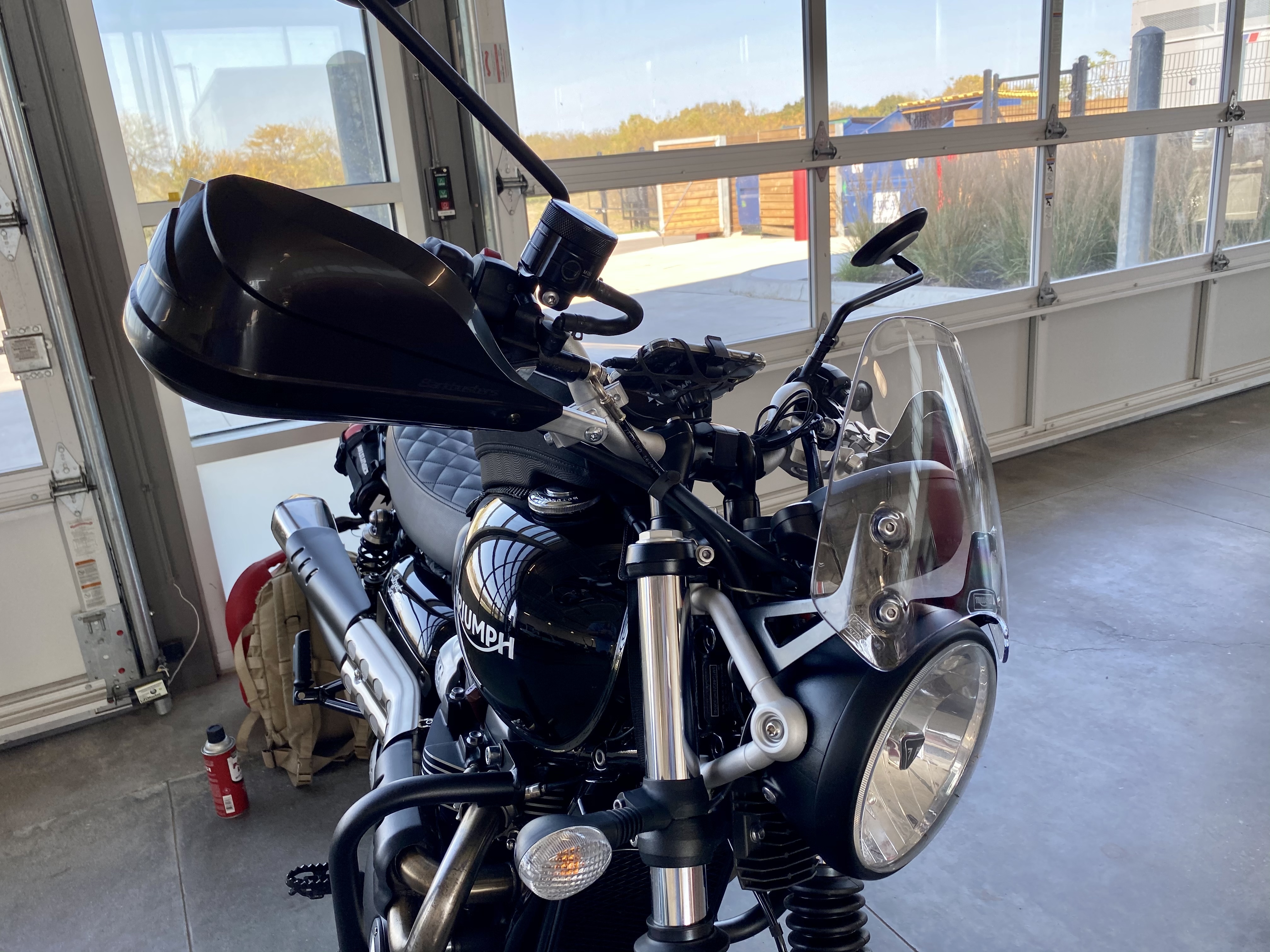

    I fitted these onto my Street Scrambler 900. They are for the Triumph Tiger 900 Rally. The fitting points are the bar ends and from the wing mirror fitting point.

  15. Daveweld
    Daveweld Active Member
    Aug 2, 2020
    141
    Hello PinkBritFit. I bought mine from the Triumph main dealer. Just asked for the parts that are on the Tiger Rally 900 (Not the Pro as these are different). Easy to fit. You have to do two modifications. The first will be to unscrew the bar end caps on the handle bar ends and drill out the hole to a larger diameter.So it can fit over the threaded end cap that are already there. Then put the bar end cap back on. You now have a flat surface fit for the guard to be screwed up against. The second modification is on the right hand side. You have your front brake cup mounted on a bracket also from the Mirror point. You will need to trim off part of the new guard arm plastic edge to make it flat. This allows you to leave everything as it is and bolt it up under the mirror bolt. This will take you to do both small modifications no more than 15-20 minutes as you put them onto the Scrambler. Any issues please ask. Dave
