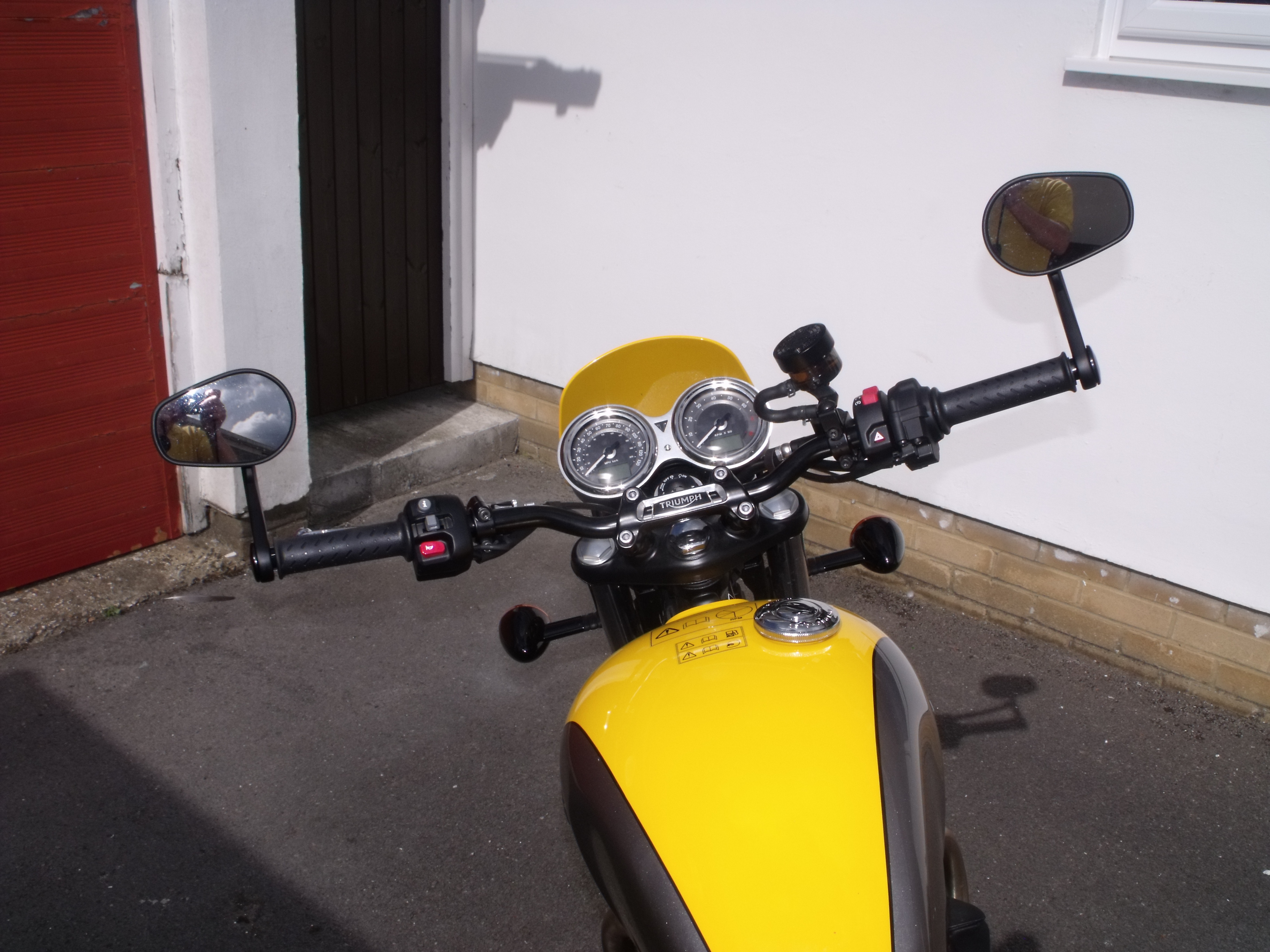

  1. Neil Lambton
    Neil Lambton Member
    Jul 10, 2018
    33
    Dorset
    Here`s mine, and all standard Triumph parts.
  2. Neil Lambton
    Neil Lambton Member
    Jul 10, 2018
    33
    Dorset
    I forgot to add, the Street Cup has a 1"fat bar centre, with standard 7/8" handle bars, so the Street Twin bars WILL fit, but you will have to use the Street Twin risers and top clamp. I believe one of the Speedtriple`s had one piece bars, but with the same fatbar middle, and the grip / lever ends being standard 7/8", so these may be a better option.

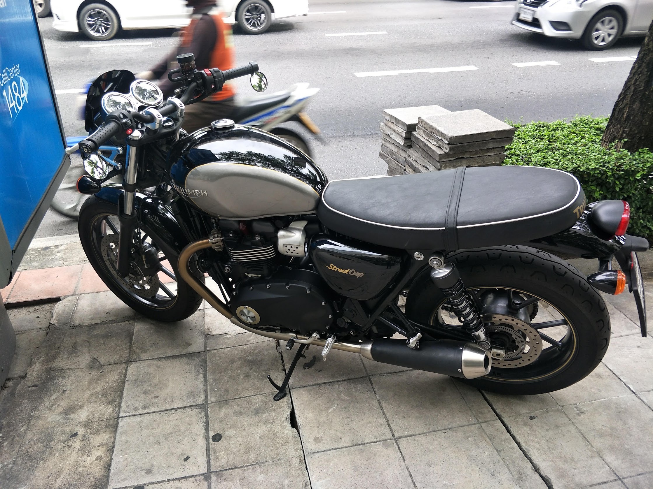

  4. MaT s
    MaT s New Member
    Jul 5, 2018
    12
    Bangkok
    Hey, this is my Street cup at the mo, raised handlebars, changed mirrors, and changed seat. The seat I actually got cheap from the dealer, second hand, good enough for now. I actually changed the seat caus i'm regularly taking a pillion passenger, the original seat could take a passenger, with the cowel taken off, but a bit awkward. TBH this current seat is a bit of a fill in until I get something a little more stylish. One thing about this seat, it that it has raised the height a bit, which I really like. I'm just under 6 foot, and it's a good fit now. In terms of handle bar change, I found raising the bars made the bike so much easier to ride, centre of gravity and all that I guess.
  5. Dobbo
    Dobbo Member
    Sep 11, 2018
    82
    Cornwall UK
    Looks really really good I must say. So you used the street twin bars also? Interesting that the seat height changed a bit too. Thanks for the info.
  6. MaT s
    MaT s New Member
    Jul 5, 2018
    12
    Bangkok
    The bar comes from another Triumph, cant remember which model. I basically just worked with the dealer to try some things out, but got it second hand, very cheap. They had to drill a couple of holes for the gear, but very easy, nothing big. I changed the mirrors as `i found the stock mirrors looked really big after the bars were raised, these were just third party, nothing too pricey. This seat is amazingly comfortable, bit higher and wider, my GF loves sitting on the back now! I'm looking into changing the seat again soon, just for aesthetic purposes. Currently looking into luggage options, paniers or smth similar if you guys have any recommendations. One of the best things about owning a bike like this is being able to toy with it :) On the whole I have been nothing but impressed with the actual bike, beautiful ride.

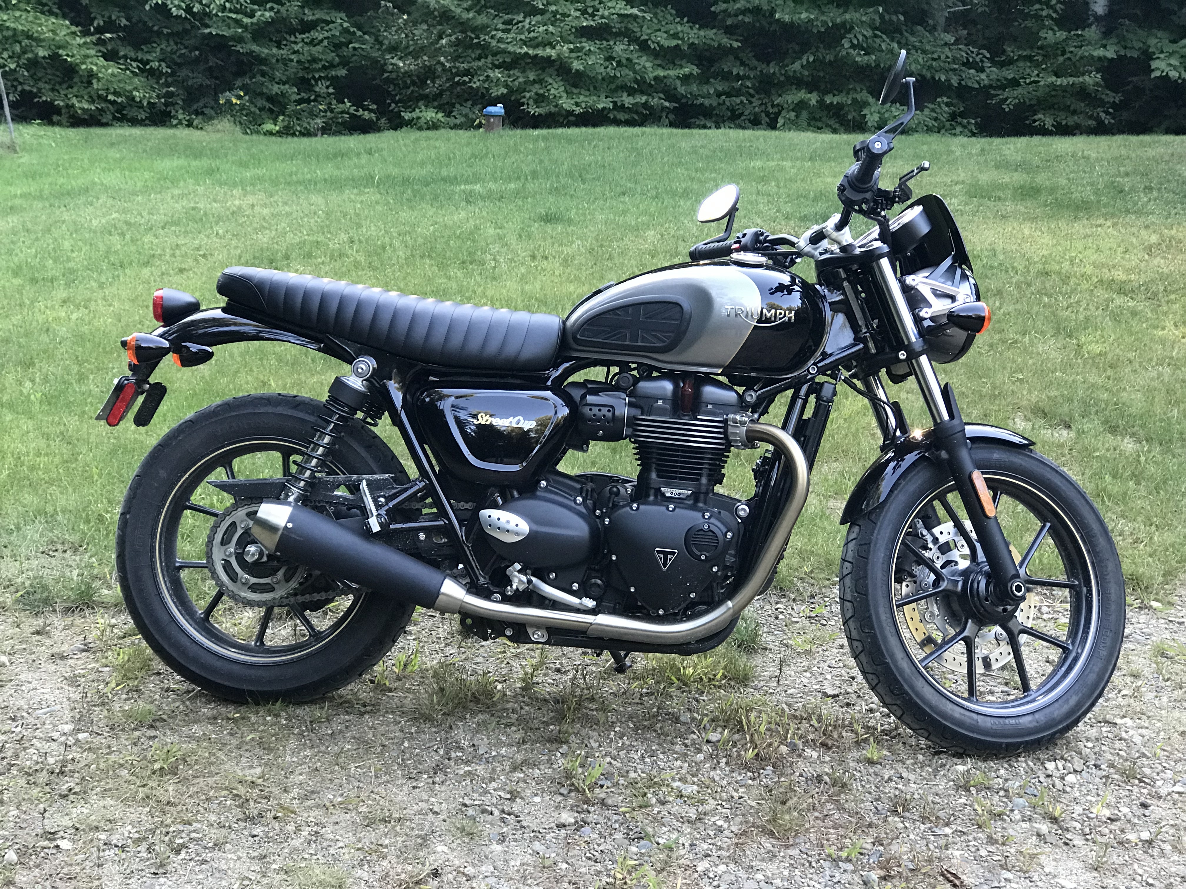

  9. Celticages
    Celticages Well-Known Member
    Oct 9, 2017
    75
    New Hampshire, USA
    Already have installed the Street Twin bars and risers I bought off this forum. I also recently changed the seat to a British Customs Slammer seat with tuck and roll pattern. It raised the seat up about 2" which I absolutely love. I still like the looks of the Clubman bars and will put the stock seat and cowl on from time to time but these two changes were huge comfort upgrades for me.
  10. Celticages
    Oct 9, 2017
    75
    New Hampshire, USA
    The Street Cup sits higher than the Street Twin and IMO would be more comfortable over the long haul for you. My setup above with the British Customs Slammer seat is about 3" taller in the seat than a stock Street Twin. The seat to pegs is also longer on the Street Cup (about 1.5") and only increases with a seat like mine.

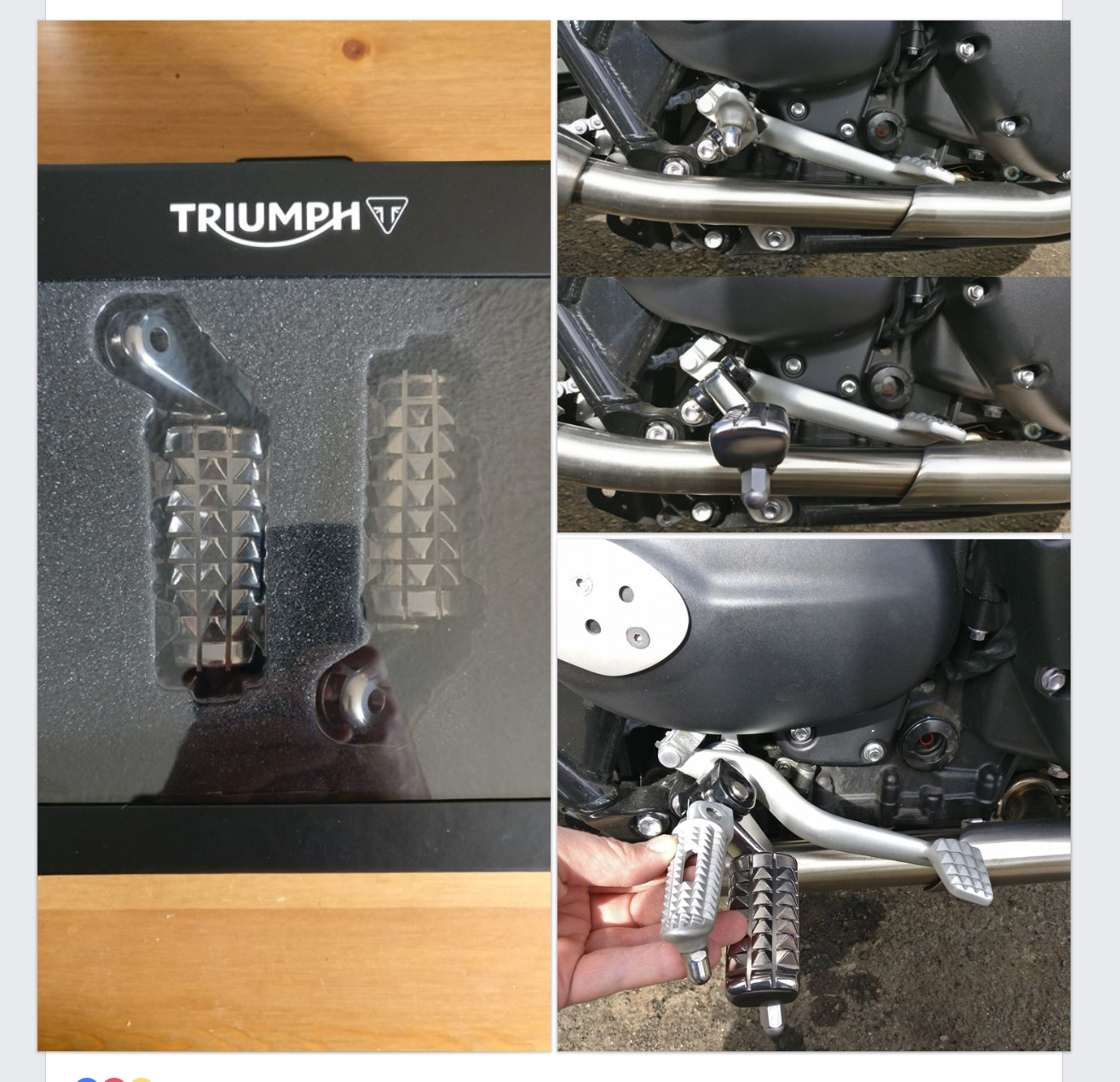

  12. Dobbo
    Dobbo Member
    Sep 11, 2018
    82
    Cornwall UK
    On the subject of increasing the seat to peg distance - I saw on a Triumph facebook group the other day that someone changed their Street Cup footpegs for those of a T120 and due to the design this effectively lowers the pegs an inch or more. More food for thought!
  13. Yorkshireman
    3,403
    Useful little mod that’s easily reversible come sale time, just wonder what the gear change side looks like as the peg is much closer to the brake pedal in the above pics. :confused:
  14. Dobbo
    Dobbo Member
    Sep 11, 2018
    82
    Cornwall UK
    Good point, it’s also moved forward as well as down.
