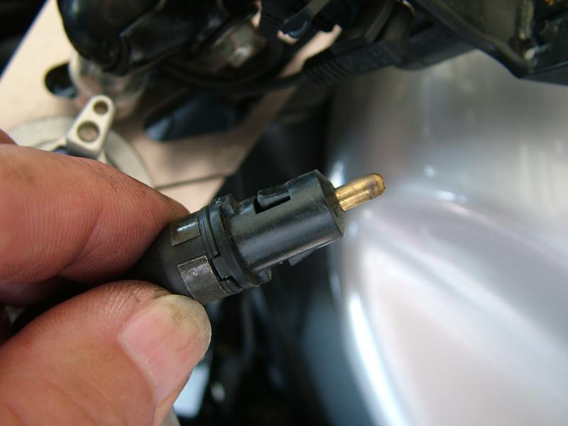

    That issue has nothing to do with clutch lever or switch - if the clocks appear to be resetting then it is a voltage issue - sagging when attempting to start due to either poor connection or discharged. This is a T100, yes? EFI model I presume given the clocks re-setting?
    If the battery terminals are good & tight, then, if you have a voltmeter, check the voltage between the terminals with the ignition (and therefor lights!) ON. That will tell you sate of charge of battery.
    (ignore image below - I thought initially that was the type of switch you have, most triumphs use - but it's not if that's an EFI T100 - I can't seem to delete it so please disregard)
