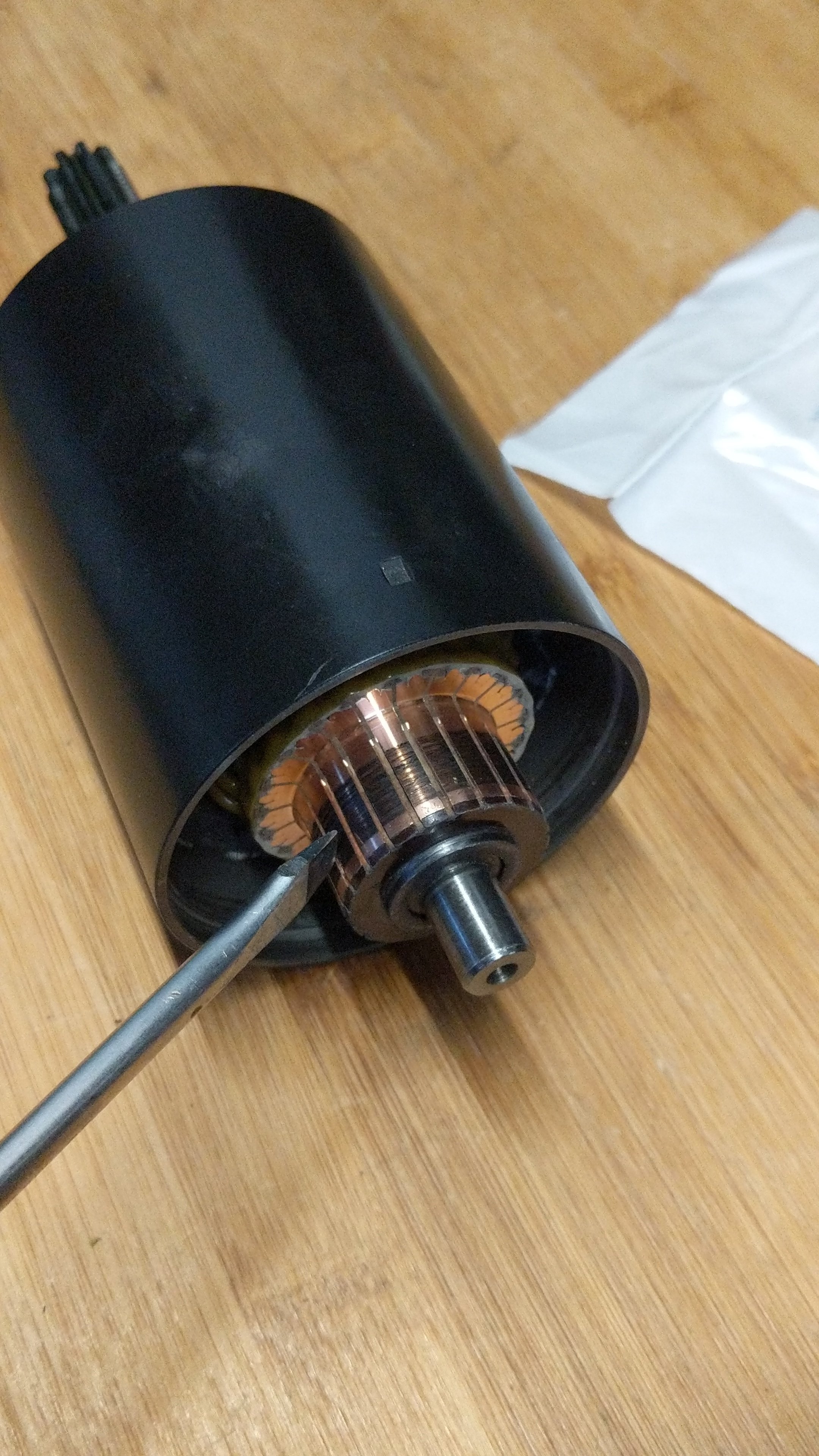

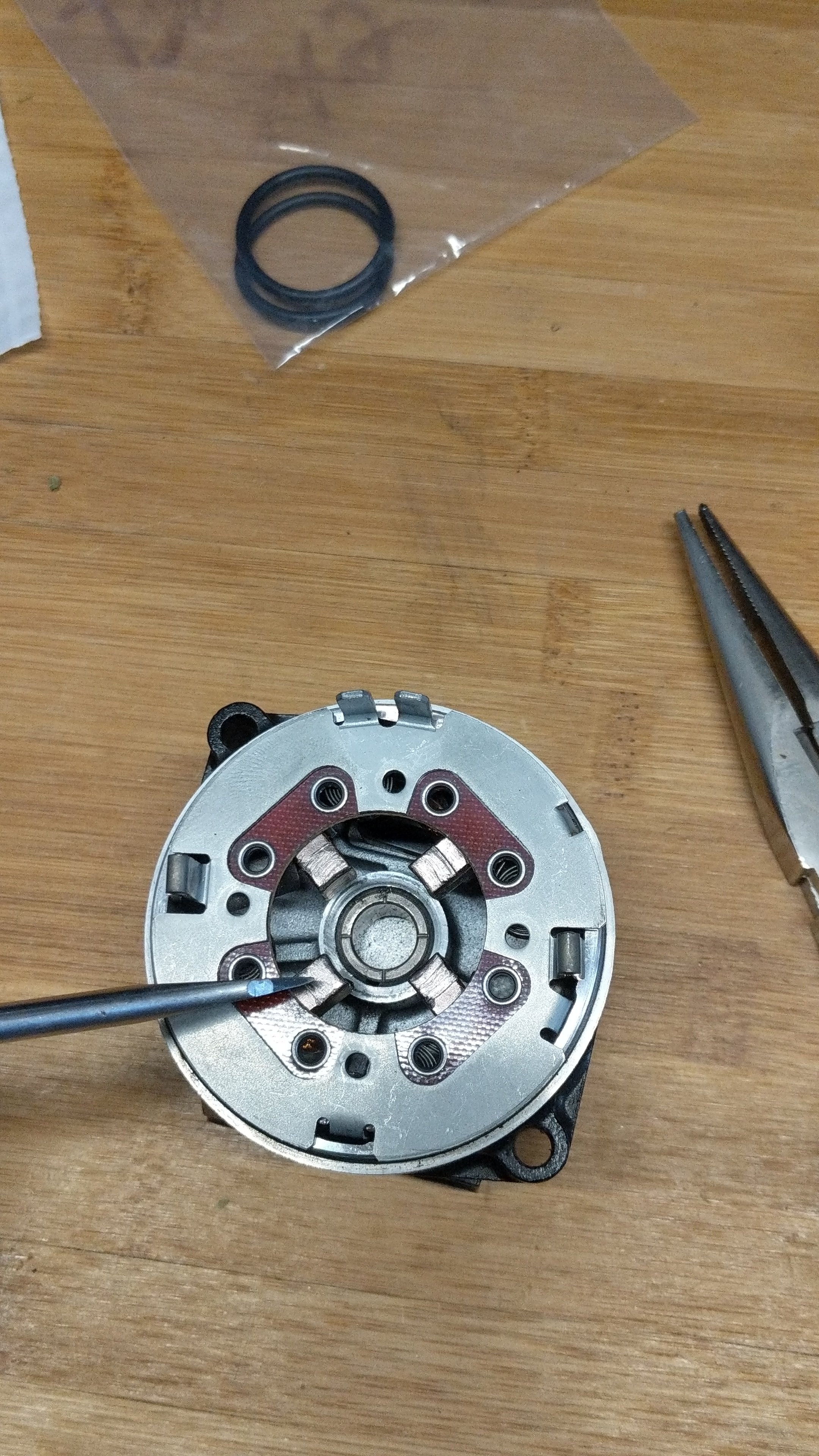

    Thank you Don, I have tried that as you suggested but no luck. I may have taken on something beyond my ability but the starter seemed very simple to remove.. not so easy to put back! I have inadvertently removed the cap of the starter motor and I think I am not putting it back on correctly. Am I correct in assuming these small retractable metal blocks must "hug" onto the brass colored part of the starter shaft? If so i am not sure how best to do that...
  4. Don the Don
    2,947
    those four items are the brushes they should fit over the commutator, the black area is where they have been in contact, so the answer to your question is yes, you can ease them over with a very small screwdriver taking care and easing the two parts together

    Don, thanks again. After spending more time then I would like to admit trying to get the brushes back onto the commutater, I found an even smaller screwdriver (one you would work on jewelry with) and finally got it back together.
