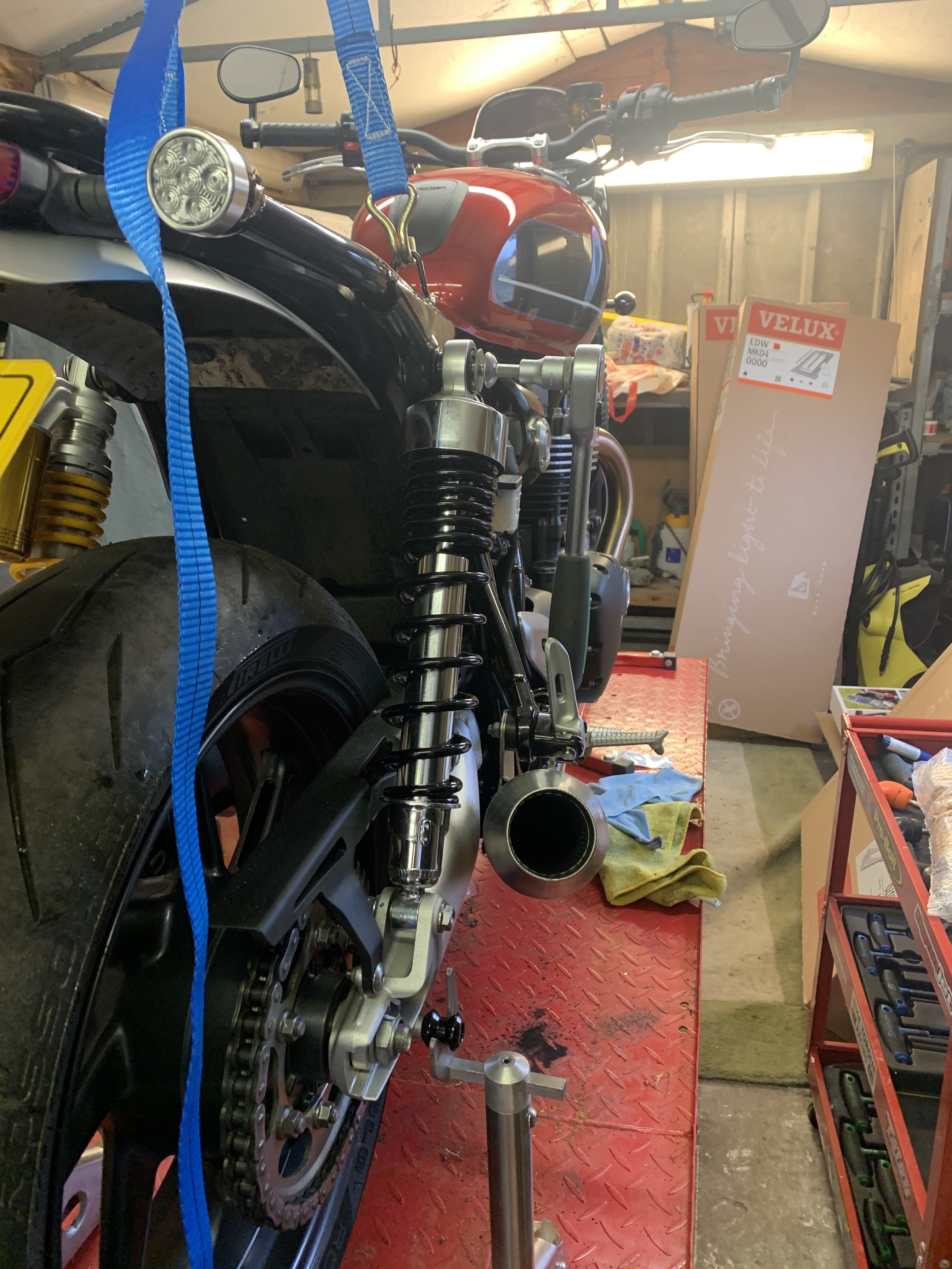

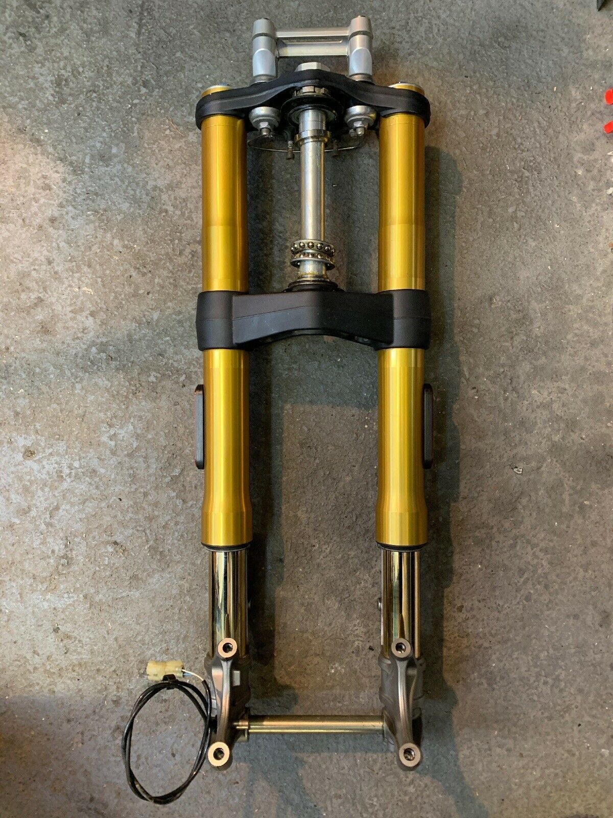

    Loose fitted the rear shocks till the fitting kit comes (Tapered washers). a front end set of 2016 speed triple Ohlin's, on the way as i am typing.

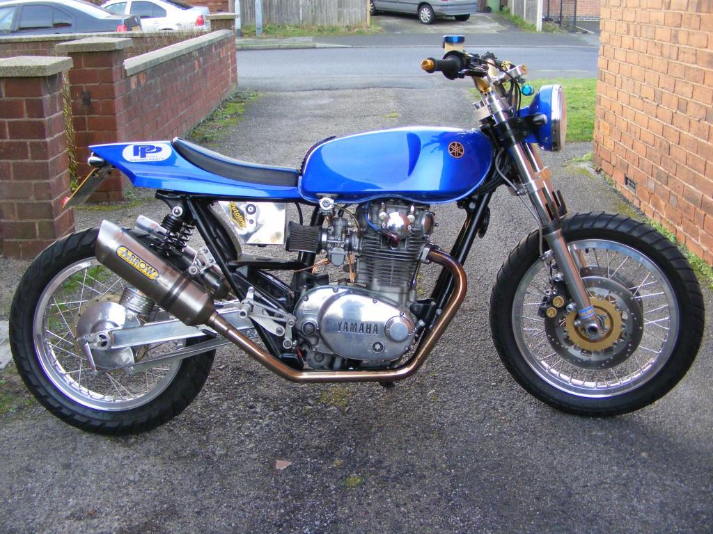

    I'm hoping that the ABS sensor is the same as the Speed Twin and just a straight swap, i have built specials before i have had to design and manufacture yokes and other components before, see attached the last yokes i had made
