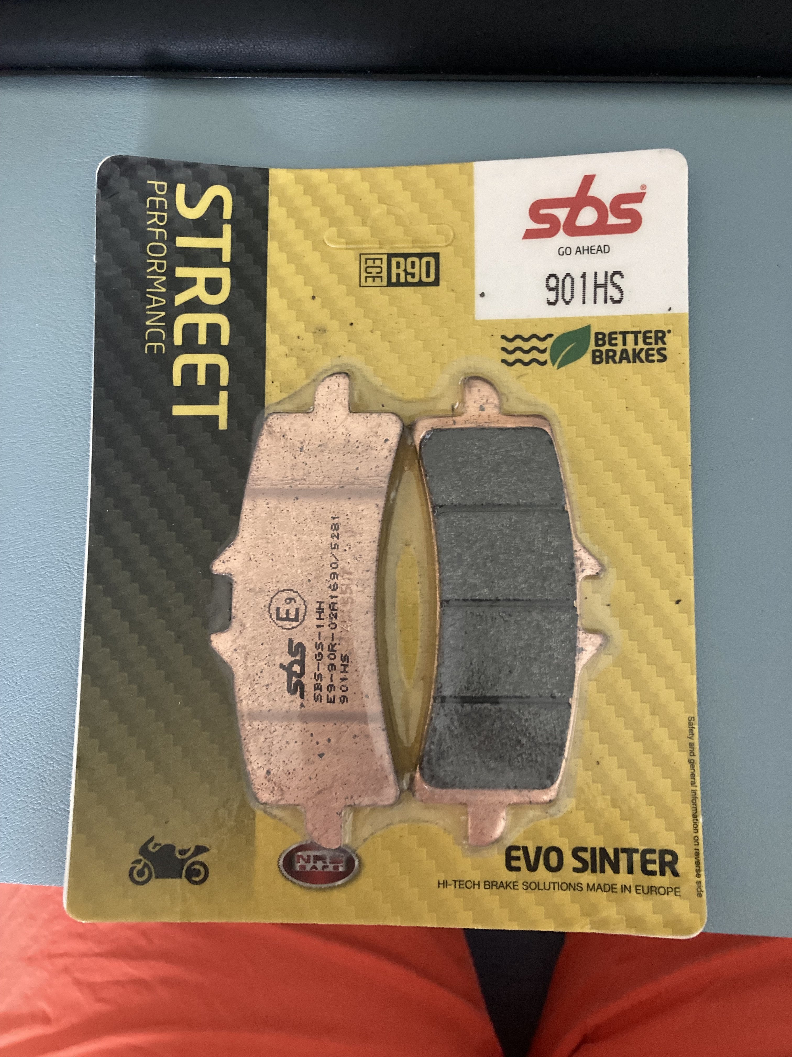

    I have had a weird experience.
    Whilst replacing my tyres I took the opportunity to strip down the brakes for a good clean.
    I cleaned them out no hassle. Bike went back to its usual wooden self.
    Last week I decided to upgrade the pads as I noticed one pad out of 4 was a lot more heavily worn.
    This time I worked on all pistons and discovered 2 must have been sticking ever so slightly. Sorted that.
    Upon completion took the bike for a spin, spongy as anything.
    I strapped up the brake lever for 24 hrs.
    There was a decent amount of improvement, still not enough.
    I then bled the master cylinder only. Hey presto the play is just perfect far better than I have ever had it.
    I fitted SBS pads which are owned by Brembo. For under £30 a side.
    Here is a pic of the pads. Now they are bedded in they feel much better than the original Brembo pads. I have attached an image of the pads.

    Just recently fitted the exact same brake pads to my Speed Triple.
