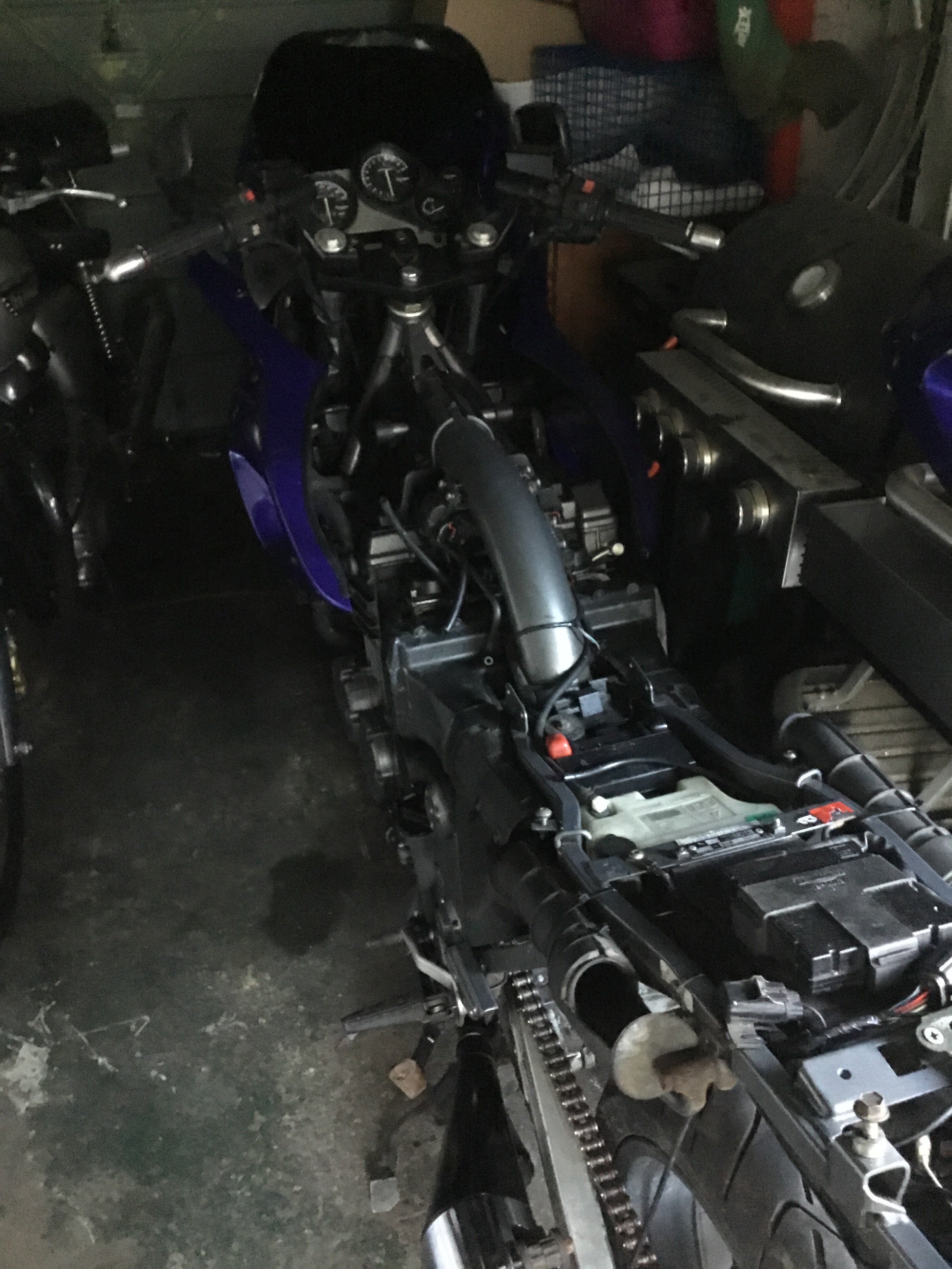

    Thanks for the replies,
    I made a start over the weekend and as you can see it’s all a bit rough in places.
    The fairing lowers have been taken off and if anyone wants them then just let me know.

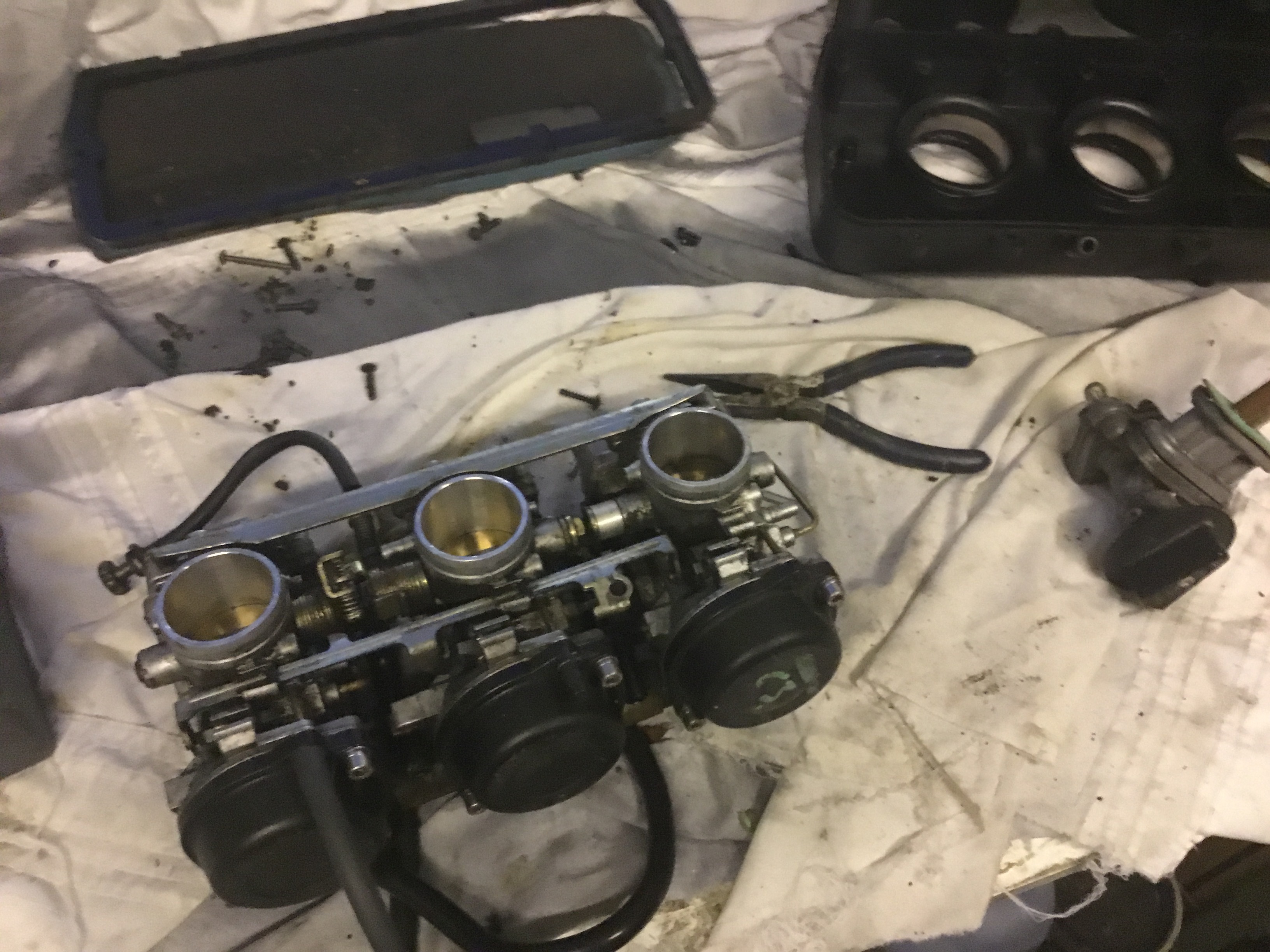

    Quick update.
    pulled the carbs and air box out today and it looks like the air filter hasn’t been changed at all!!
    Anyone had any experience of ditching the standard air ox and installing pod filters? I would presume that I would need to re-jet?
    ian
  9. Aidan
    Aidan Well-Known Member
    Dec 31, 2018
    185
    Many years ago, I put K&Ns on an RD250 and junked the air box. Performance was awful - the air box helps provide a reservoir of stable air. So, I would suggest to keep standard air-box, but use a high-flow (K&N type) air filter. Worked great on my old Aprilia Falco.

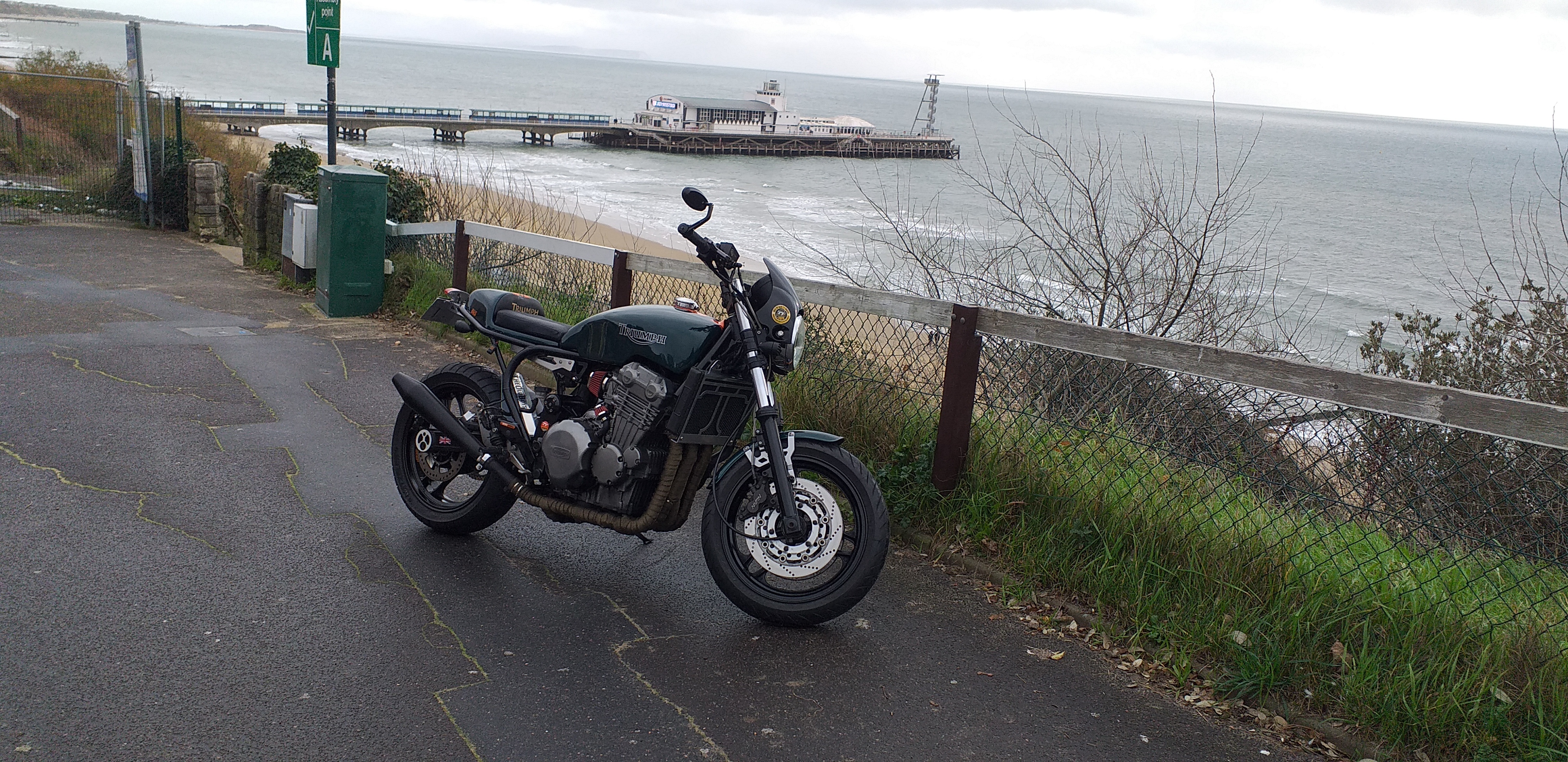

    I have no problems with my pod, filters,150 jets View attachment 117904

    If the OEM standard airbox is OK then I'd advise going down the K&N filter route - they're available from SPRINT Mfg.
    https://www.triumphparts.co.uk/product/trident-trophy-sprint-daytona-900-k-n-air-filter-element/
    or ebay
    https://www.ebay.co.uk/itm/KN-AIR-FILTER-TB-9091-FOR-TRIUMPH-SPRINT-900-1995-1998-/292766984815
    They can be cleaned and re-oiled. Trevor at Sprint can advise on whether or not any rejetting is required - likewise for pod filters.
    They used to advise using a thin bead of silicone when re-assembling and re-using the airbox as the factory always stated that the airbox was not meant to be disassembled but was replaced as a whole unit at the service interval. You're likely to find that, eventually, the 'self tapping' type screws that hold the airbox together will no longer form a decent air seal at the joint so it's probably worth having a spare airbox if you're going to be a long term owner. ;)
  14. Ian G
    Ian G Well-Known Member
    Feb 25, 2018
    14
    53
    Hull, East Yorkshire
    Cheers aidie,
    The air box is cracked at one side and has been bodged with silicone so I will have to source a spare air box and get the K&N filter. Just put in an order to Trevor at sprint for the fuel tap rebuild kit, intake rubbers and a few other bits so will give him a call in the morning and see what he thinks is the way forward.

    MID DEVON
    He usually has a few used airboxes so, with luck, he'll be able to sort you out! Hope it all gets sorted for you.
  16. stevethegoolie
    stevethegoolie Elite Member
    Oct 16, 2014
    2,458
    East Riding of Yorkshire
    K&N filter in a standard air box. Works for me, and has done so for many years. Air box is a right royal PITA to get off and replace, so K&N filter being (allegedly) a 'fit and forget' jobby makes perfect sense, especially as the air boxes are quite brittle/fragile.
