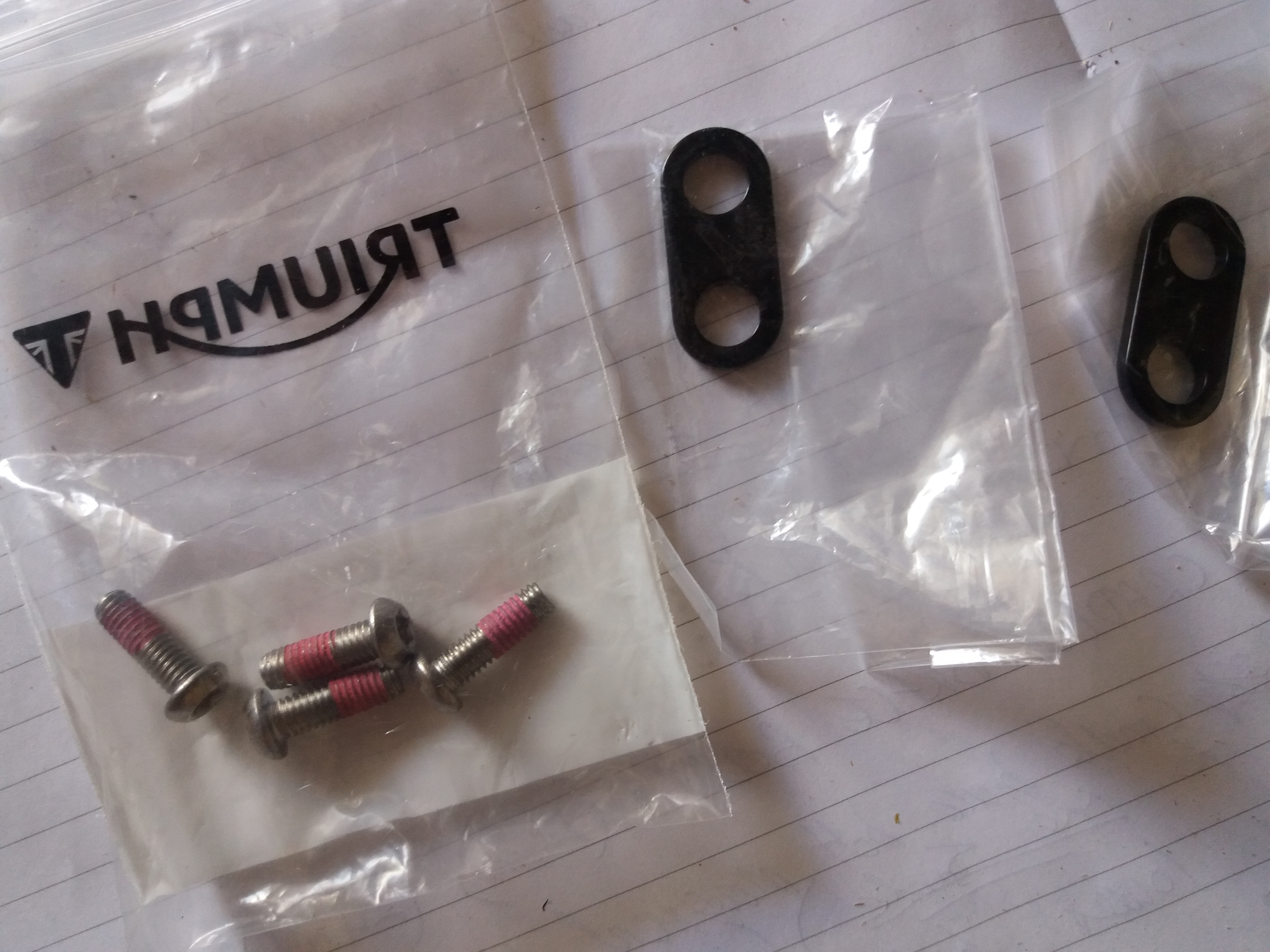

    Hi, getting a little bit flustered today. When I 'grabbed' my Speedmaster before they shut the doors it was in solo seat 'Maverick' mode.
    Today I am trying to work out how to put the pillion seat on and grab rails etc etc.
    All I have to go on is a Haines manual which is not offering up any enlightenment at the moment. I have a small bag with screws and spacers in it but no instructions.
    The grab bar support rail fits between the side support plate and the mud guard which is worrying as I don't want to scratch the mud guard.
    Anyone know where these bits go? Torques would be handy too ...thanks

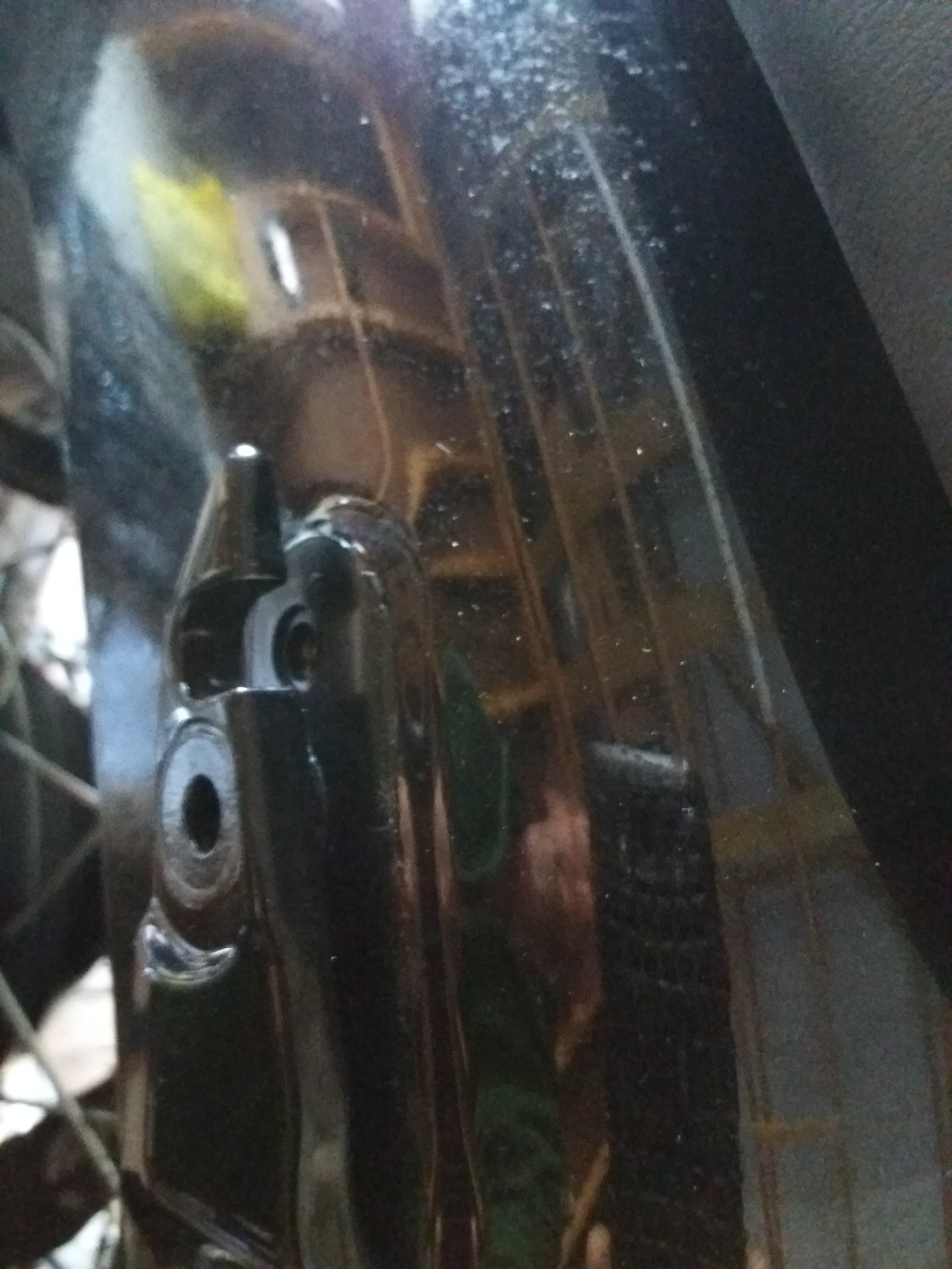

    The second photo shows some hex screws with flange bits on them, I take it 2 are for the pillion seat and 2 are for the back of the grab rail. 2 have longer threads than the others anyone know which ones for which and torques?

    Happy Easter mate, dont worry if your scoffing yer face with chocolate but its the top photo with the bits in the bags...any recollection where they went in relation to the inner sideplate the grab rail support bar and the mudguard..?

  10. dilligaf
    Ok this first picture I have no idea what these are for :confused:
    Not something I recognise at all :confused: 08AA728A-DF35-4197-90D4-AE4982DB534F.jpeg this second picture on the left is what you need to put the rail on :)
    On the rail in your picture the cover bolt goes through the forward holes on both sides :)
    Just put these on with your fingers for lining up :)
    Then nip up the rear ones with the spacers in :)
    Remove the forward bolt and put the finishing covers back on :)
    Job done :cool:
    Don’t know torque settings sorry :confused: 1CE91D3D-3F38-49FB-9076-02E8ABFD35C1.jpeg The two on the right are for the pillion seat at the back of the bike :)
    The seat has a mounting lug at the front which goes underneath the riders seat and is held on with a button head Allen bolt :)
    How many side finishers do you have?
    Because they are different depending on wether you have the rail fitted or not :confused:
    That’s why I had to mess around with spacers on my bike because I didn’t get the Triumph ones that you’re supposed to get when removing the rail :confused:

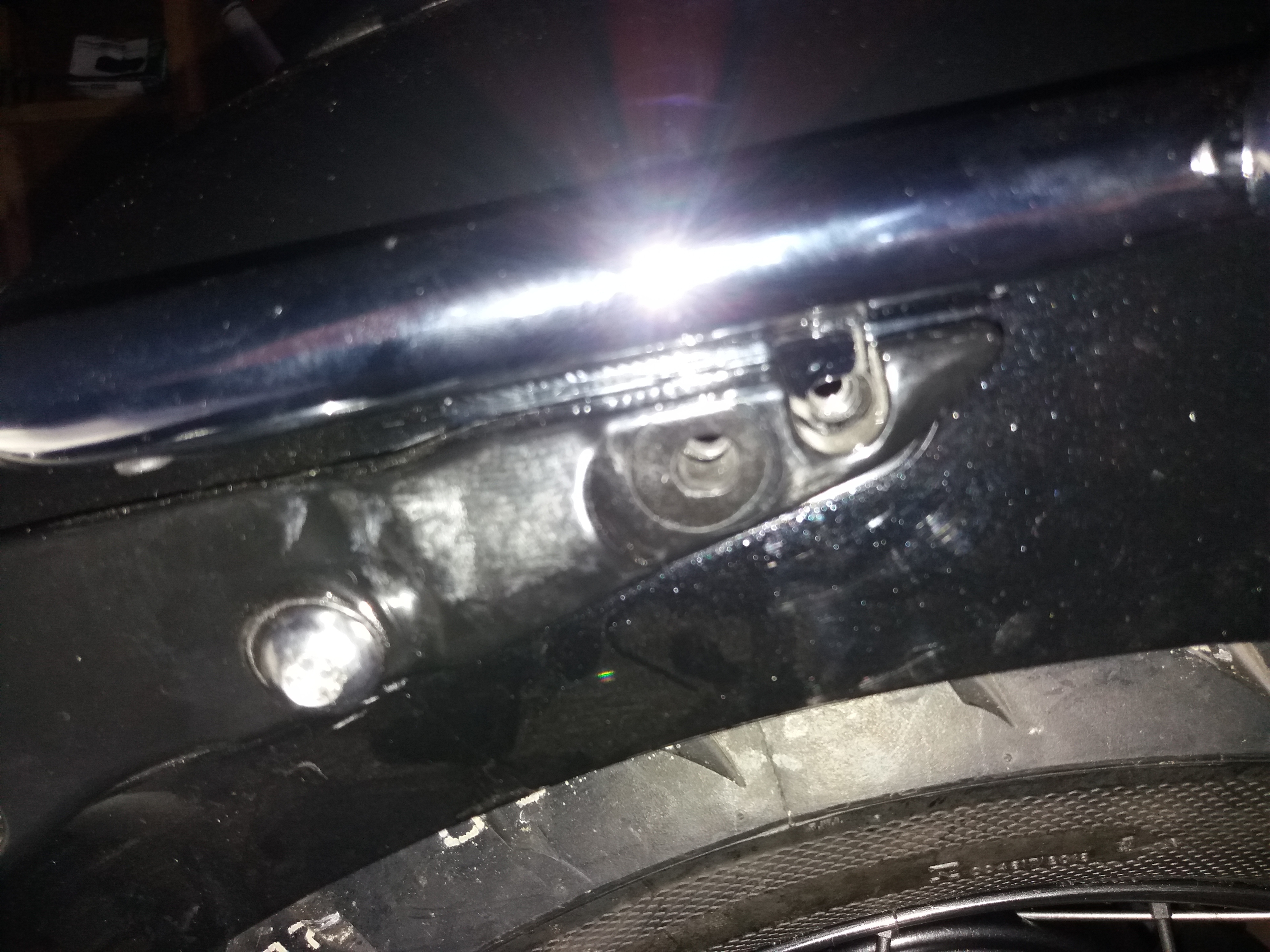

  13. Herman66
    Herman66 Active Member
    Dec 28, 2019
    194
    Dorset, U.K

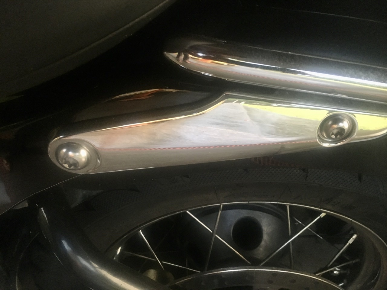

    The 1st picture is of the rear fixed grab rail bracket on the mud guard..I put the collars underneath, I hope this is right?
    I know that you don't have your SM anymore so don't worry if you cant remember, I'm appreciate your time on Easter Sunday anyway mate. I will play around with it all a bit tomorrow. Its just the bits in the bags I am not sure about.
    They must fit on the outside of the inner black side rail I guess...2 screws each side with the pink thread lock?

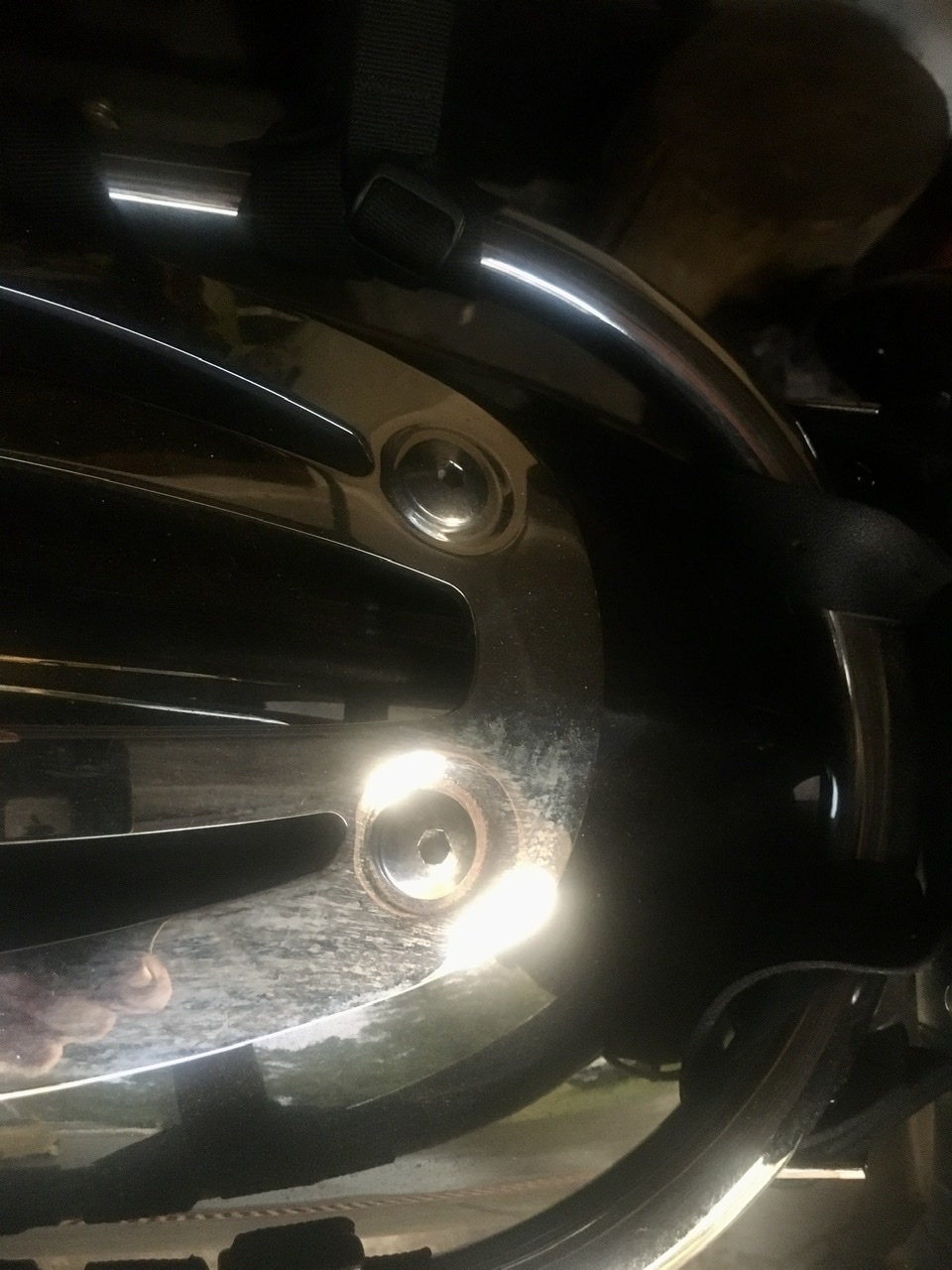

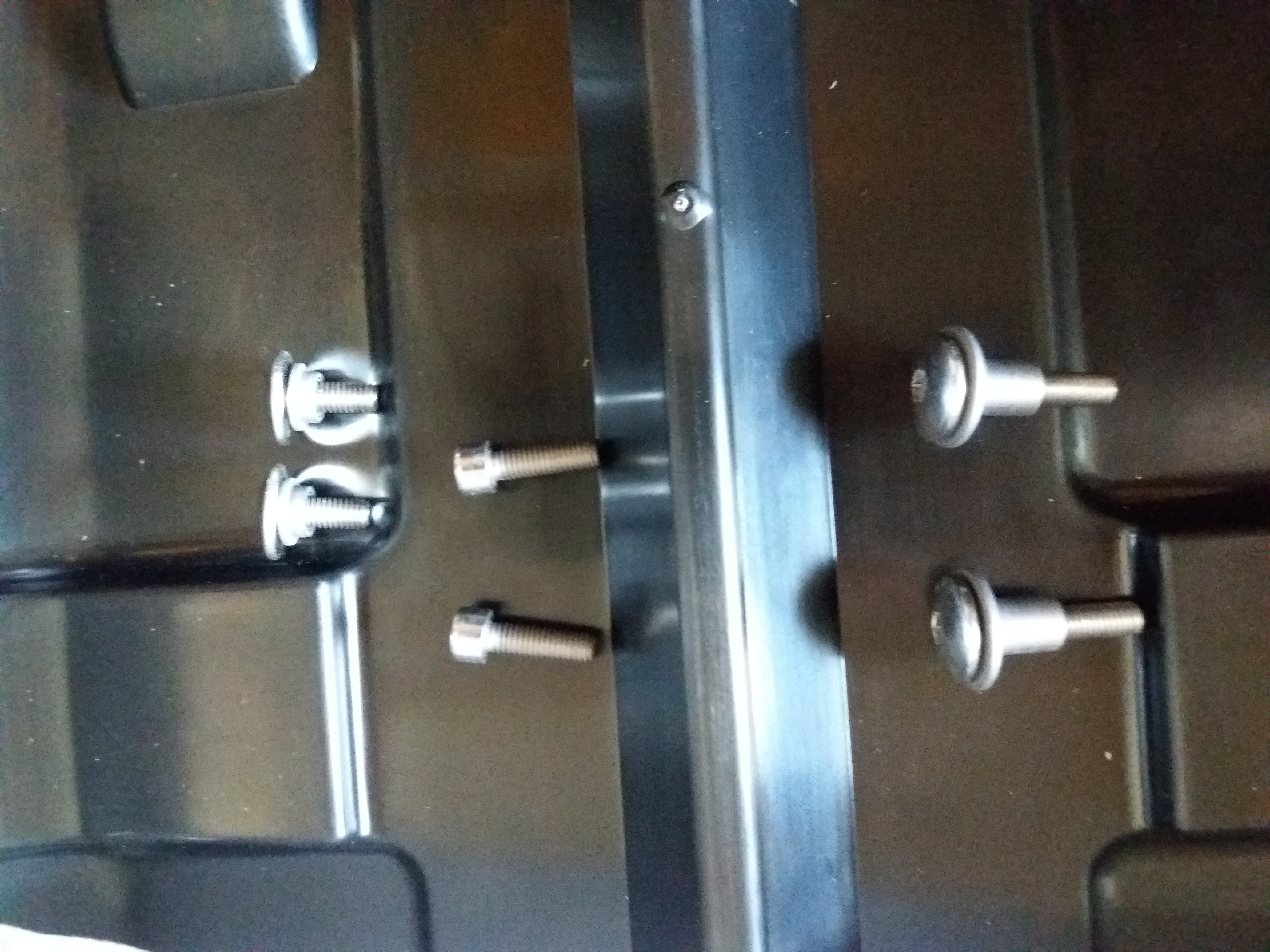

  14. Dartplayer
    7,893
    #14 Dartplayer, Apr 12, 2020
    I have 3 pix below showing main rail (grab removed) and seat bolts (holding guard protector). That just leaves the 2 large bolts on the left of your pic to retain the rear mount.
    Hope that helps

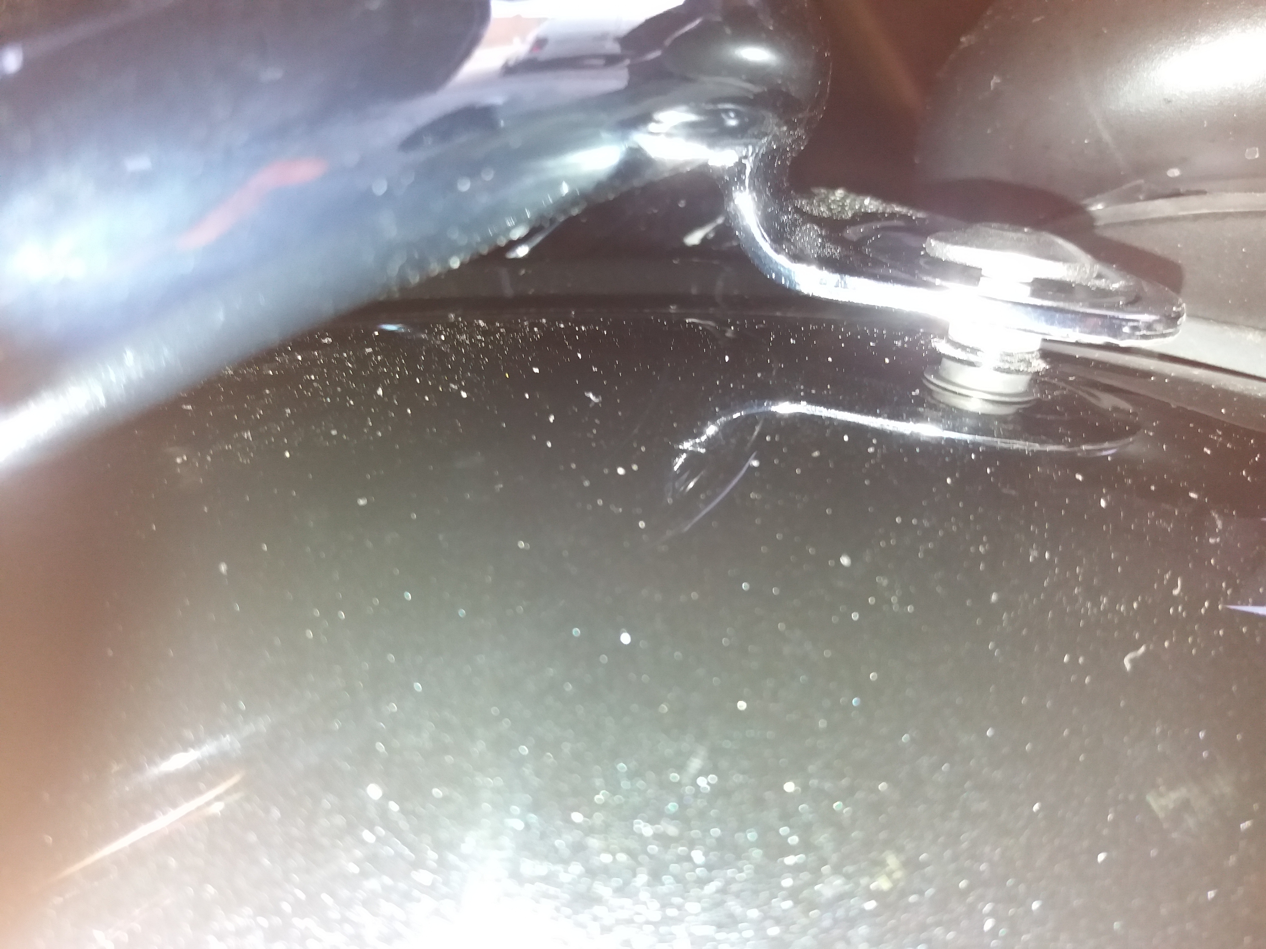

  15. Herman66
    Dec 28, 2019
    194
    Dorset, U.K
    @Dartplayer thanks mate, Could you tell me if the rail at the back is flush to the mudguard, you know where the chrome rail fixes on behind the back brake light by 2 holes on a fixed bracket.I have used the collared spacers to separate the rail from the mud guard but not sure if this is correct?
  16. dilligaf
    No mate :(
    They go flat against the mudguard:)

  18. Herman66
    Dec 28, 2019
    194
    Dorset, U.K
    Thanks dillifaf, It didn't look right, not enough purchase for such an important part.

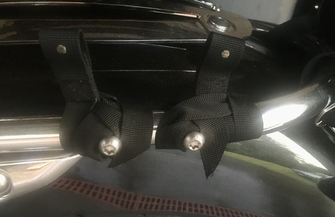

    I'm sure once I get the hang of it...so many bloody side plates!....anyone know how or where the pillion seat grab strap fixes on?

  20. Dartplayer
    7,893
    To the two sets of two bolts on the side. My pic shows them with my Kriega straps.
