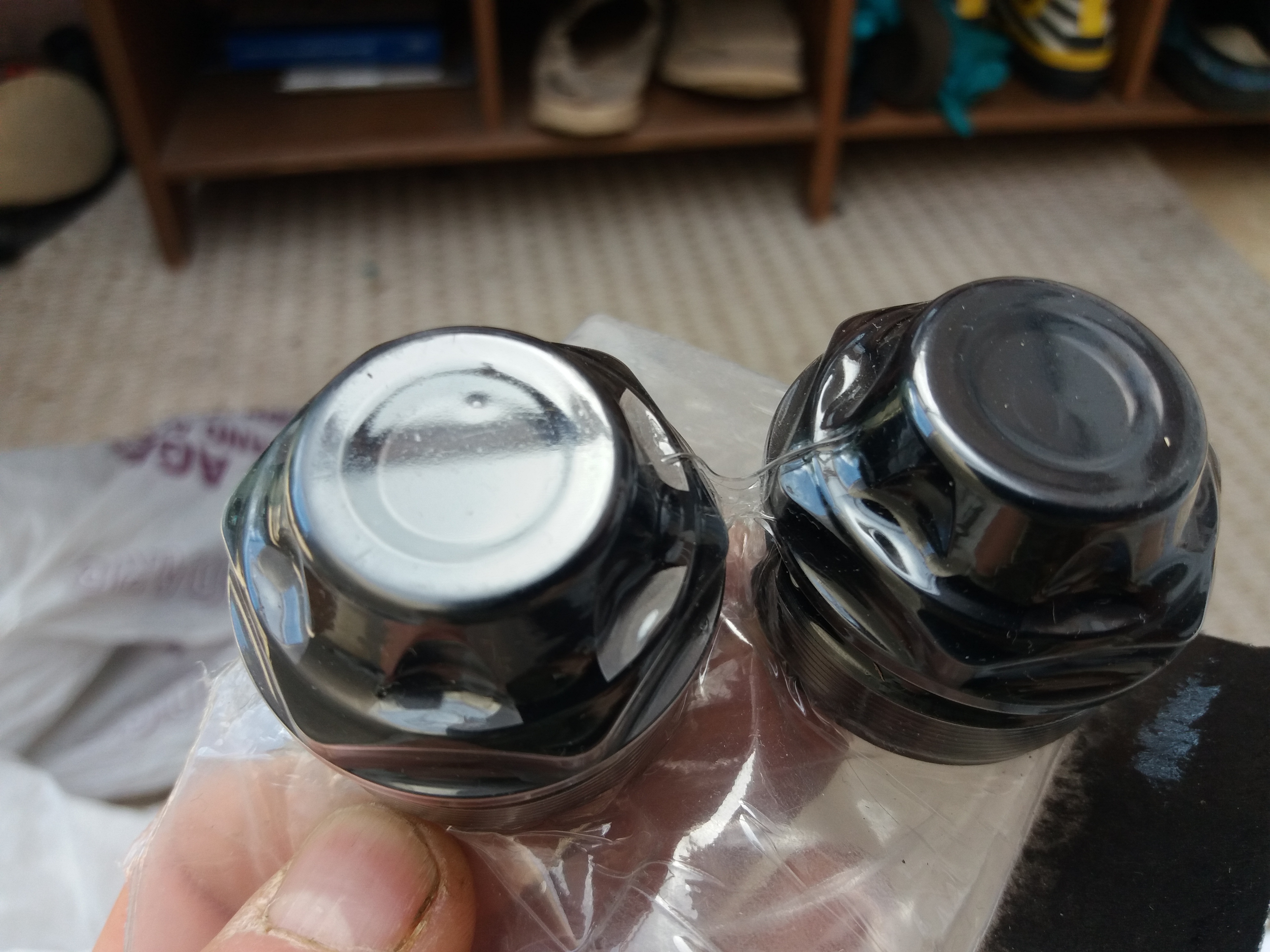

    @ dartplayer hi mate, I wanted to ask you about what year your SM is?
    The reason is I have bought some Wunderkind fork caps for my 2020 SM and they are just hollow inside.. I am confused as to where or how the right damper rod is supposed to screw into..

    Hi @Herman66, 2018. The stock fork has a damper with a spacer on top.
    The cap should replace the existing threaded caps, allowing progressive adjustments to increase/decrease the damper/spacer.

    Thanks @Dartplayer & @brown mouse .. I bought some 41mm black Wunderkind fork caps but they are both hollow inside..no hole or thread for the right hand side damper rod to screw into.
    I emailed Wunderkind and after numerous conversations they say they are for Bobber and Bobber Black not Speedmaster.
    I bought them from British Legends a French aftermarket part site where they clearly show they are for the Speedmaster. This has happened so many times to me over the years I am close to giving up totally on these 'aftermarket' sites. Hopefully I will get a refund...

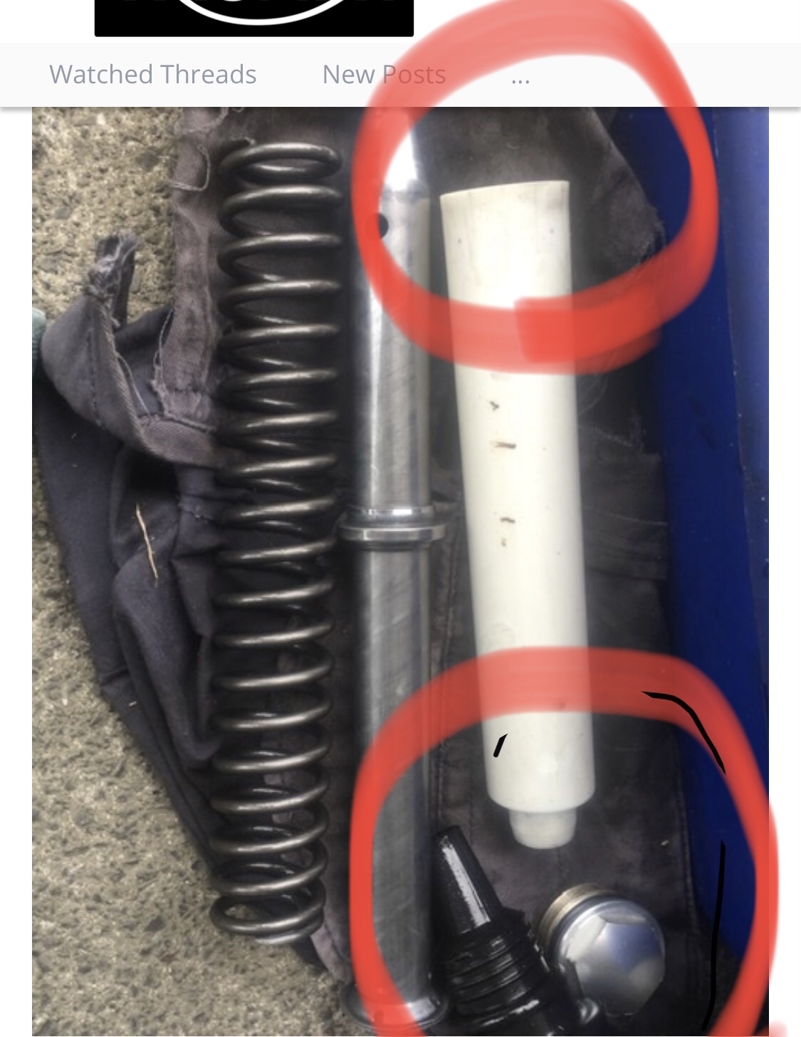

    But the right damper rod still needs to be screwed into the Wonderkind cap or am I missing something
