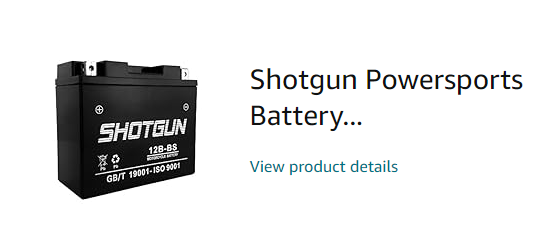

    That battery is far too weak for these bikes. Be careful or you may damage the sprag clutch.

    Many thanks for your comment. Which battery would you recommend?
  19. Limey Rider
    Limey Rider New Member
    Jun 20, 2023
    Hartford Wisconsin
    I searched on Amazon this is the Battery I purchased and works great its 210CCA hope this helps. upload_2024-4-16_8-28-46.png
