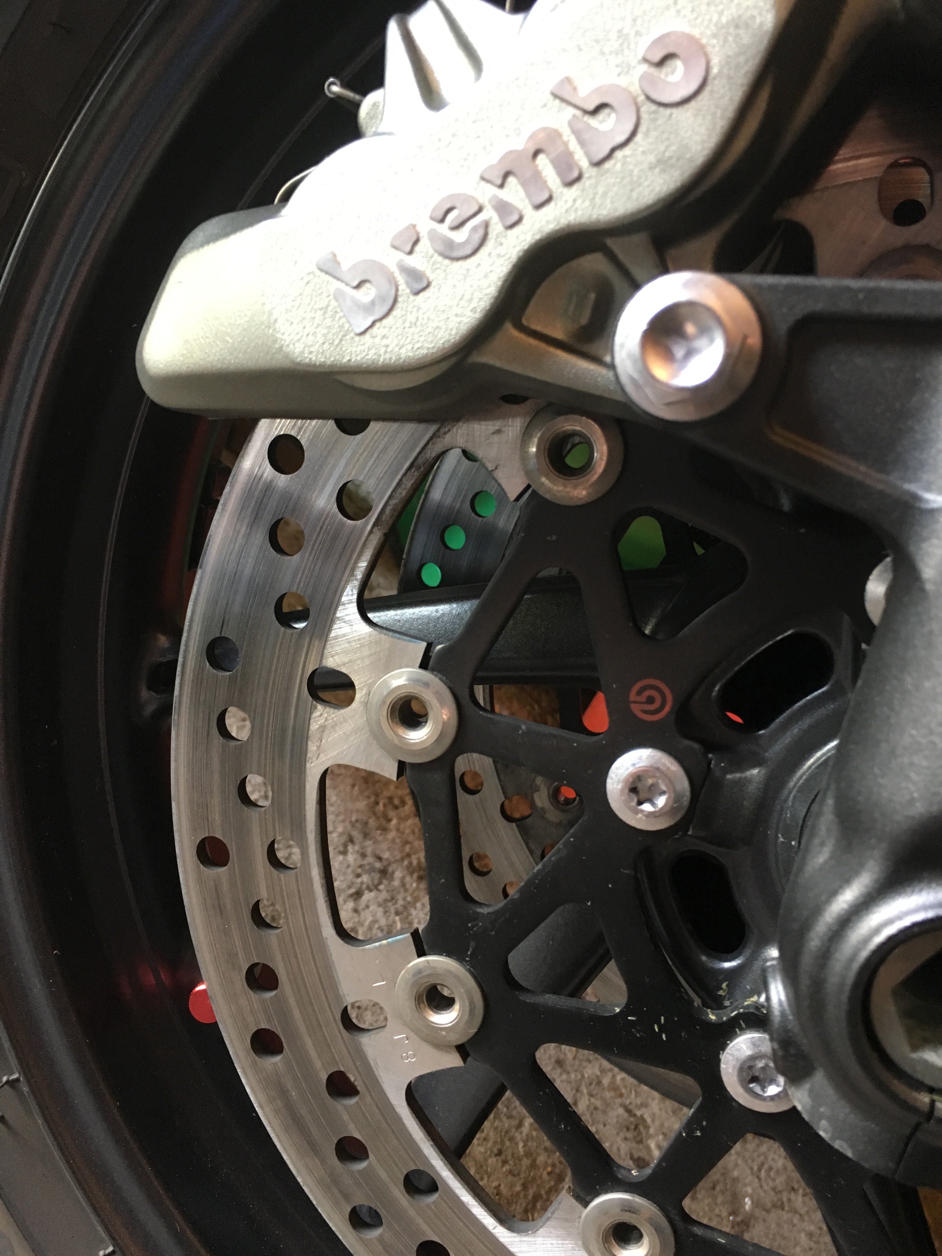

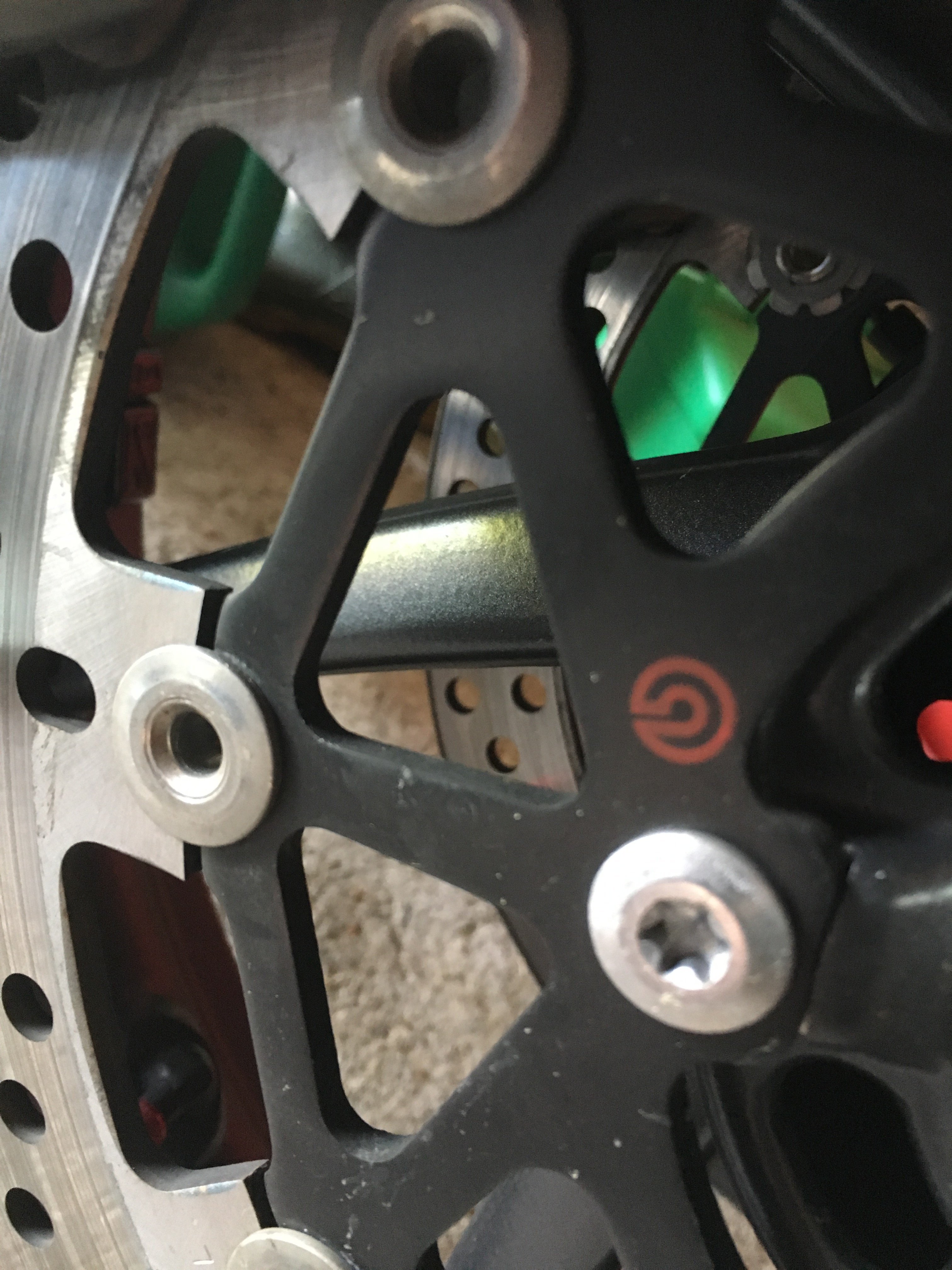

    You say to buy some Brembo discs and mention further on about fitting Brembos but surely the discs on the Speed Twin are already Brembo's?? if you look at the pics I have posted you will see the small orange Brembo symbol on the actual disc.
    Also I wouldn't have thought that they would have fitted bog standard Triumph discs along with Brembo callipers etc, but hey being new to Triumph what do I know????
