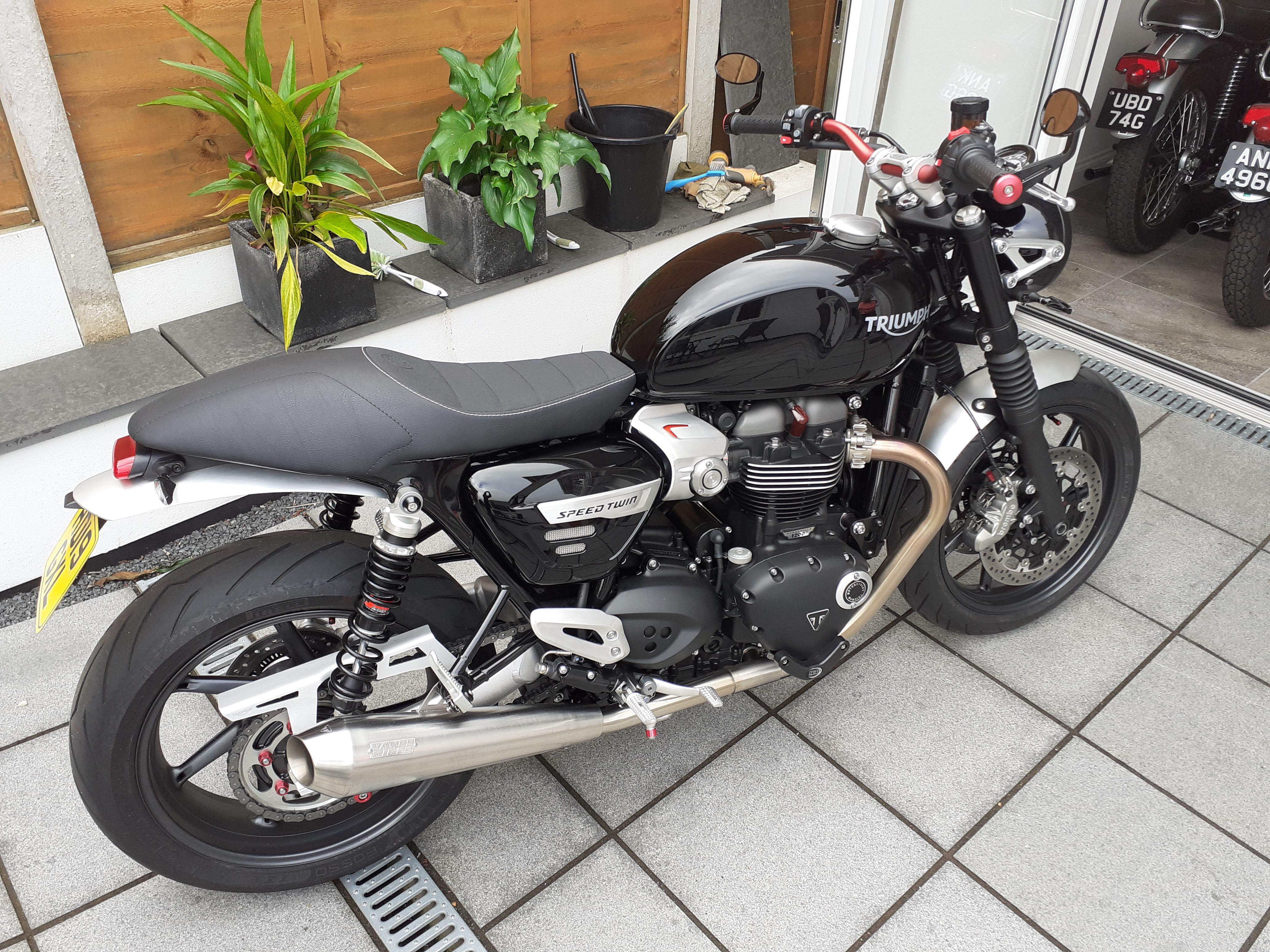

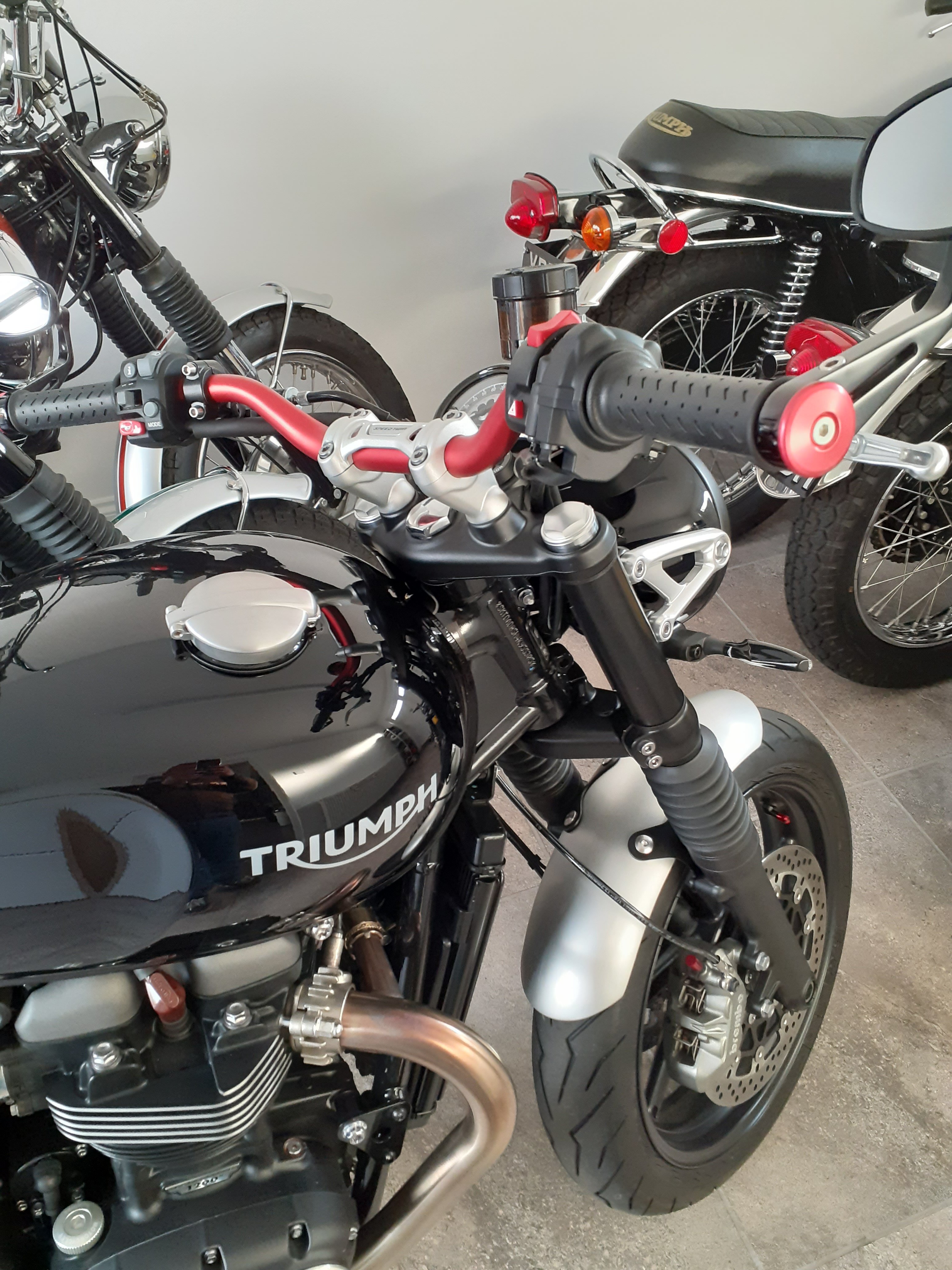

    I fitted some higher Rizoma bars to my ST with no other mods.

  9. Golgotha
    Golgotha Guest
    Those subtle red accents placed here and there are pretty sharp. They really make the bike pop without being ostentatious.

    This is great! Thank you! I’ll give it a try with a slighter taller and more pullback bar. Sounds like as long as I don’t go wild with the bar choice I should be ok. And great looking bike! I dig the red bits. And what a garage!!!!!
