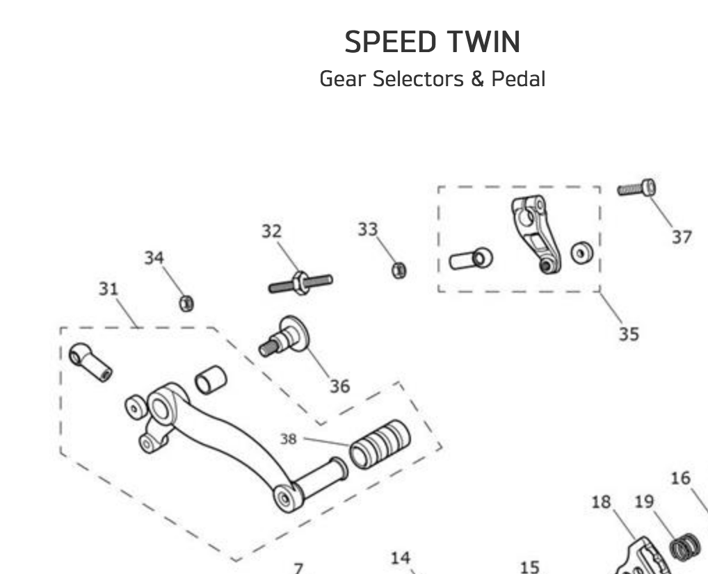

There's been a few issues with this coming undone, quite a few according to the little survey going somewhere. So just had a look at my gear linkage, assuming that mine would be okay and that it is an owner-bolt-checking issue rather than a warranty issue.... It was a bit loose! There is a little washer I think, well something moved, so I got a 10mm spanner on the ball joint and wound it in half a turn maybe, not much. Looking at the parts diagram, there is no sign of the bolt part on the ball joint or a washer. I'm talking about the ball joint on the gearchange rod (part #32) that screws into the back of the gear lever under the main pivot. You could put a 13mm and 10mm spanner on the adjuster rod locknuts too. They were okay, (as was the front ball joint) but could have been a bit tighter. I think the gap available for a standard spanner is a bit tight and maybe the loctite used, assuming it was, is a bit feeble. Will return to mine with some decent loctite. Anyway, something to keep an eye on.

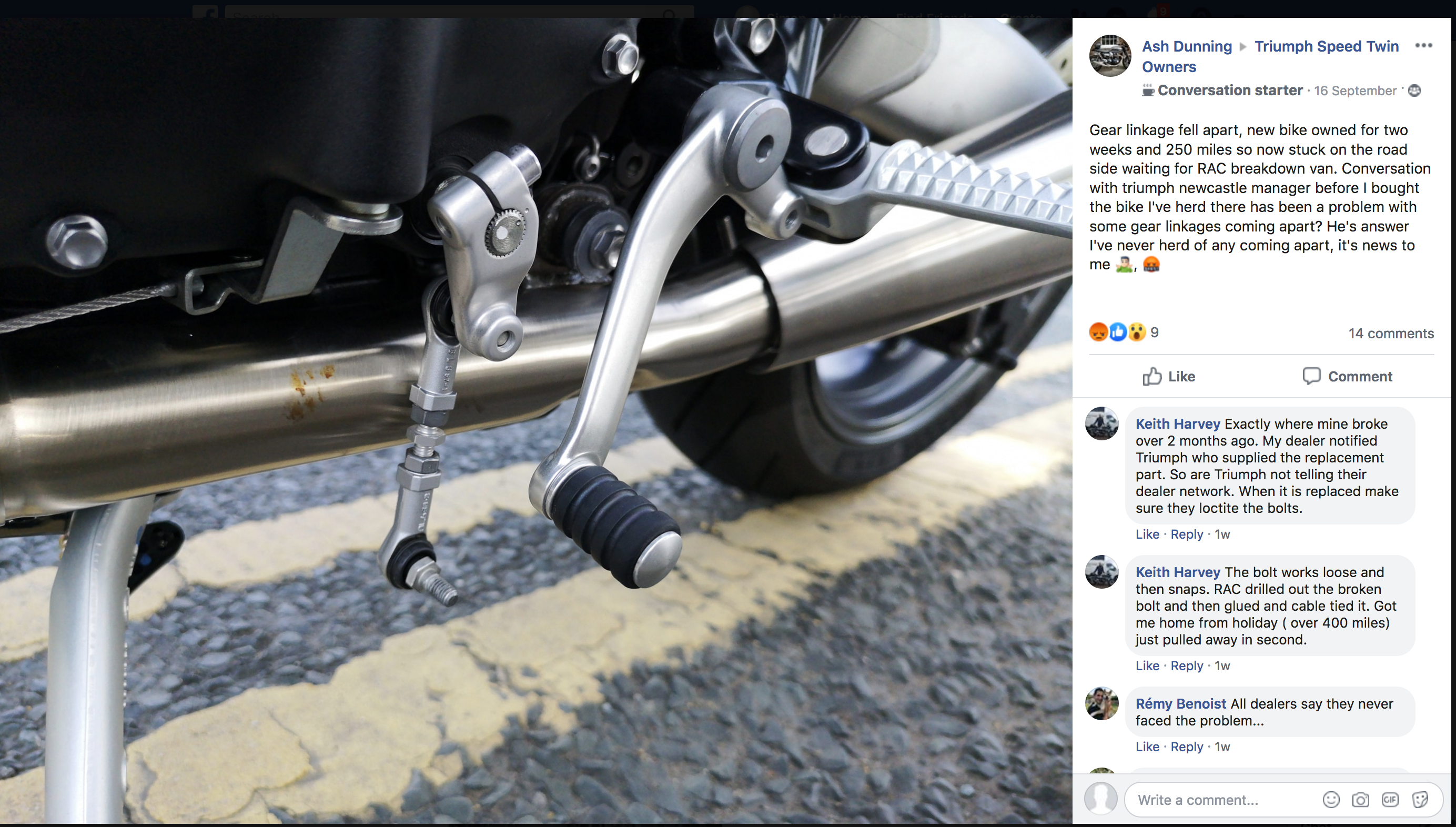

Mine came totally disconnected at like 450 miles. I guess that’s my bad for assuming that the dealership went through the bike after unboxing it to ensure it was good to go, obviously not...bastards.

Just checked mine in readiness for the DGR and it was the front linkage which had about three millimetre gap. Threads felt like they had locktite but not doing its job. All tight now. Many thanks for the warning.
Just had checked mine this week at work just because I have had them come loose on bikes I have had in the past. Bike now has over 3400 miles. Yes it was loose. Took both ends of the shift linkage off and put blue/medium loctite on the threads and put it back together. Also I took a grease needle and injected some grease into/below the rubber boots on both ends, maybe it will last longer..... So yesterday I got a recall notice in the mail, had to laugh, seemed ironic to me recently doing it. Recall is they take it apart and put loctite on the threads. Called the shop I let them know I had already done it. I have done it on other bikes with them coming loose. I had a Victory for years, it wore out, put a different one on it I made up with small heim-joints and all thread I had ordered on-line. Side note it seems on a lot of bikes I have had the pinch bolt on the piece of linkage that actually moves the shift shaft going into the transmission likes to come loose also, so I try to check it also once in awhile.
Mine sheared off completely on monday 16th march 2000 miles, triumph recovered bike and supplied new one under warranty. ginger
