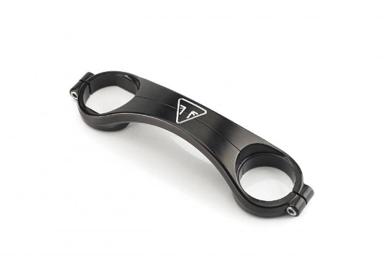

    That's definitely the part number for the brace that fits the speed twin.
    I fitted mine after setting the forks parallel. So I cant say for sure if it was the fork brace that improved the handling or lack of stiction from the forks that the bike had been suffering with from Day1. Just bolted straight on - whether it would have done so had the forks been in their original position is unknown. The forks moved 0.5mm further apart once the clamp pinch bolt had been slackened off on the right hand lower fork leg.
    I found no UK dealers kept this item in stock, but a back-order purchase had it delivered within a couple of days.

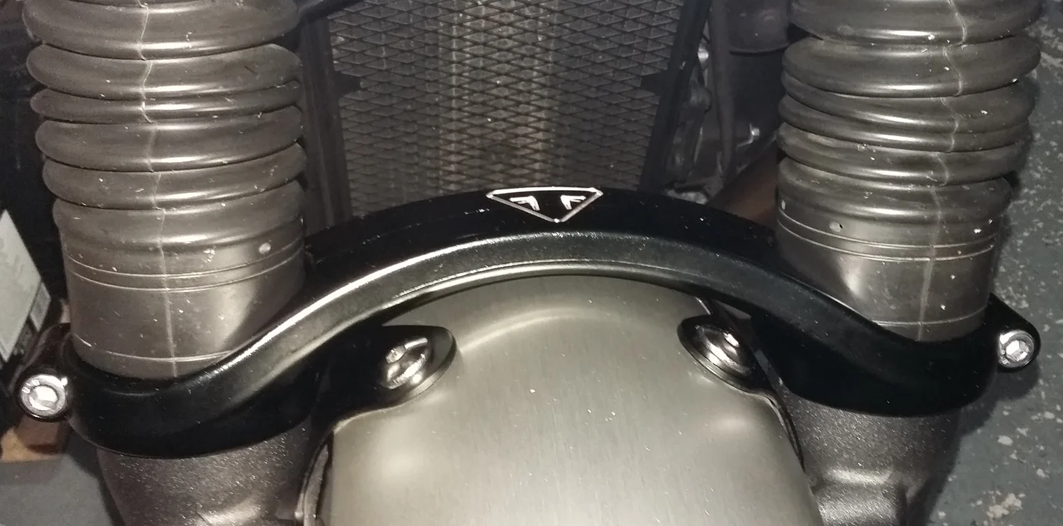

    The gaiter needs to be moved up before fitting the fork brace.
    Underneath the Speed Twin gaiter there are two locating grooves, once the gaiter has been correctly positioned in the upper groove the Triumph A2041204 fork brace is then fitted and covers the redundant lower one. This is a totally different fork brace to the aftermarket one seen in the video. The two (unseen) inner bolts are torqued first to 25Nm, then the two outer bolts are tightened the same amount.
    NB Tighten the outer left hand (gear lever) side bolt first, this tightens the circular end of the brace around the left fork leg and then tighten the other one which clamps the elongated (floating) end of the brace around the right hand fork leg.
    edited for bolt tightening sequence

    I fitted the fork brace this evening. One caveat: follow Kinjane's instructions (above,) rather than Triumph's (available online.) It's almost impossible to fit the gaiter after the brace is installed (as suggested by Triumph.) Personally, I think the bike looks better without the brace, but I've found that conventional forks (as opposed to the inverted ones like on the Thruxton R) benefit from a fork brace. I'd previously installed them on my ST1300 and KLR.
