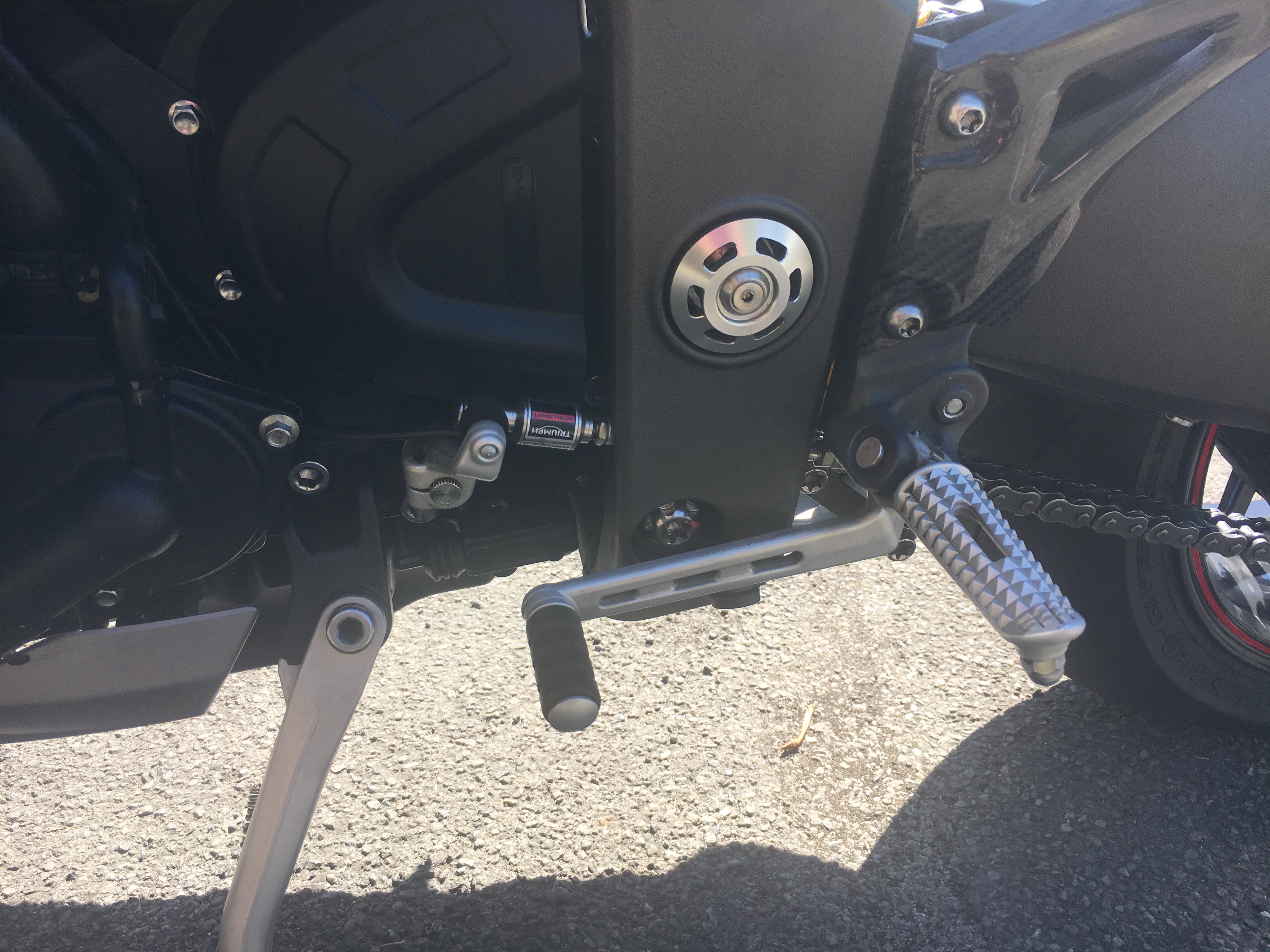

    ok was thinking of getting one s there anyway of seeing if quick shift soft ware has been activated without taking it to a dealer ,cheers

    Are they charging £310 for it, looks like it’s just a Translogic rod with sensor?

    You can turn the quick shifter on and off via the on screen menu under bike set up

    If you go into setup it will be in the list alongside indicator options etc if software has been installed

    Fitted q/s today works a treat
