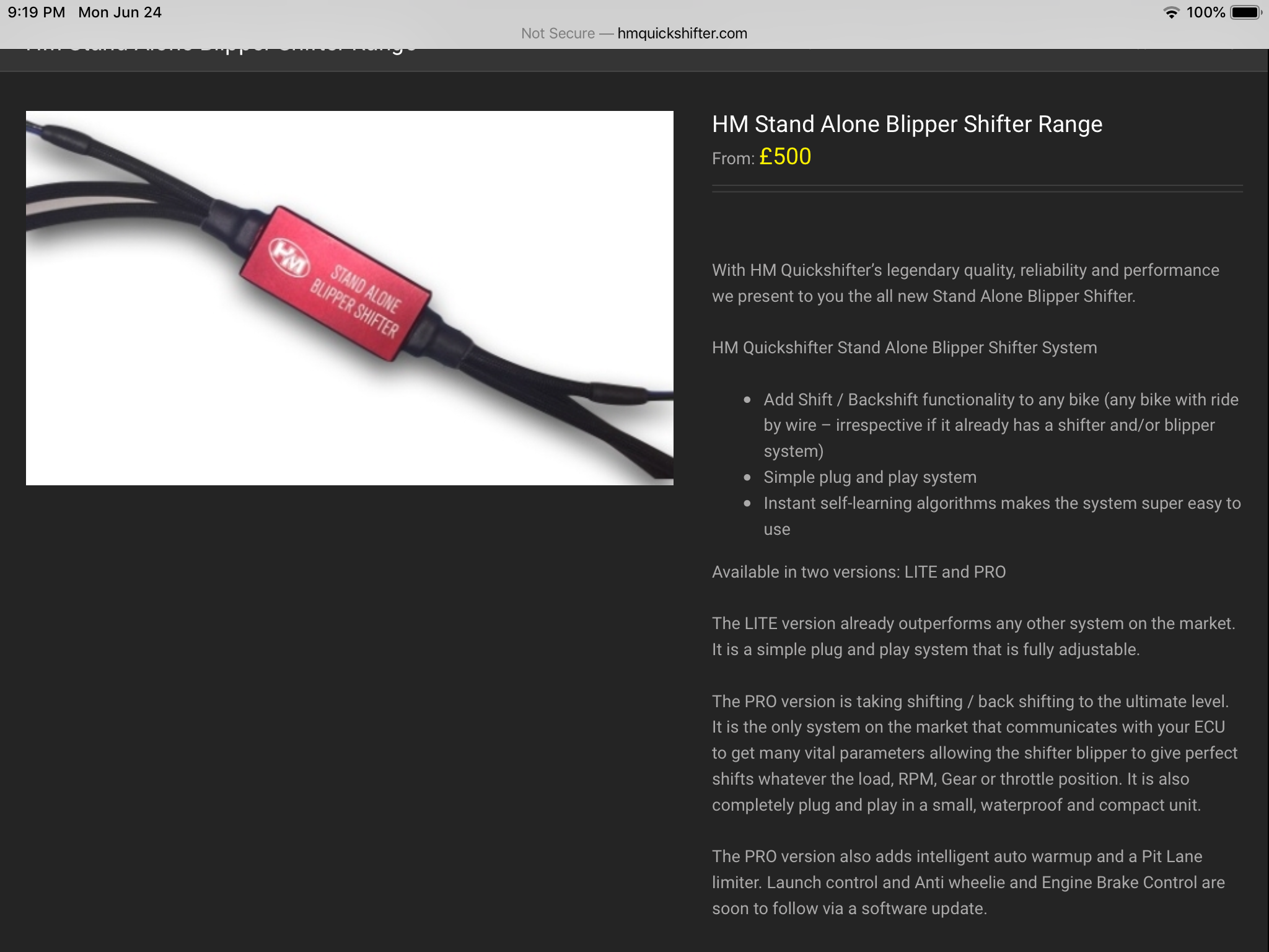

    Nope, first time with one. The HM was recommended in a review I read of our bikes. Sounds top of the line. I actually emailed them and they offer a stand alone blipped/shifter, see photo below. Might have to go this root, sounds like a far superior system anyway.

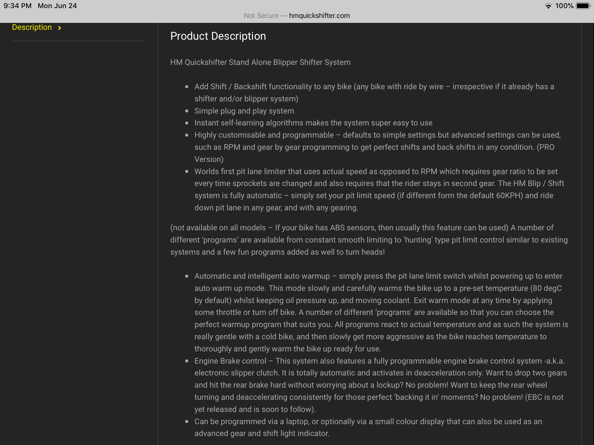

    More info on HM quickshifter.

    The HM unit is truly fantastic and what a blipper shifter SHOULD be. To be fair!
    I also have a contact who works there if anyone does wish you purchase one I can put you in touch for a better price.

    I was told the “Stand Alone Blipper Shifter Range” fits any bike with ride by wire throttle. It was what they recommended to me. What am I missing here?
