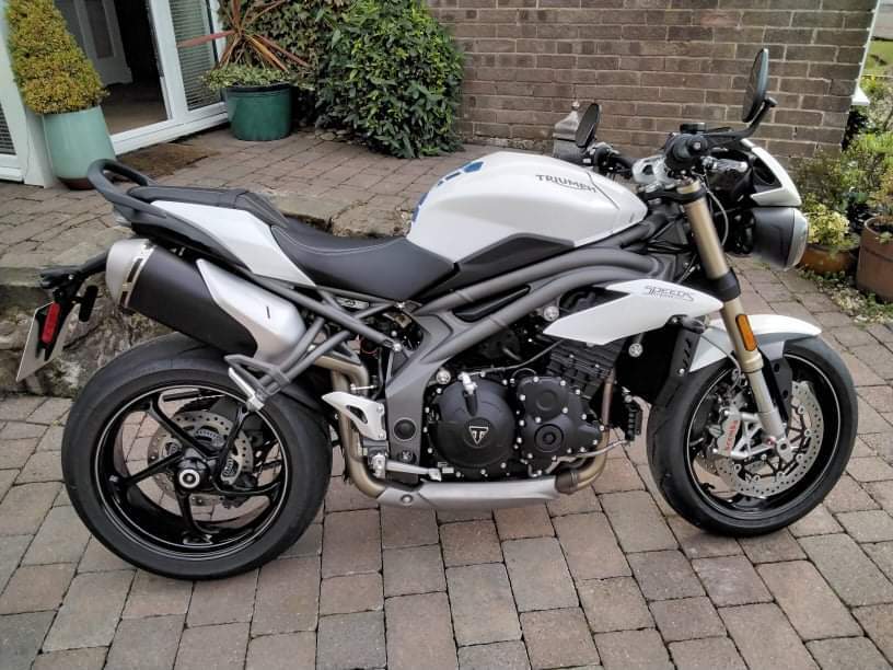

    Absolutely, I sold my speed triple r, lasted under a year before returning, didn't want keyless or quickshifter, bought the S model and don't regret it one bit received_302722714537548.jpeg
