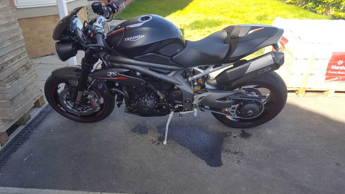

    Tank fuel connector is loose...... you might guess how I know. It took about 3 weeks for mine to decide to come loose on a weekend in the Lakes (after I had removed the tank to fit the QS).
    Easy roadside fix as long as you have a mate with an 8mm spanner (there is one under my seat now).

    Yip i have a feeling its gunna be that, i refuse to get my spanners out buddy, its just been serviced ££££ and I've not had it to bits yet.

    Nope it wasnt as simple as you describe dude and I'm really glad i didnt look into myself and waste my day in the process..... my dealer reported back- the fuel line from the tank to the throttle bodies was at fault.:pensive:
