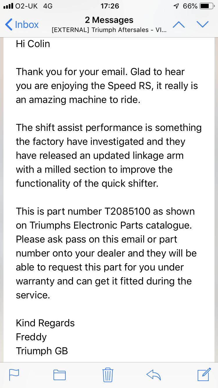

    Scotland
    We’ll triumph got back to me today by email offering the new linkage part and to be fitted under warranty...did admit they new about the prob and said this would solve it...as we already new..
    Least it’s one other complaint they can register about it...
  13. Heyho
    Heyho Well-Known Member
    Mar 24, 2019
    107
    83
    Scotland
    That’s the email they sent..
