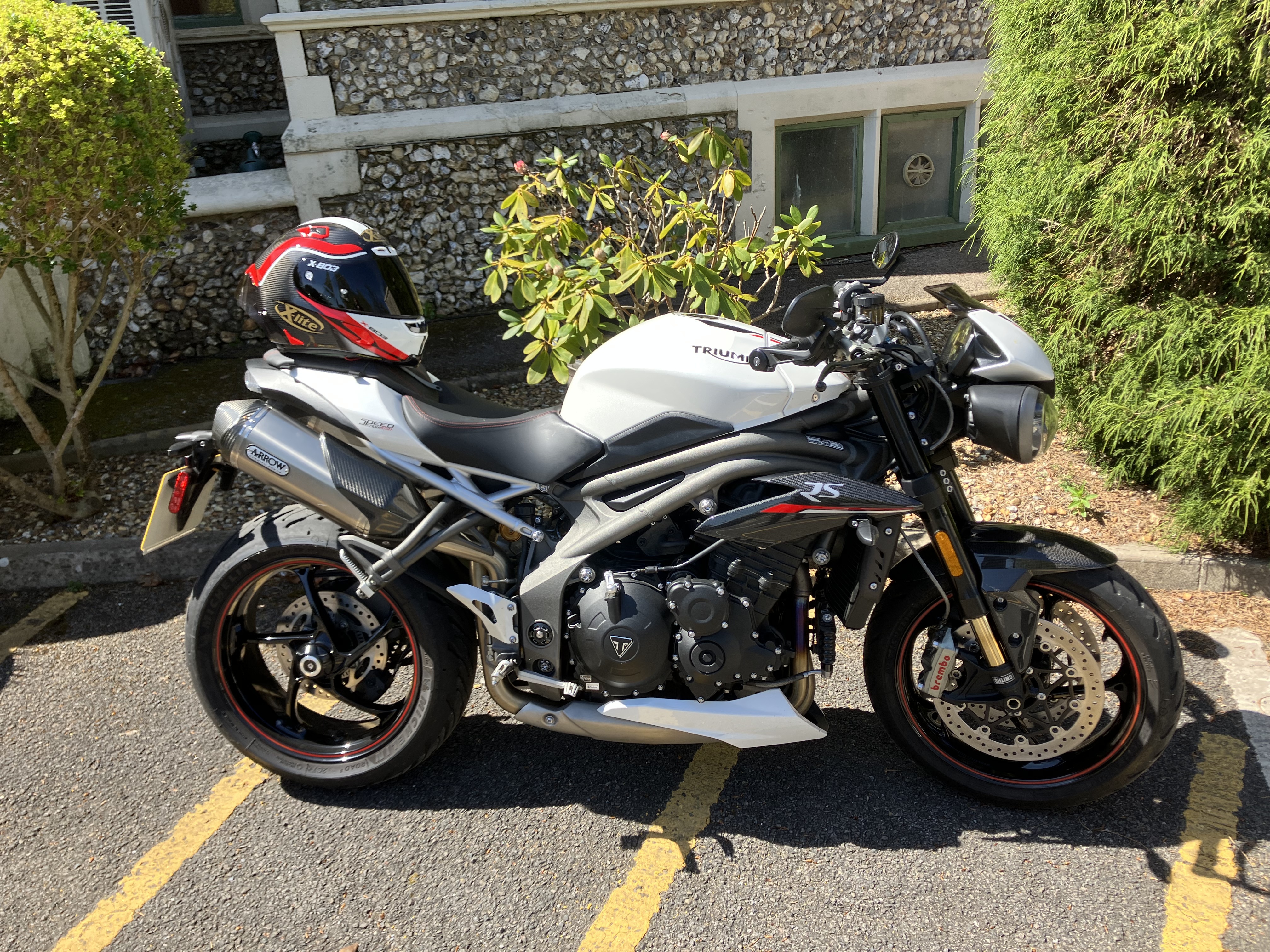

    Didn’t get a thread update.
    thanks guys, should be a photo attached.
    All the best.

  13. Linx
    Linx Well-Known Member
    Mar 14, 2020
    284
    198
    Stratford Upon Avon, UK
    Very nice! :)

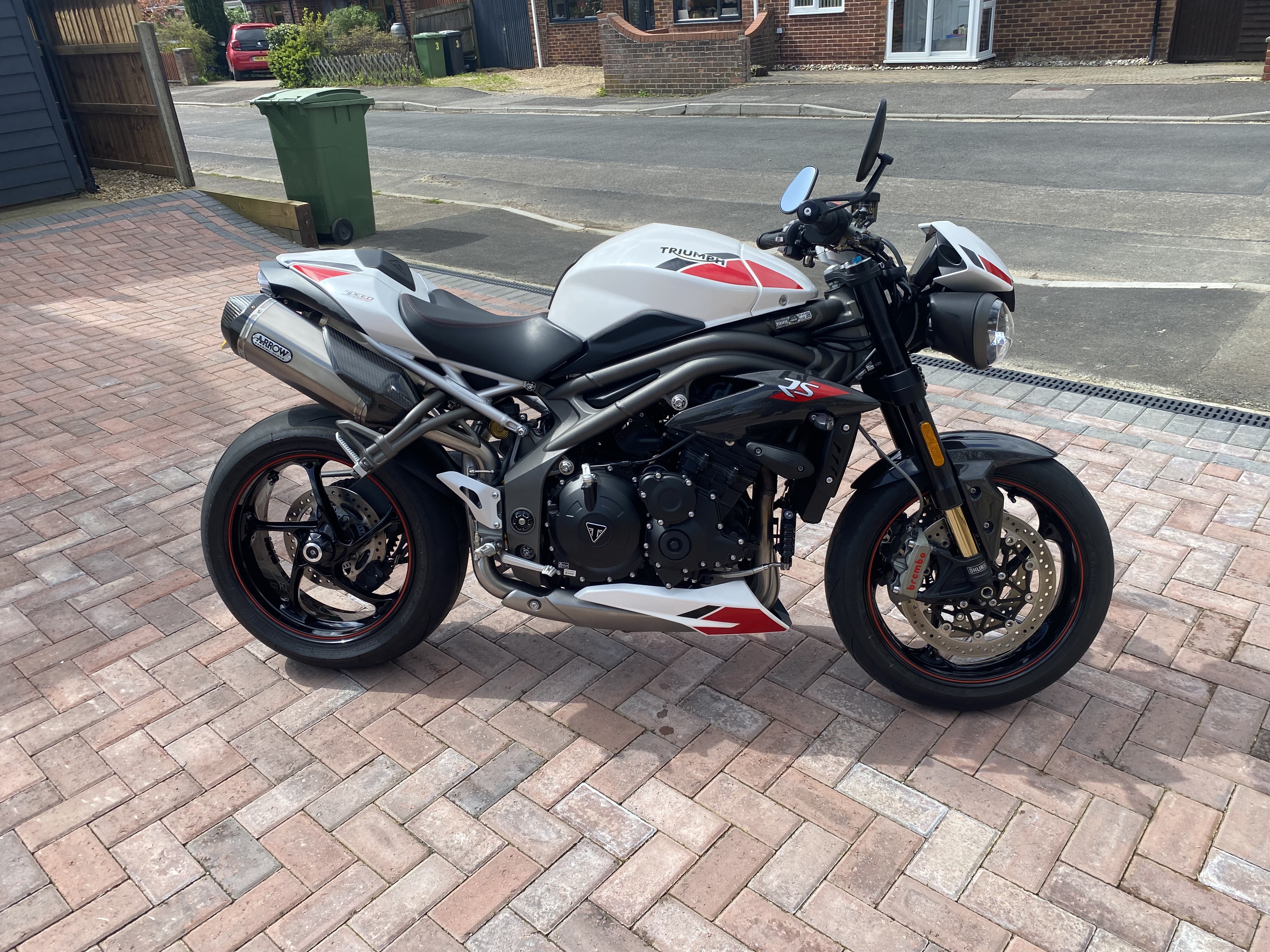

  14. Oldskool
    Oldskool Elite Member
    Jan 29, 2019
    2,277
    3,316
    Here’s mine, out today on it. Loved it..!
