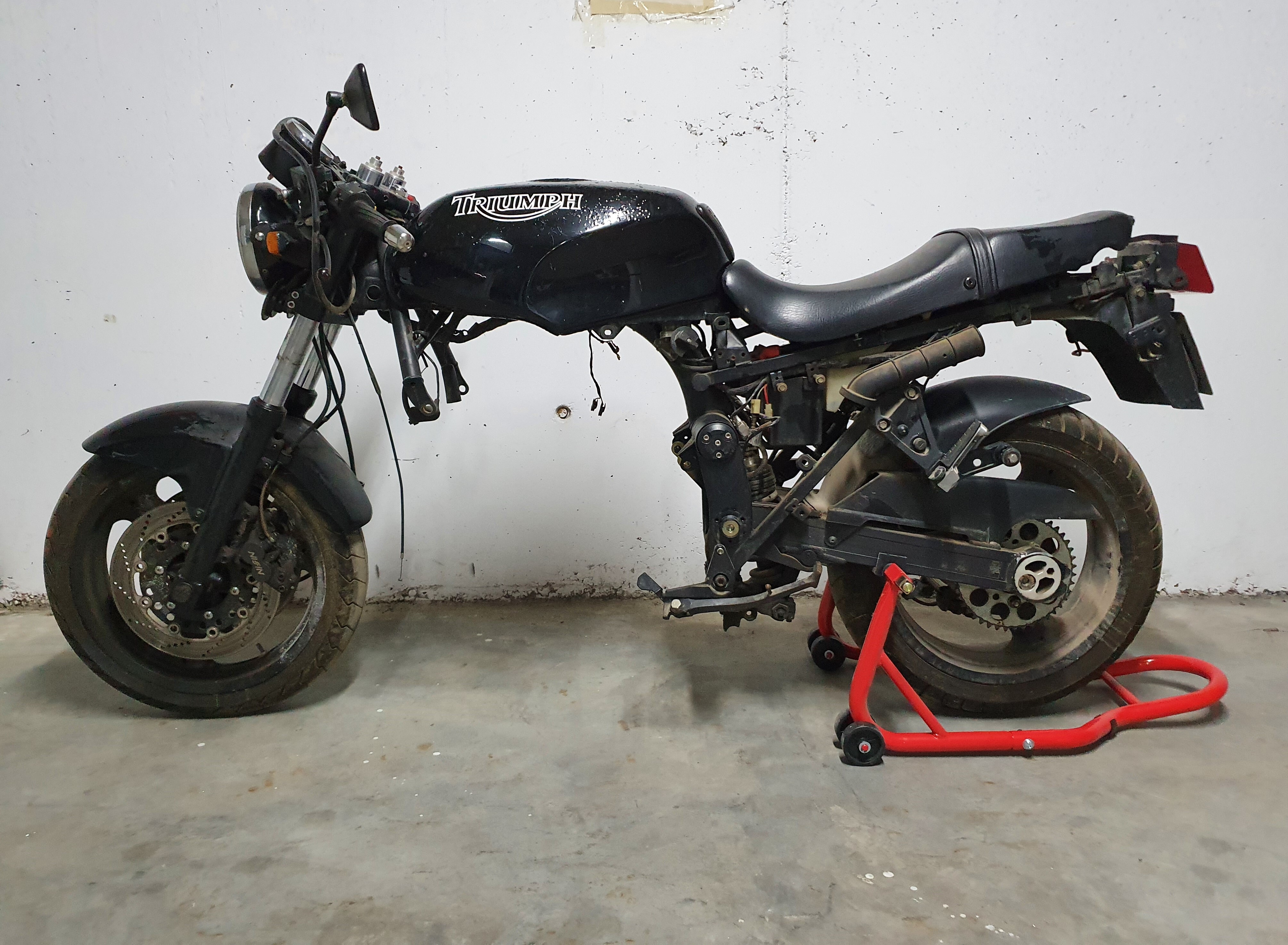

    I went to see it and I found was a Speed Triple black devil who had been treated very very badly for a long time.
    Love at first sight was instantaneous and I can hardly hide my joy even though she was not at her best.
    Here she is...
    I tried to start it, but it does not start, it must be the battery... :joy::joy::joy:

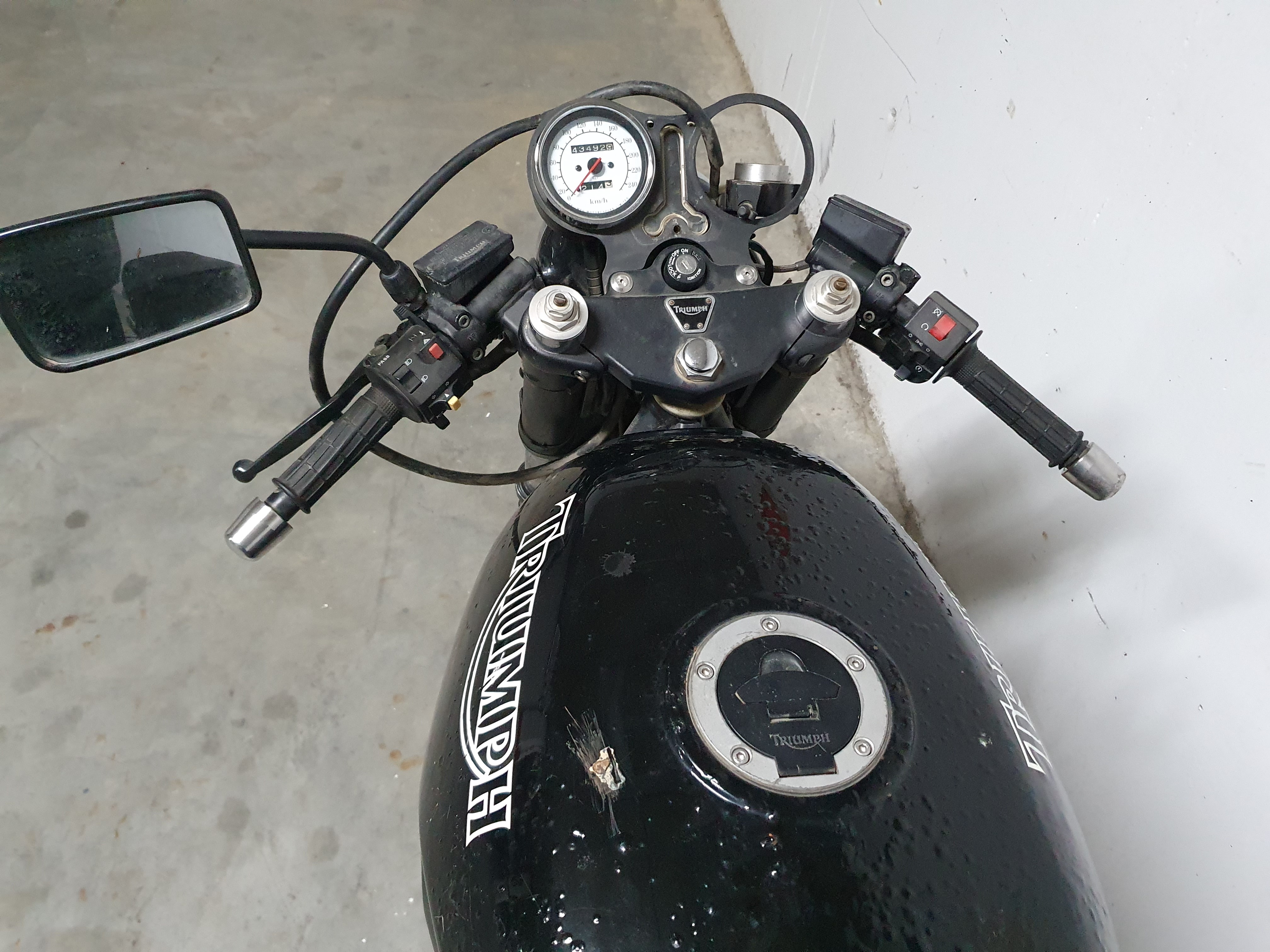

    I know the work will be hard and long, but I'm not in a hurry and the result will be worth it.

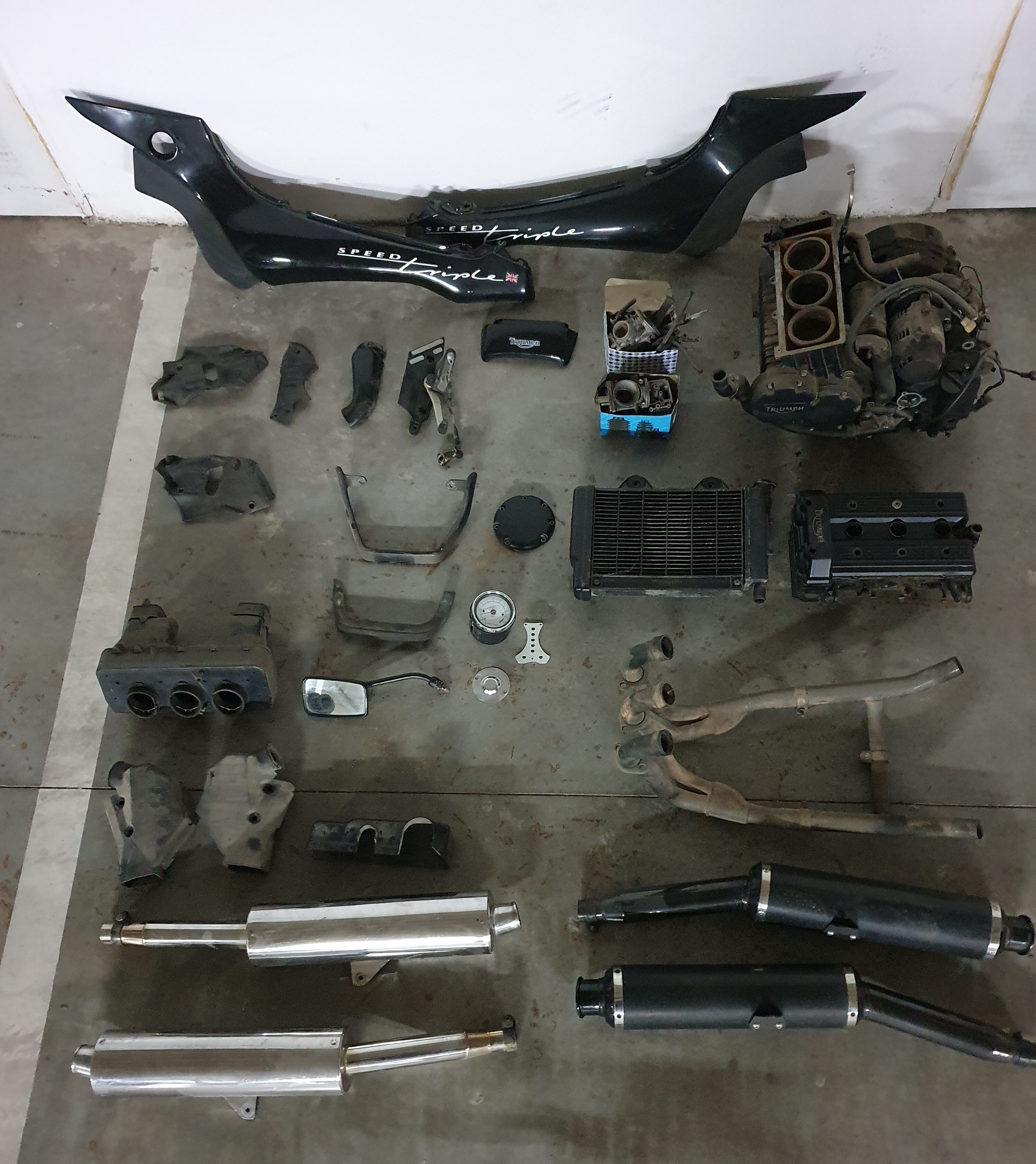

    Yesterday afternoon I took a little time to see the things I had from the Speed, I can surely say that it was not a good day, as you say the project is very big, and I was a bit disappointed.
    This morning, after consulting it with the pillow, I woke up more optimistic and at the same time more realistic (In my mind the Speed was much better).
    I am clear that I am going to return it to the road, I have to study all the options well and I´ll take a way and I take it to the end.
    So I would appreciate any idea even if it is very crazy.
    These are the other things I have from the Speed, this and a couple of small boxes with screws and small parts.
    #4

    Actually, engine aside, you appear to have most of the important bits except for the coils and leads (unless they're still on the frame?); one (?) carburettor and the brake pedal/mounting.
    When you take the tank off to refinish it, try to get the tank protector pad off in one piece - it looks like a genuine Triumph one from the period and looks like it's worth saving!
    Keep the black exhaust/silencer set up - that's the original - and sell the other one!

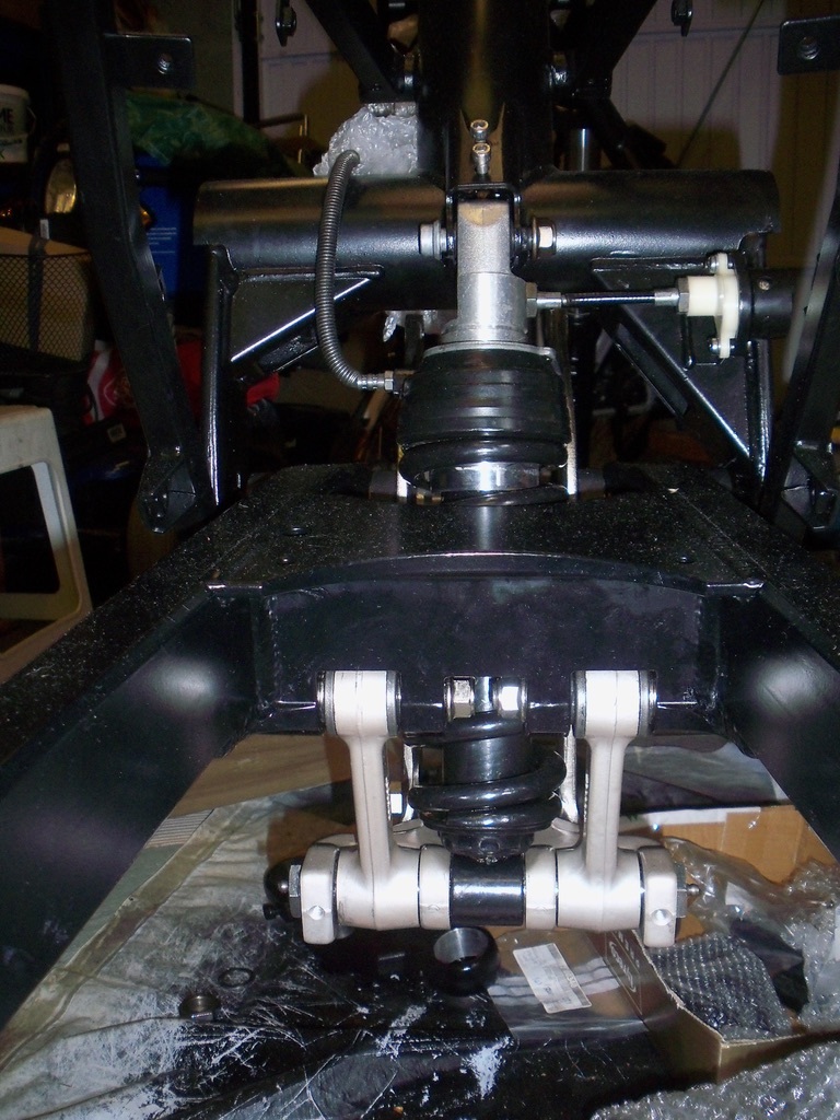

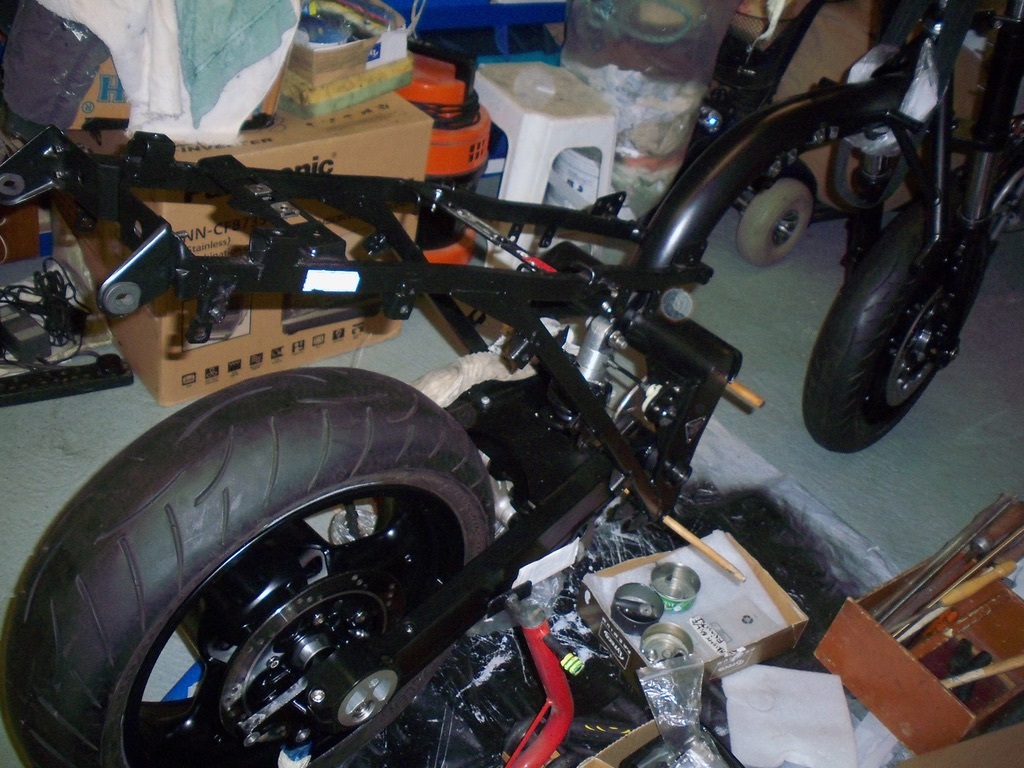

    Some Before & After pics!
    Best of luck and happy spannering! Let's see who gets back on the road first, eh?

    I think I have practically everything, the brake support is on the bike, I have two coils and cables, the other may be in the frame, I have not looked at it. Carburettors are all three, it does not look good in the photo.
    The bike came with stainless exhausts, but a few days after I bought the bike I saw an ad where they sold the original exhausts of a Daytona, which had been removed from the bike with 10,000 km and they had stored in the garage more than 10 years and I bought them. They are like new and they only cost me 100 euros.
