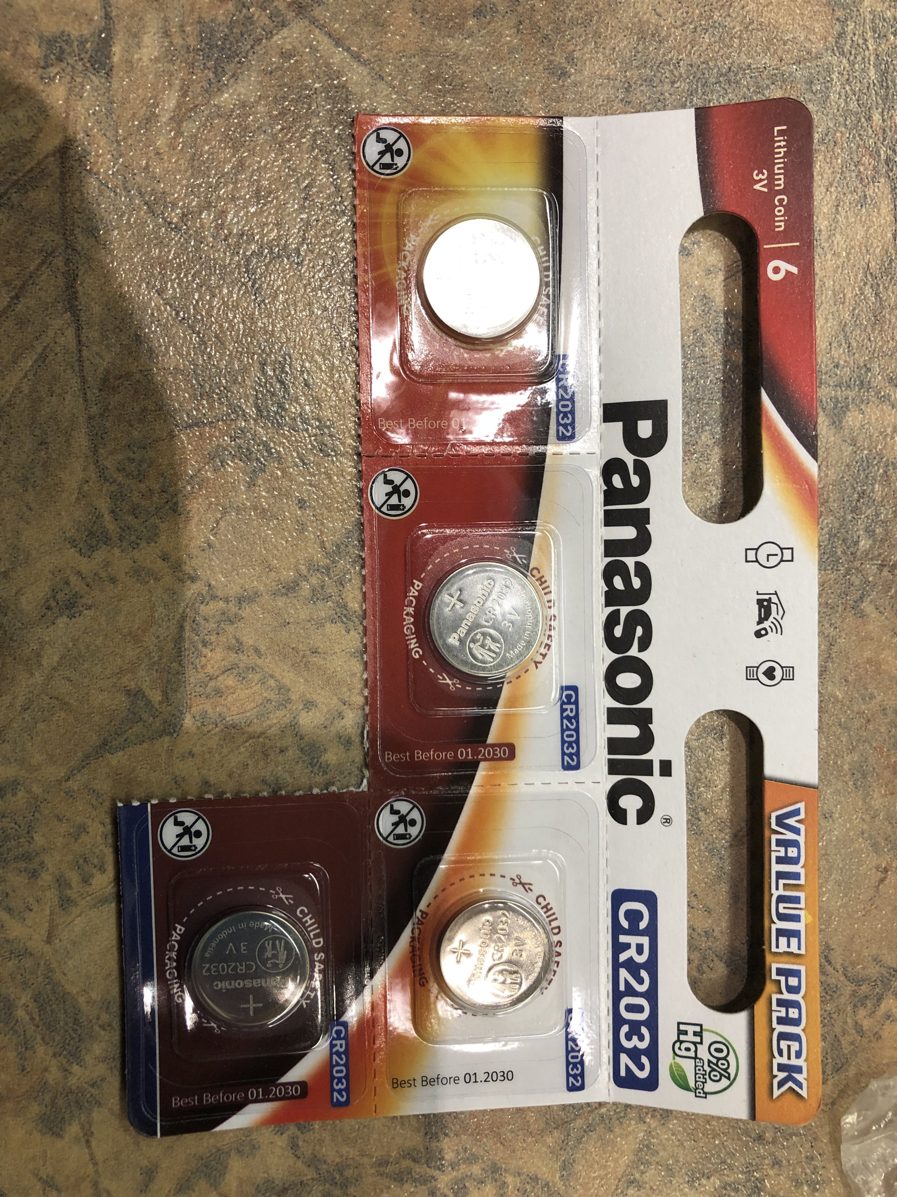

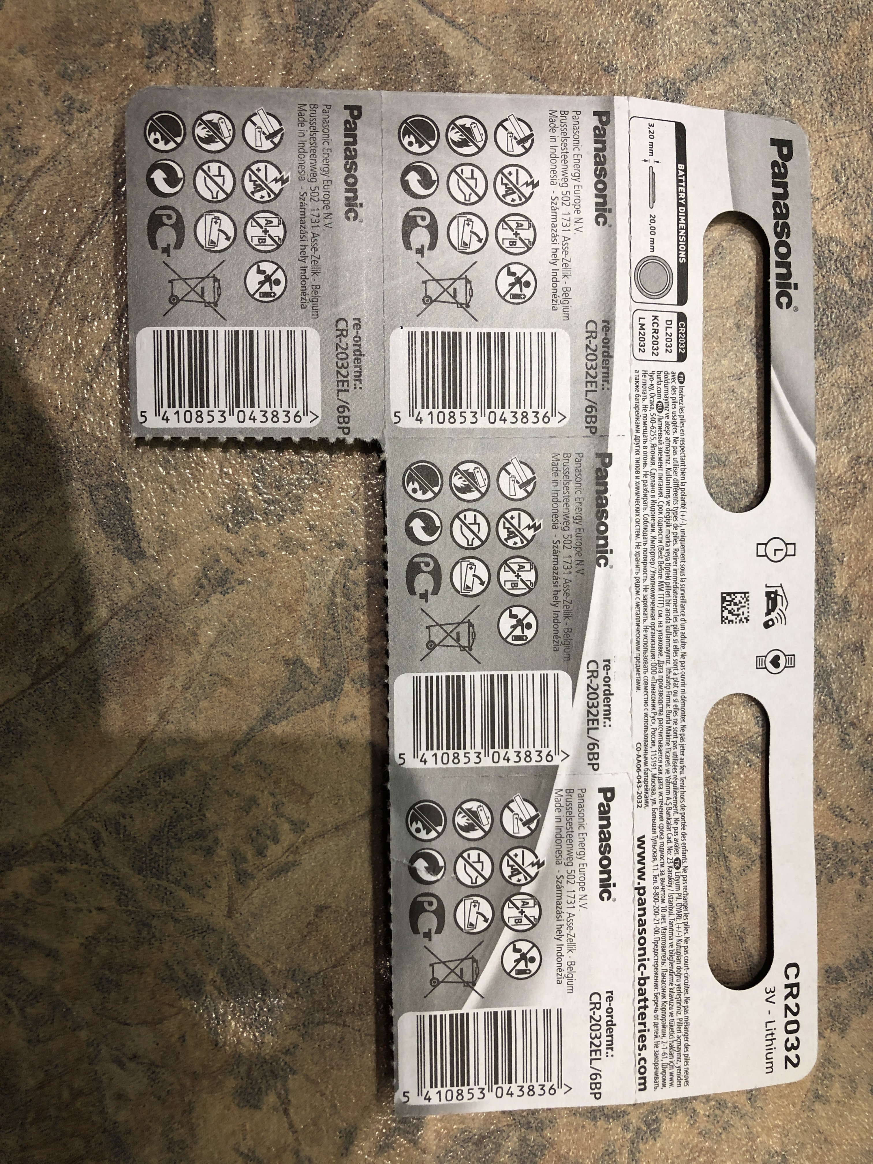

    Good evening peeps . . . . I have some very encouraging news. . .
    I arrived home earlier this afternoon and tried out the RS. I switched on the key and pressed “start”. As expected, she was dead to the world - nothing. Bike battery showing 12.78V.
    I took the key indoors, removed the backplate and with finger firmly pressed down onto the battery, tried again - same result - the bike was snoring like a trooper!
    On the way home, I stopped off and bought a pack of Energizer cells - having read a number of reviews, I wanted Duracell because they came out best but hey ho . . . . beggars can’t be choosers and they didn’t have any.
    I removed the battery and replaced it with a new “Energizer” and then checked the voltage of the battery I had just taken out - 3.01V.
    This is crazy when you consider it has been in standby perhaps a total of ten minutes and has activated the fob LED maybe 4-5 times in total and yet, the battery has lost volts from its original 3.24v - a sure sign that something isn’t right.
    Before installing, the new battery was checked and found to be 3.31V and so, out to the garage I went again. I switched the bike on and off maybe 10 times and not one issue. Now. . . Bear in mind, I didn’t tweak the contacts or do anything more than simply switch out the battery.
    My current thoughts are that the batteries I had been using are fake and when under only a small load, will lose volts sufficiently so that the key fob simply fails to respond to the bike. On reflection, this supports some other observations I have made over the last 12 months - namely, I have put brand new CR2032s in my kitchen scales and my digital torque wrenches and both have shown the “half battery” symbol in a very short period of time but I simply hadn’t twigged. I just assumed they were battery-hungry devices or the indication was wrong.
    As an afterthought, I decided to measure the thickness of the old batteries but not wanting to short them with my digital calipers, I measured two at a time - negative to negative and with the calipers pressed onto each of the positive faces. The new batteries were 6.39-6.41mm and the old (“Panasonic”) batteries 6.27mm and so they weren’t even the right size - yet another pointer perhaps?
    OK - so there is another possibility - manufacturing tolerances could mean these things are not all 3.2mm +\- 0.001mm thick and could legitimately vary by the amount I found and the drop in voltage and loss of key function could be due to an internal short in the key which is thus causing the battery to drain over time. We will know in 2-3 weeks when I test the key again - meanwhile I have switched it off as before.
    My money is full square on the following and my personal prejudice dictates I have already made up my mind. . . .
    1. The battery contact arrangement is less than ideal and it wouldn’t hurt to at least ensure the contacts are adjusted adequately but this is not actually the problem. At least not in my case
    2. The main issue is caused by the supply of cheap, fake 2032s being sold through Amazon and on eBay - I’m now absolutely convinced and I would recommend only buying best brand batteries but more importantly from a major bricks and mortar retailer such as B&Q, Tesco or Boots etc. Buy your batteries from “Happy Bingo Batteries” on eBay and it seems you’re asking for trouble.
    These are the offending little turds!!!!

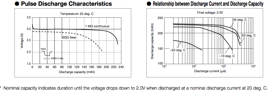

  20. xorbe
    xorbe First Class Member
    Jan 27, 2021
    297
    663
    CA, USA
    #80 xorbe, Nov 30, 2021
    Lithium batteries have a head charge that dips quickly from the peak voltage, then they hold a nominal voltage for a looong time, and then crater after that. So 3.01V is not unusual, as it is advertised as a 3V nominal battery. You kinda have to measure the voltage under nominal load, as an idle battery will often misleadingly recover to a good looking voltage (but have no juice to back it up). Dead is around 2.8V for a button battery, not much left after that.
