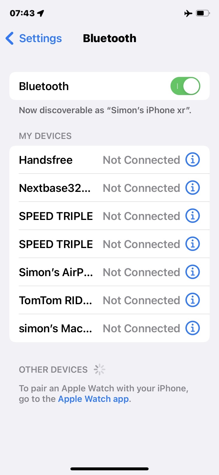

    Hi there!
    Yes, there are definitely 2 separate Bluetooth connections for an iPhone. As you say, android is only one (and way easier!)
    Unfortunately, they are both known as speed triple as default.

    I've got an iphone xr and 12 pro max and they are both on the latest sw. You really do have to keep trying AND make sure that my triumph app has access to bluetooth in settings (goto settings and scroll down to my triumph app and turn ON bluetooth. It doesn't come on by itself.
    If it doesn’t work, delete the connection on the phone and bike and then start again.
    Also, add the bike via the "add via Bluetooth " option in the app. If you enter it via vin, it doesn’t work (so he said)!!
