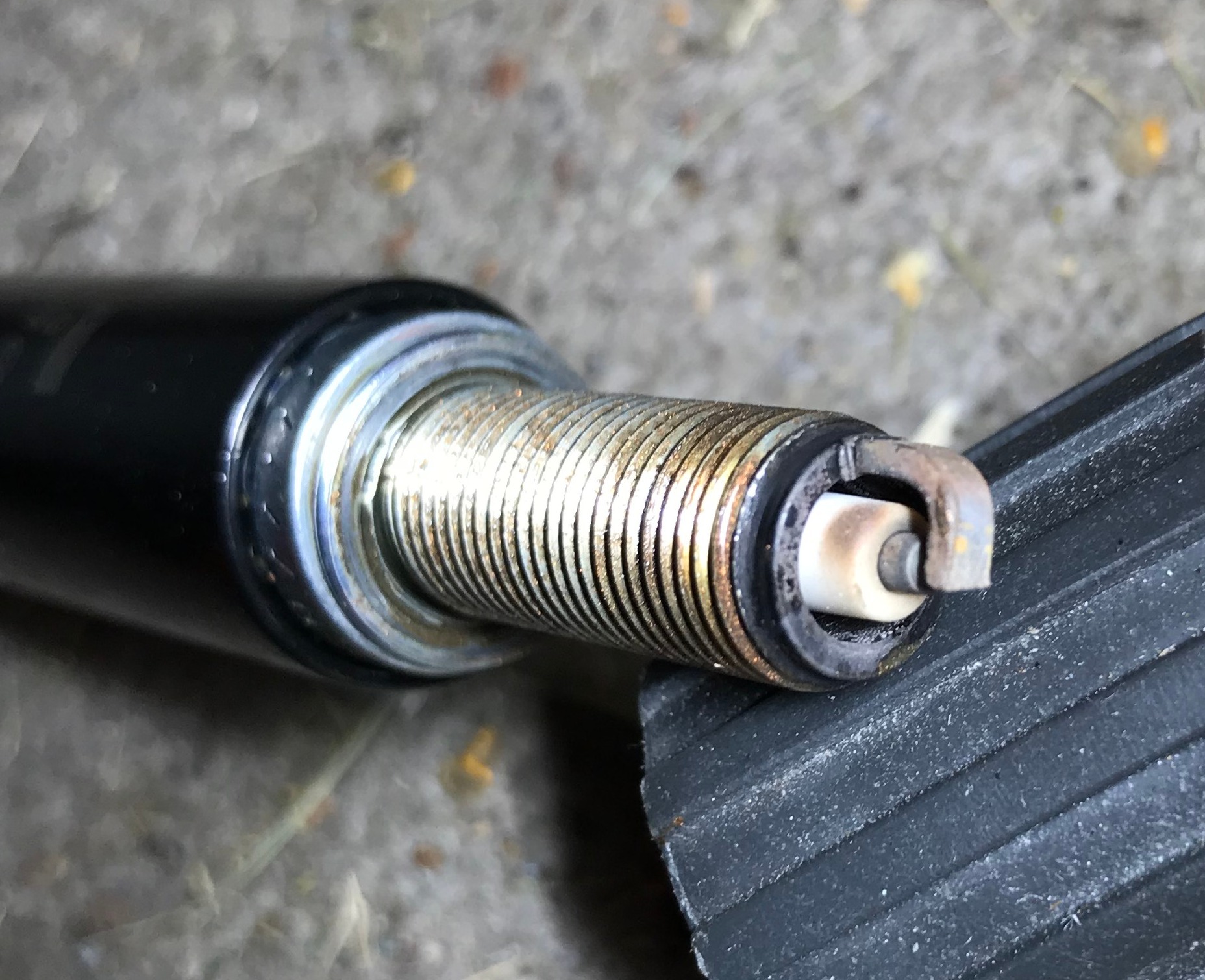

    Hey team, you thoughts on my sprakplug condition... lean or just right ?
    2018 t120 with x-pipe, aftermarket mufflers + K&N air filter.
    If on the lean side, thinking of adding a booster plug to my farkles
    how say you experts ?

    That looks normal to me, modern engines are designed to run very lean compared to years ago when carbs were the norm and not all the electronically managed jiggery pokery.
    I checked the plugs on my Z at 20k and they looked hardly used.

    I shall share a n important piece of information....
    The workshop manual says the ECM re-learns (Engine adaption) & air/fuel etc adjusts automatically for additions (de-cat/x-pipe, after market mufflers + K&N air filter) so happy days..
    My sparkplug is a prime example of what sparkplugs should look like.

    Only within certain parameters. I've fitted a "fuel booster" plug to my standard Street Scrambler. I did this to see if it would cure an intermittent hot engine stall when pulling away from idle and it has.

    This is good to know... I tried a 'Booster plug' prior to adding a K&N air filter yesterday (to try & fix a snatchy low speed throttle) but didn't make any difference ... funny enough.. the K&N air filter did.
    p.s. I don't have any stalling probs

    looks good to me

    My T120 has decat, remus pipes no baffles, k&n filter. Fitted a booster plug, all good.
