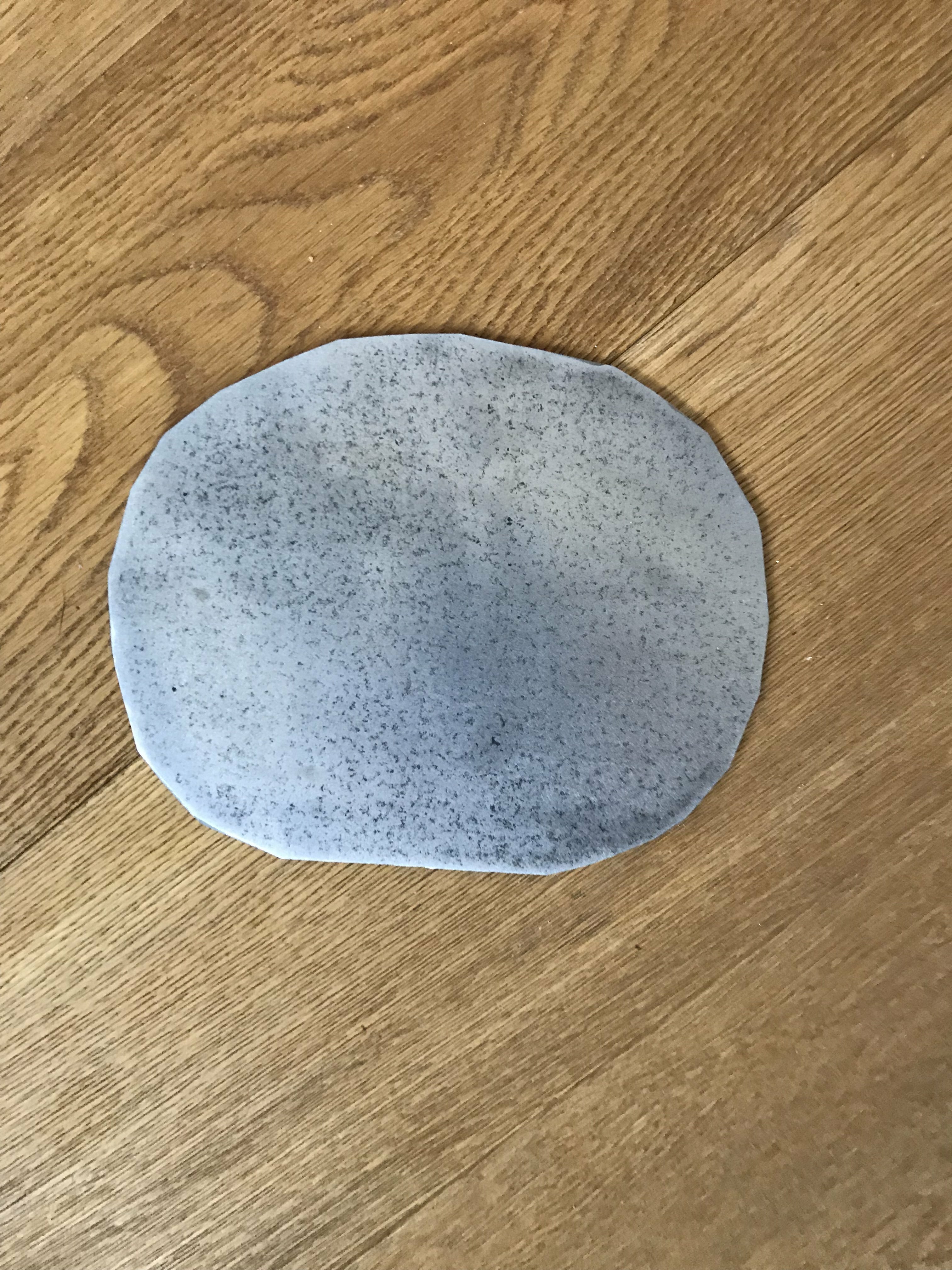

    This is gonna be the back rest support :)
    Need to find some bar for the sissy bar bit :confused: 9F1D33BE-EE9A-4B5B-AA44-AC16175A483E.jpeg

  10. TEZ 217
    3,922
    3,153
    One picture of a rusty bit of metal, that it like !!! we've been waiting patiently, :rolleyes:
    Remember to take it off that chair when you cut it out, otherwise you'll end up with a commode chair :D:D
    #70

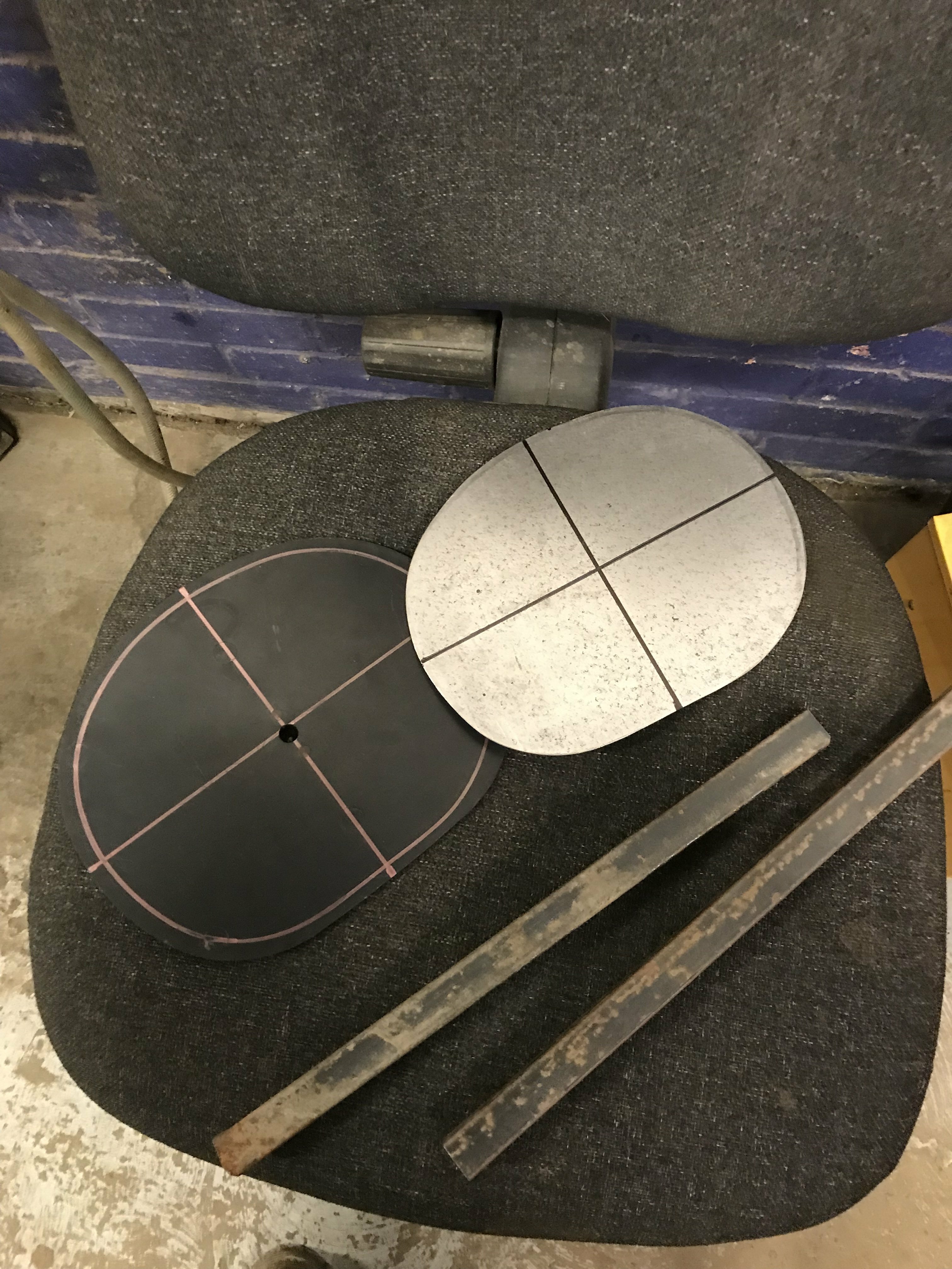

  12. dilligaf
    Brought it home and used my new angle grinder to cut it out and I used a orbital sander on one side :)
    Take it to work tomorrow and use the bench grinder and finish it off with a file :) EF35E245-2DAB-4077-9602-BA24FA54D076.jpeg still haven’t found any suitable bar for it but I’ve got plenty to do to it in the meantime :confused:

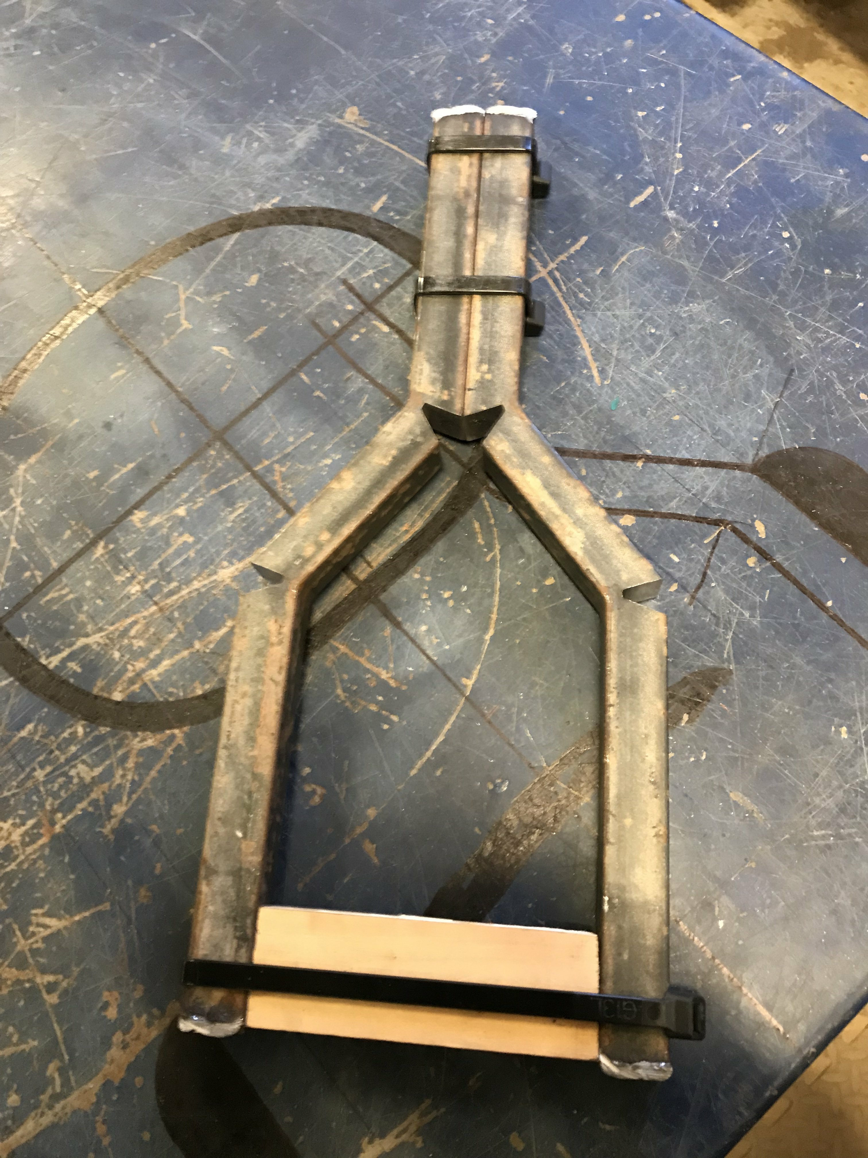

  15. dilligaf
    Tack welded the two sissy bars together and did some cutting and bending :)
    Happy with the shape :)
    Now gotta separate them and fill in the cuts :confused: 9EAA7D07-CD81-45BB-AAFC-4B379E94569F.jpeg still loads of grinding and filing to get the finish I’m after :(

  17. dilligaf
    All strapped up hopefully to stop any heat distortion while I weld up the cuts :confused: E342F3EB-FBD6-43F7-ABEF-7F51C051EB0F.jpeg
    #77
  18. TEZ 217
    3,922
    3,153
    Tie wraps :mad: not sure marra too much heat swap out for metal binding/clamps or bolts.

  19. dilligaf
    :) All done mate :cool:
    Slow and steady with no distortion :)
    :( Loads of grinding and filing to do now:(
