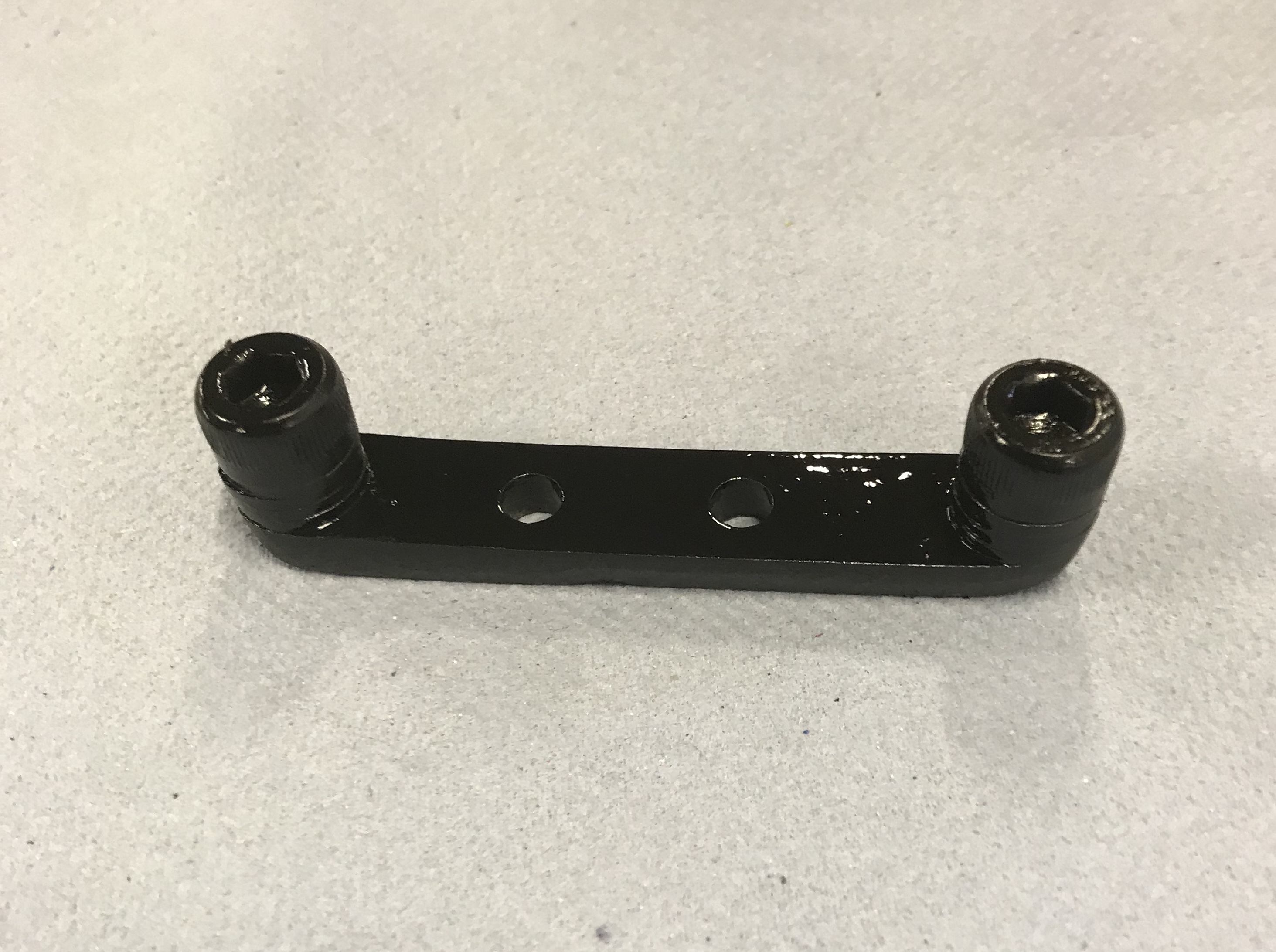

    :):) At last I’ve made some progress :grinning:
    Using the bolt holes that the original fanny pad uses I’ve attached two rubber feet from a stihl saw:)
    The holes are a perfect fit for the head of a 8mm Allen head bolt :)
    Gonna drill and tap the bar to take the Allen bolts and cut and grind it to size :)

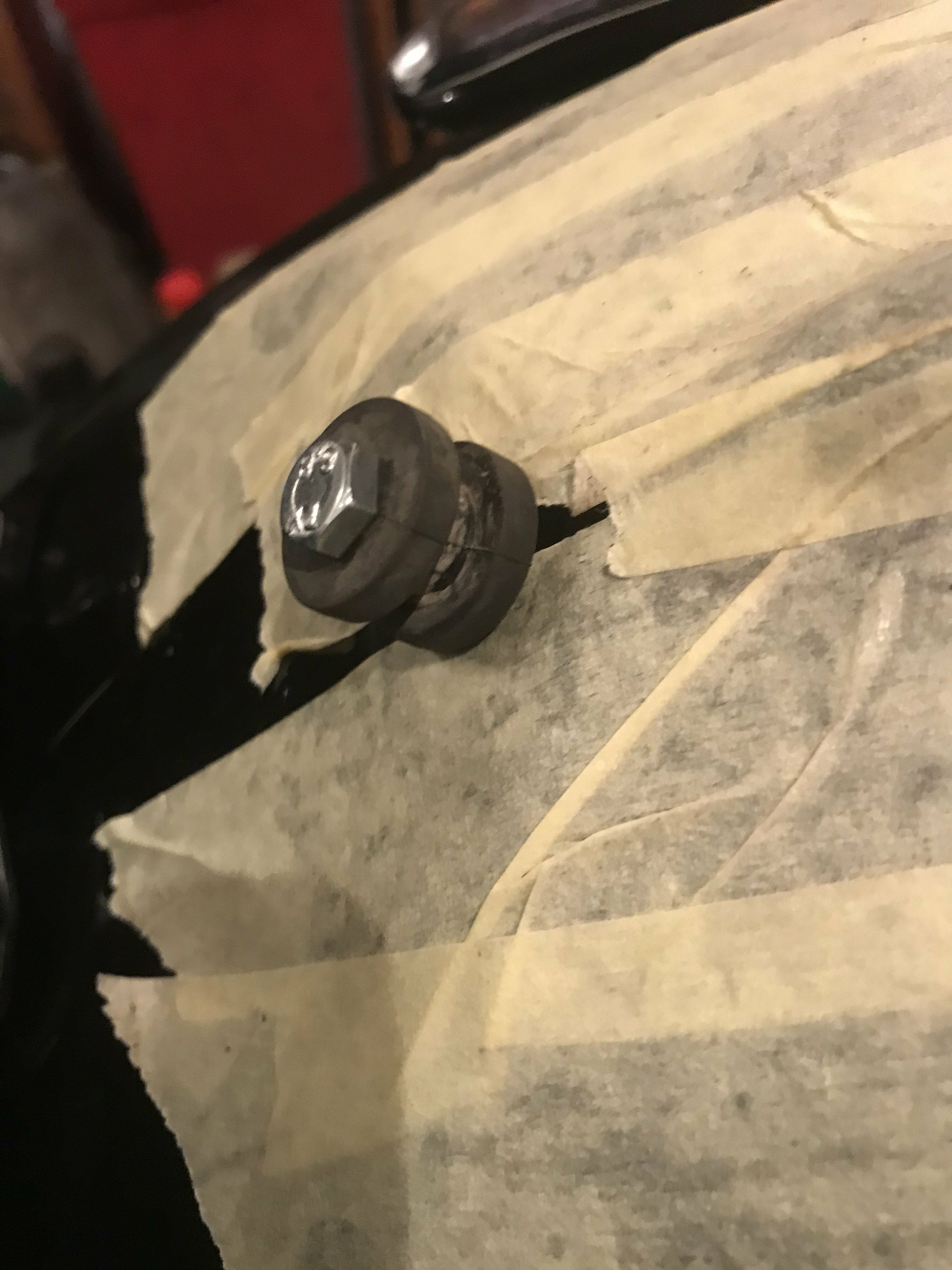

    Then it’ll be attached to the under side of the new seat and that’s the position sorted :) 5D417A71-FED7-4F8E-9BE4-1ED7424EE20B.jpeg the front seat locator has been removed and swapped for this rubber mount :) it has a metal sleeve in the middle so it’s locked in place :)
    I’ve attached a type of bungee on the underneath of the seat and it locks the seat up against the back of the riders seat :) the locators will stop it pulling in too hard :p 37E92883-7CD4-40C9-A935-8C1EF1914C3B.jpeg

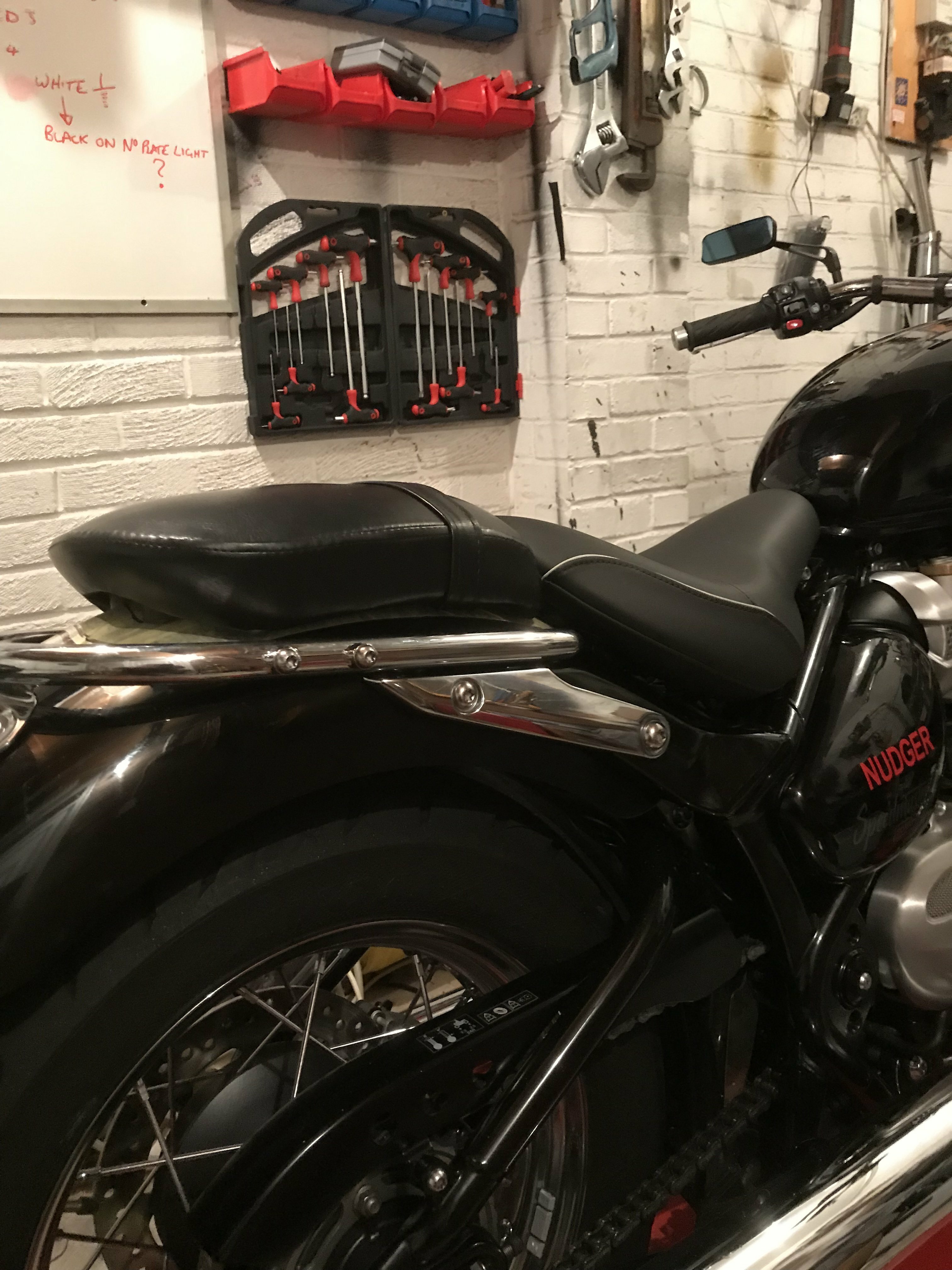

    :grinning: Well that went well :grinning:
    Some minor adjustments and some rubber pads fixed on with double sided tape and that’s it a pillion seat for £35:p E0C42A6E-0E27-4910-A3DA-973F5A59D689.jpeg 8E142598-39B0-4E43-B09A-ECF1230F2824.jpeg

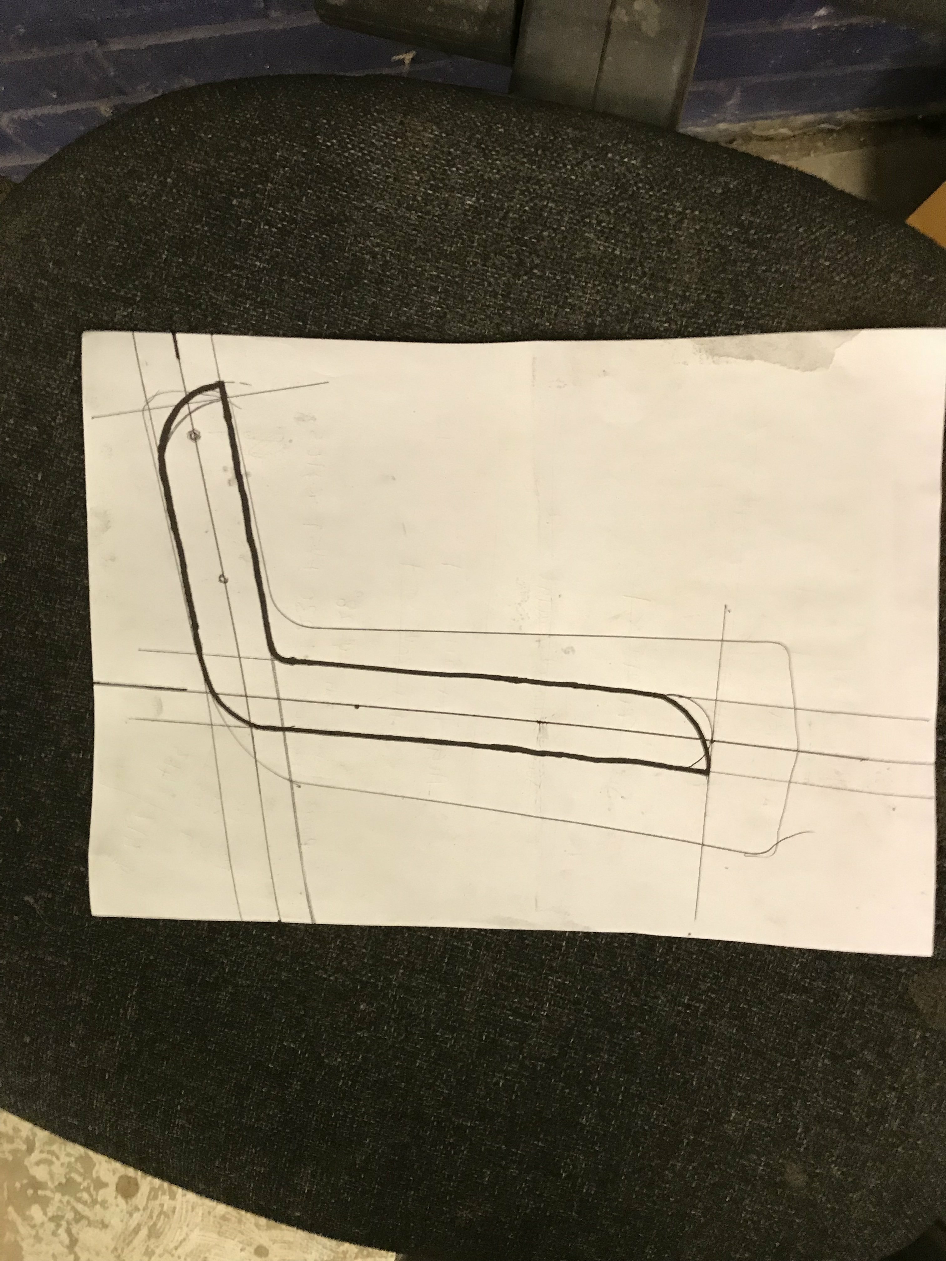

  10. dilligaf

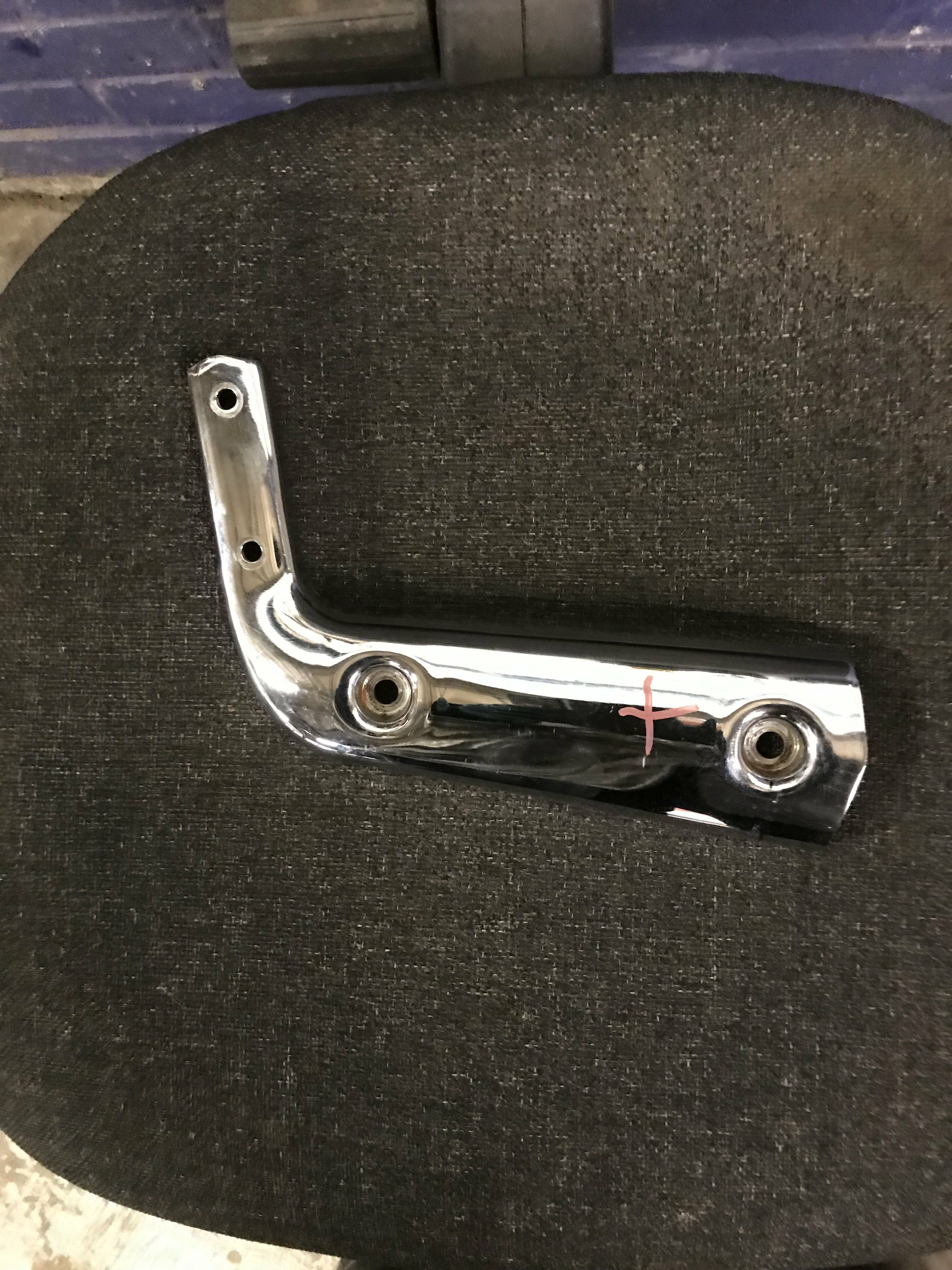

    Using this as a guide/template to start making the backrest/sissy bar :)
    Can’t use it on NUDGER as the holes don’t line up :confused: DABE24B4-FDF3-4D7C-9127-79AAEF442AF4.jpeg

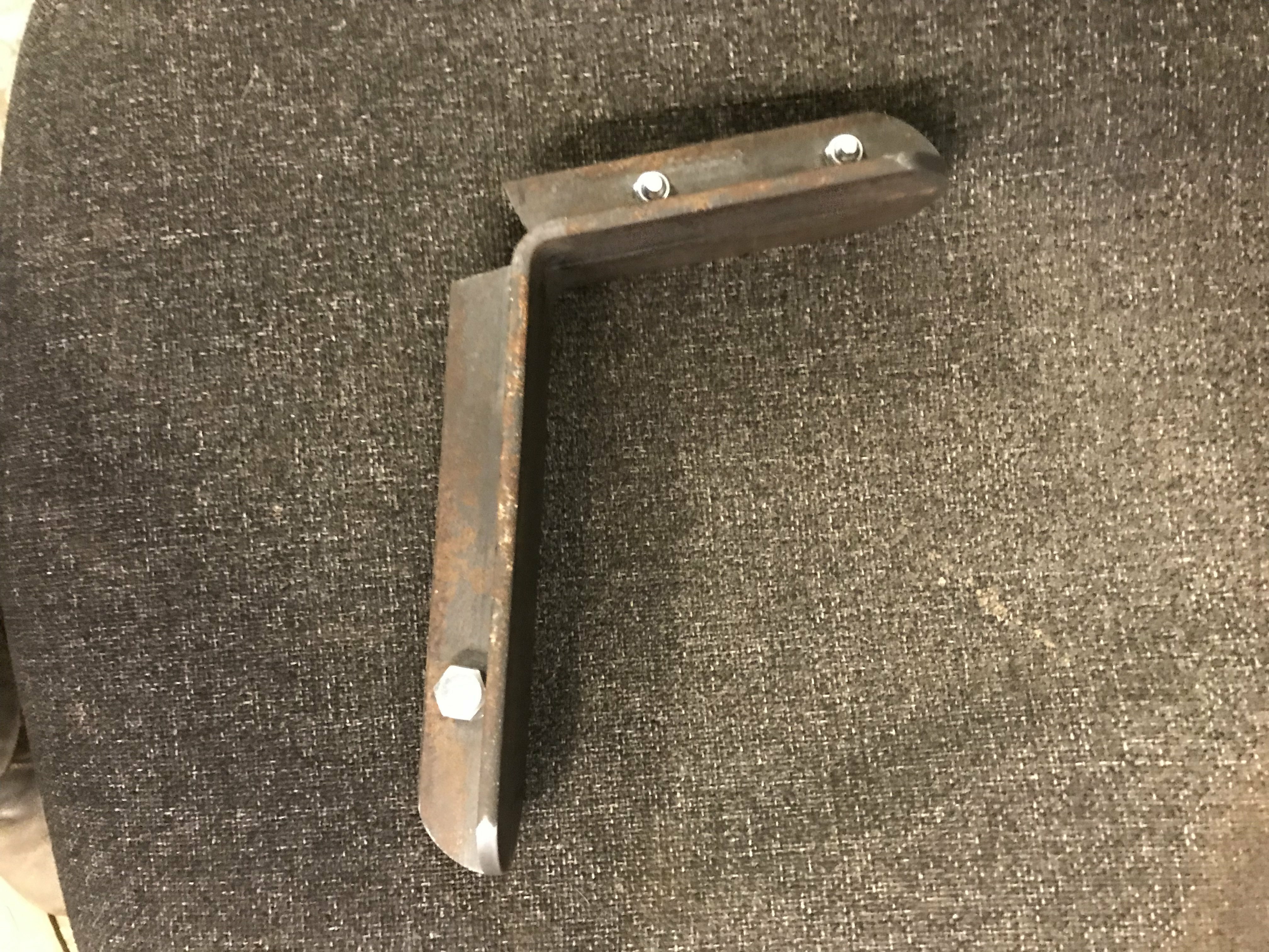

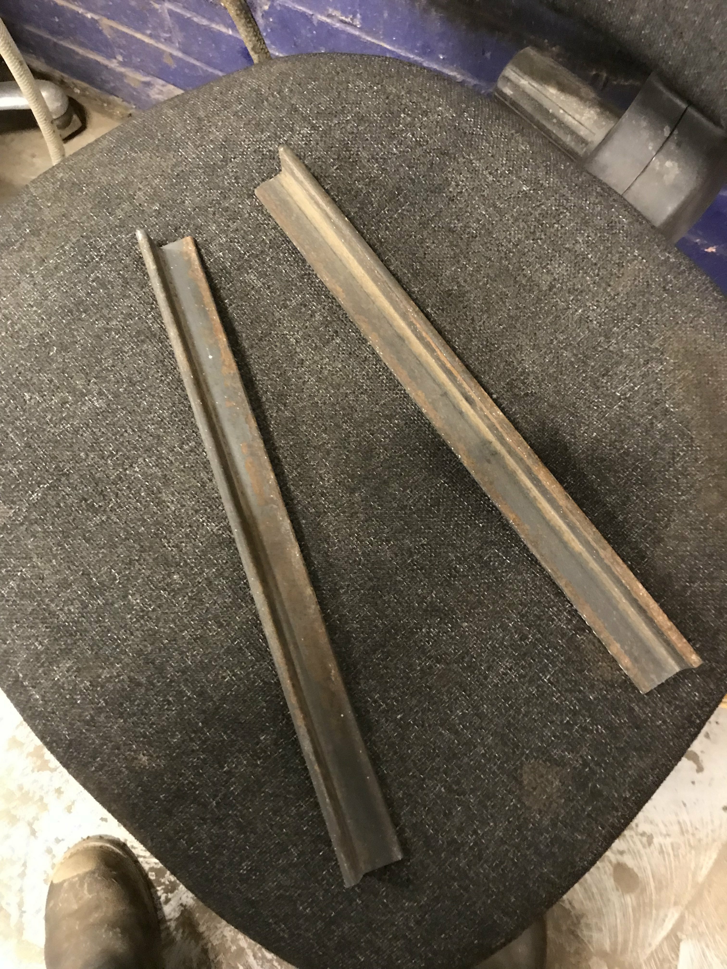

  11. dilligaf
    Two bits of angle iron cut oversize for the time being :) FFBD53B8-62C4-4105-B13B-14024F173E0C.jpeg

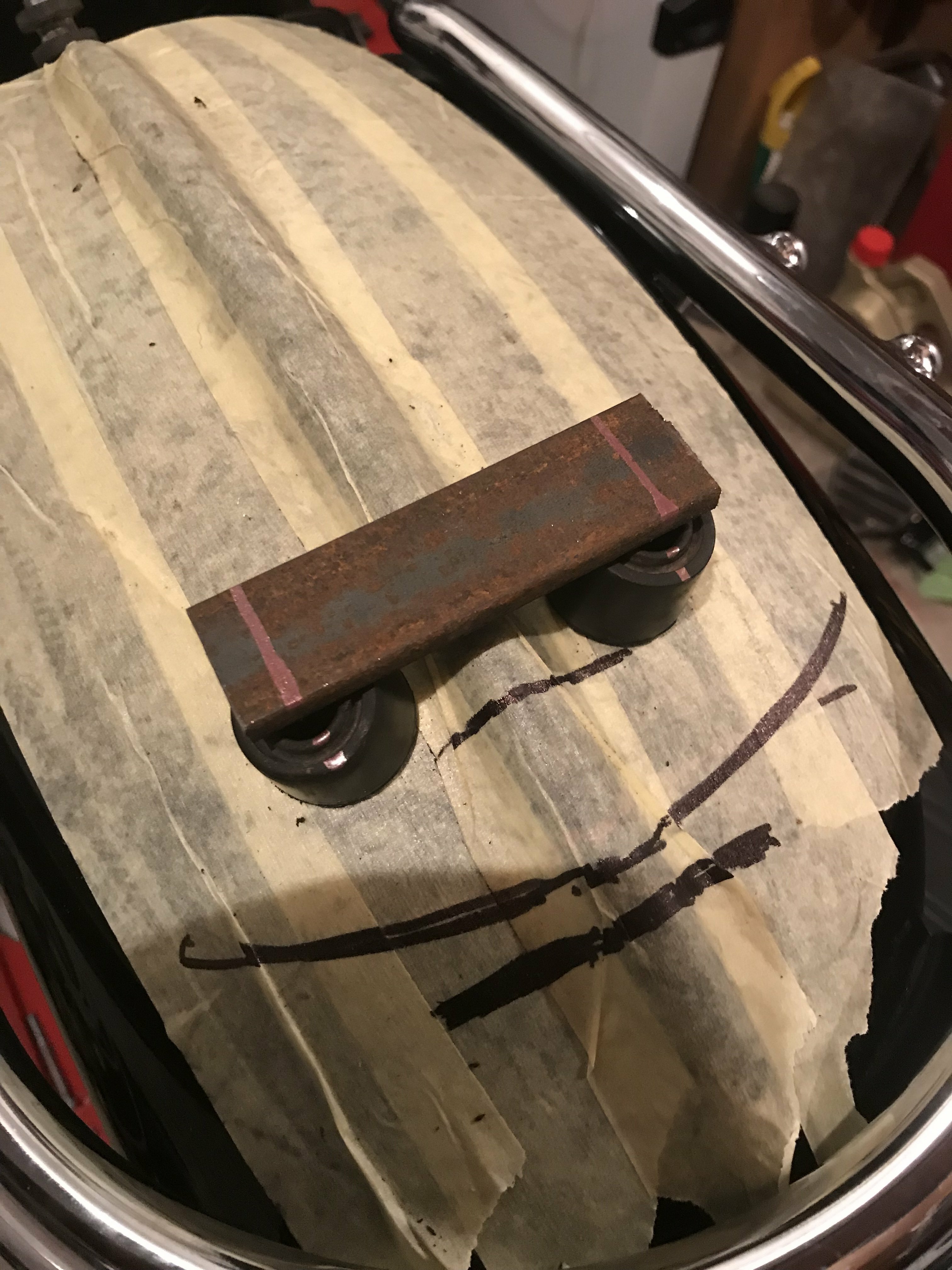

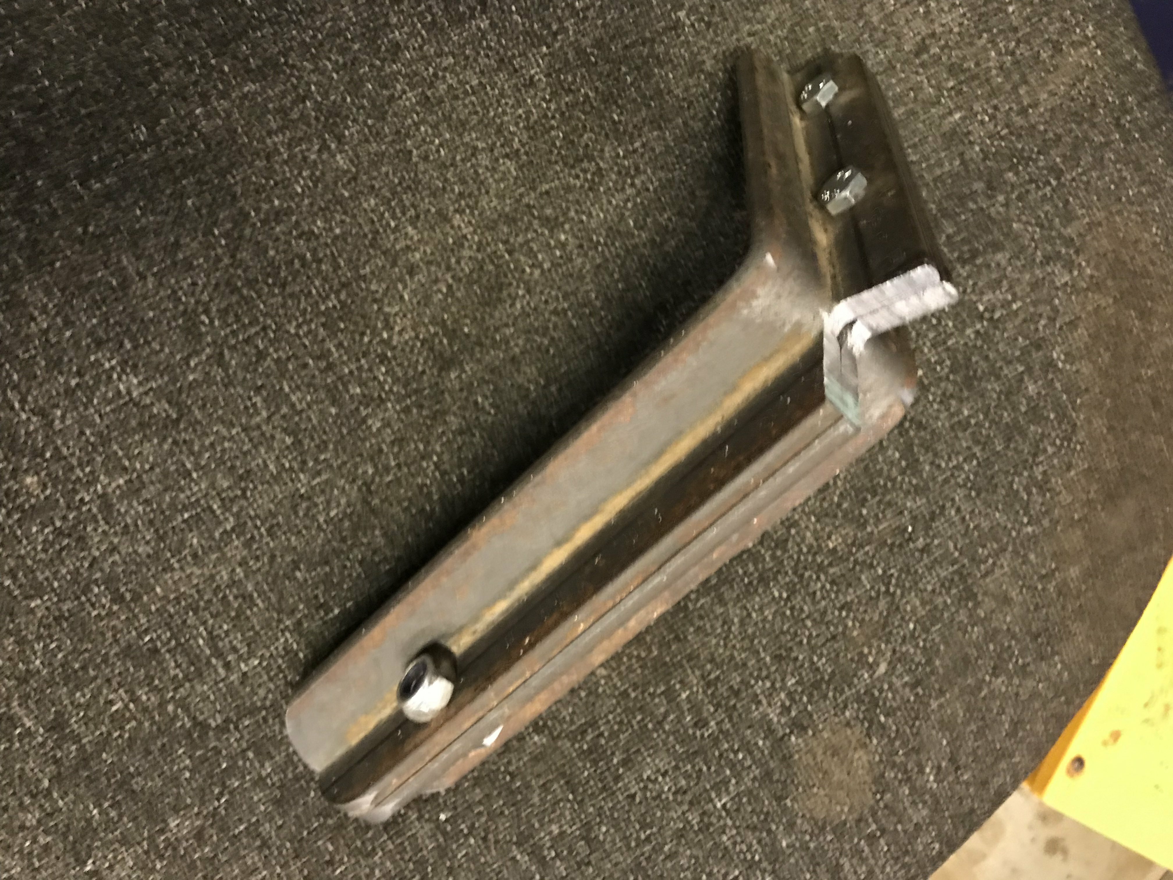

  12. dilligaf
    :) Got the template done...lots of cutting/grinding and filing to do :confused: 11506969-8751-430D-A687-0F0988DB6DDA.jpeg

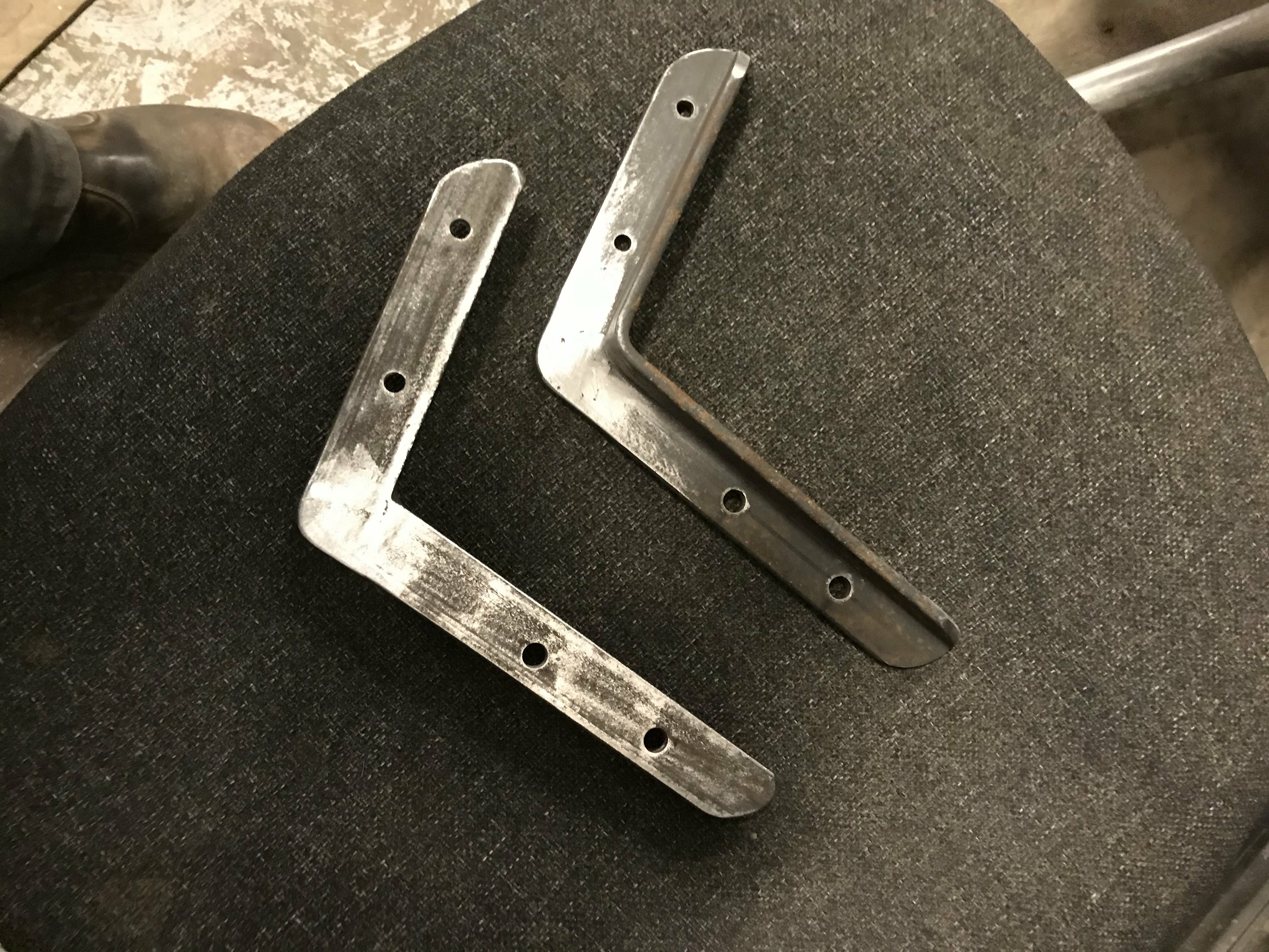

  14. dilligaf
    :) So far so good :cool: E9193909-3F6E-4D24-A1B1-E72CA89EA412.jpeg 07348C65-67C4-4742-87F2-6B5FC6FC910A.jpeg

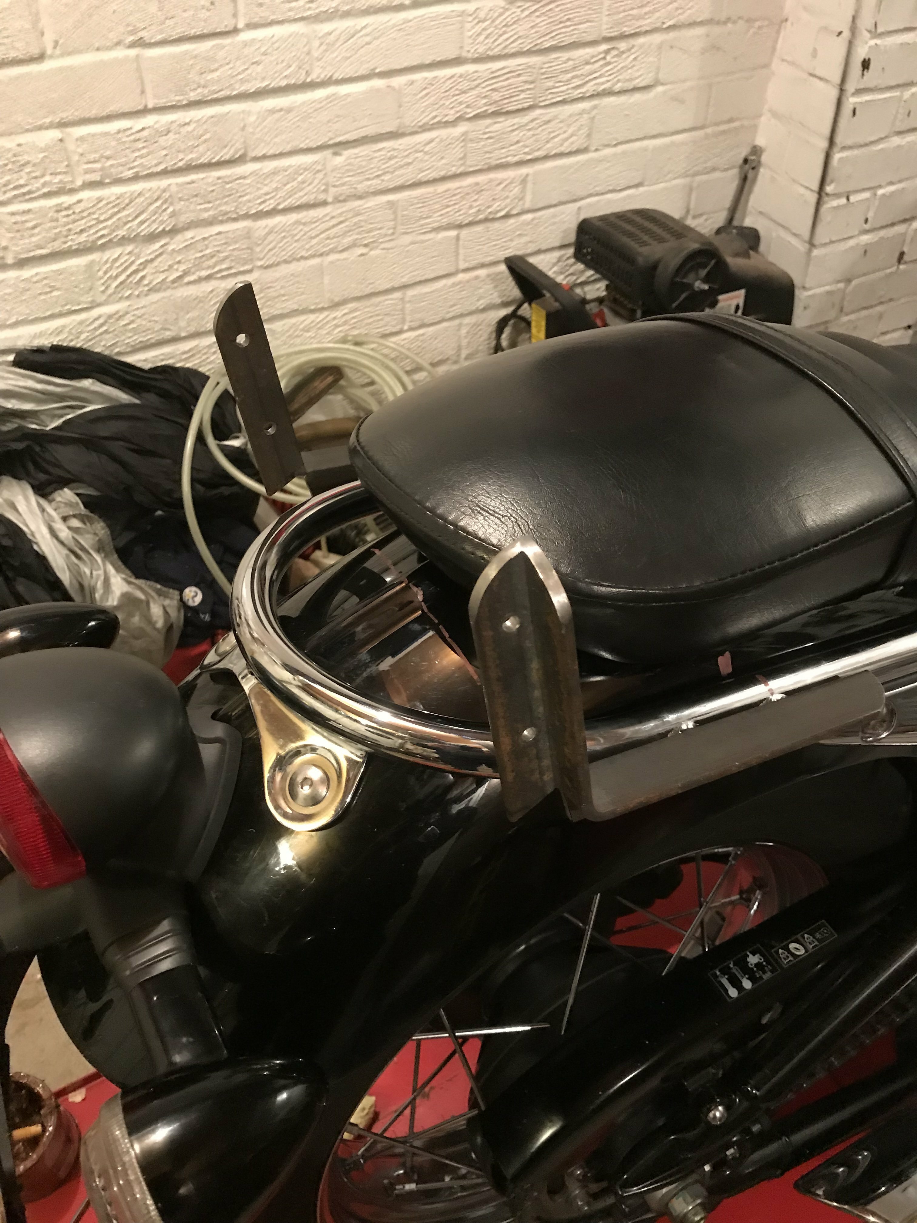

    The backrest arrived just before I left work :) C3CE2D47-81E8-4AC0-B971-1FFB34CF475F.jpeg

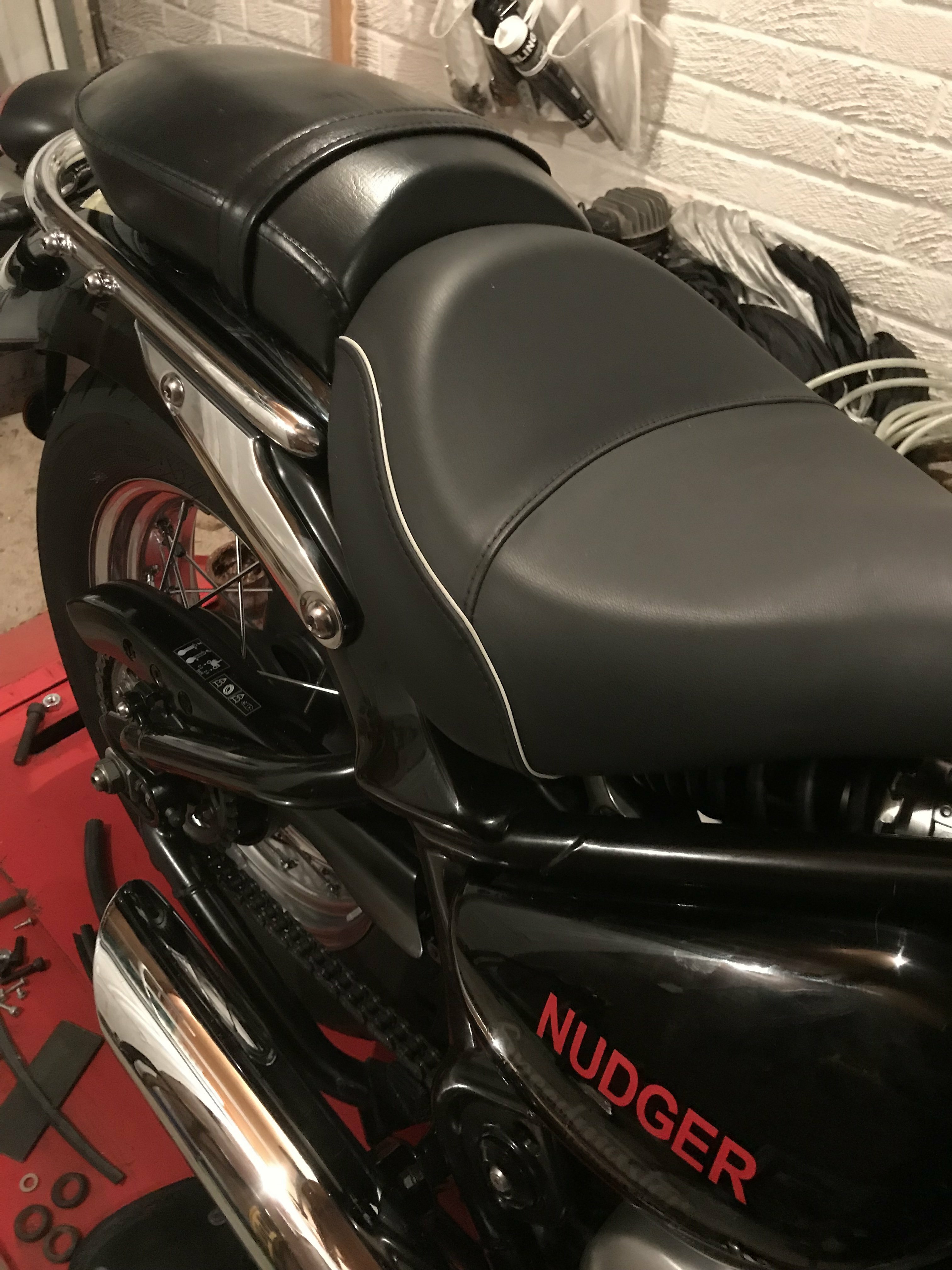

  20. dilligaf
    That’s them done :grinning: 5B7BFED2-ED04-4942-A293-53DFE42A3663.jpeg
