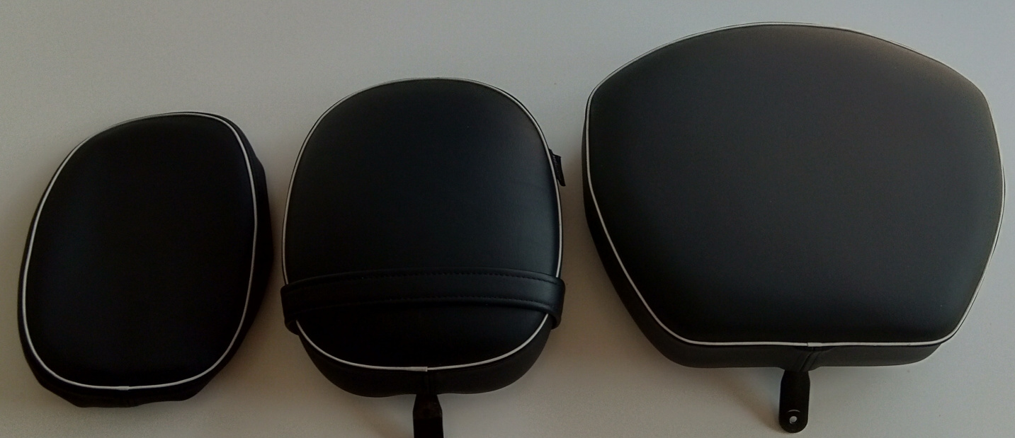

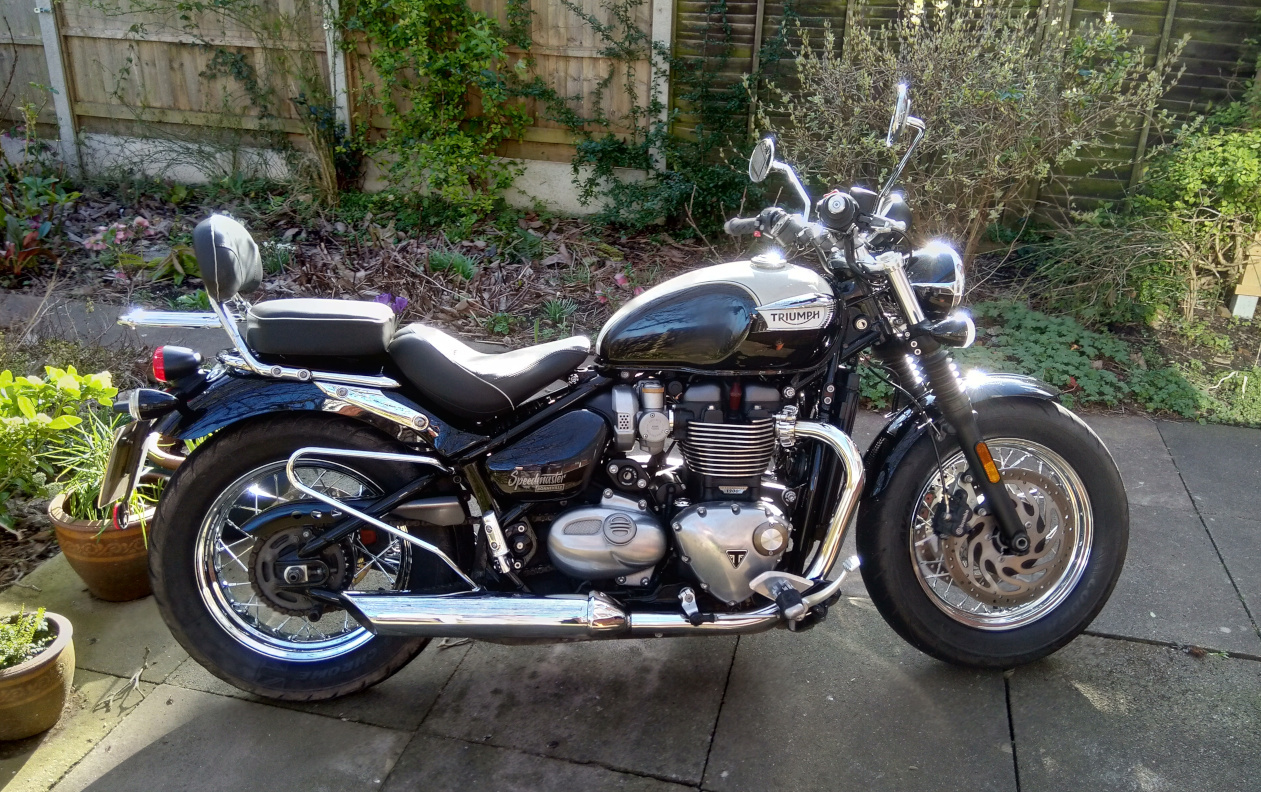

    So, after 4 attempts at making a final seat cover I finally have something I'm happy to call 'job done', I'm well chuffed :grinning::grinning::grinning:, and especially pleased with how the proportions complement my seat :grinning:.
    Family photo of baby seat, mummy seat and daddy seat (Stock seat, Triumph 'comfort seat', and brown mouse special).
    I found Triumph's 'comfort' seat whilst being 3cm wider than stock, still uses the same base pan, so has no more support in the width :(

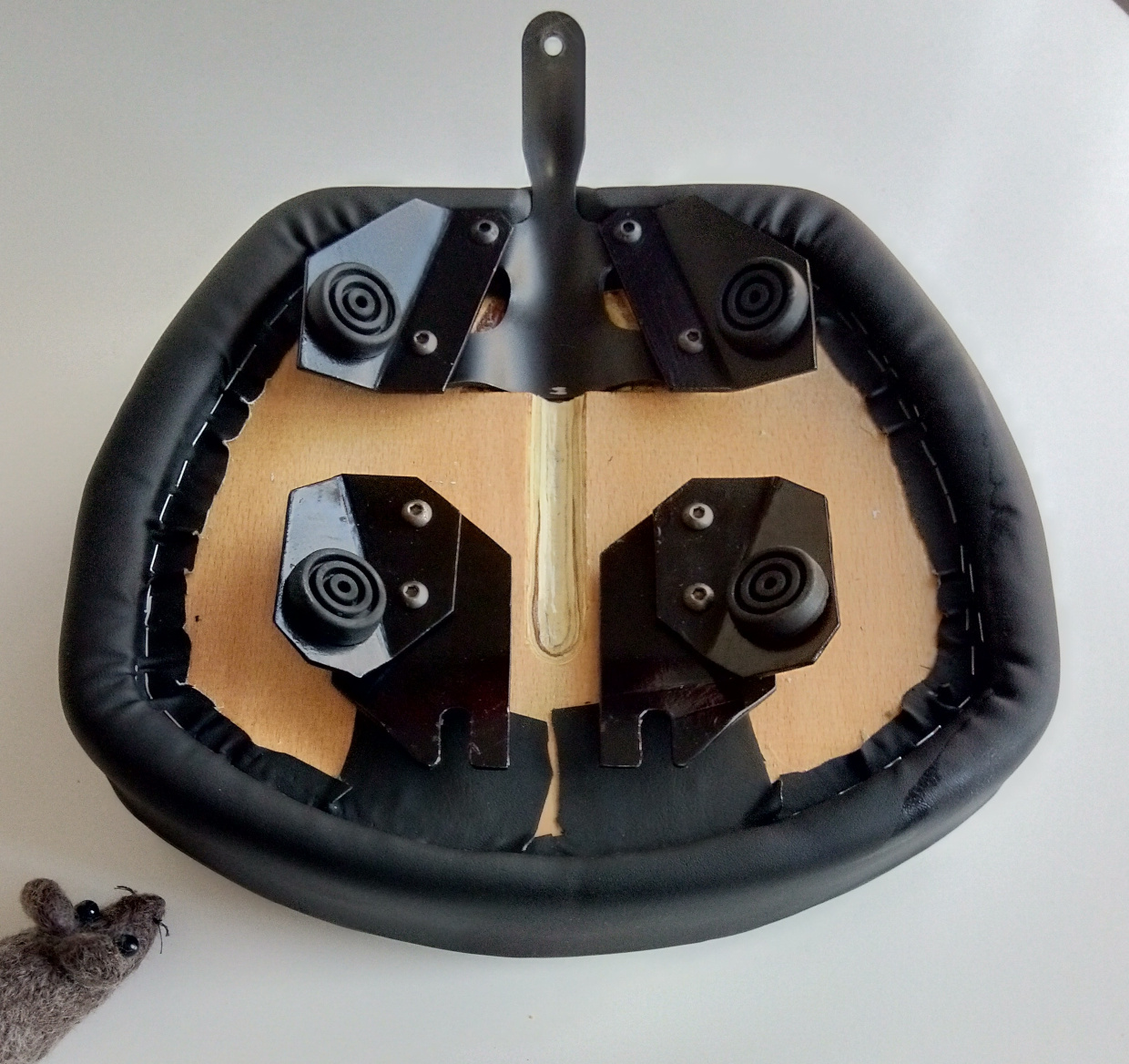

    For my final seat version the base was made from varnished ply and the brackets painted so they don't stand out when bike viewed from side...

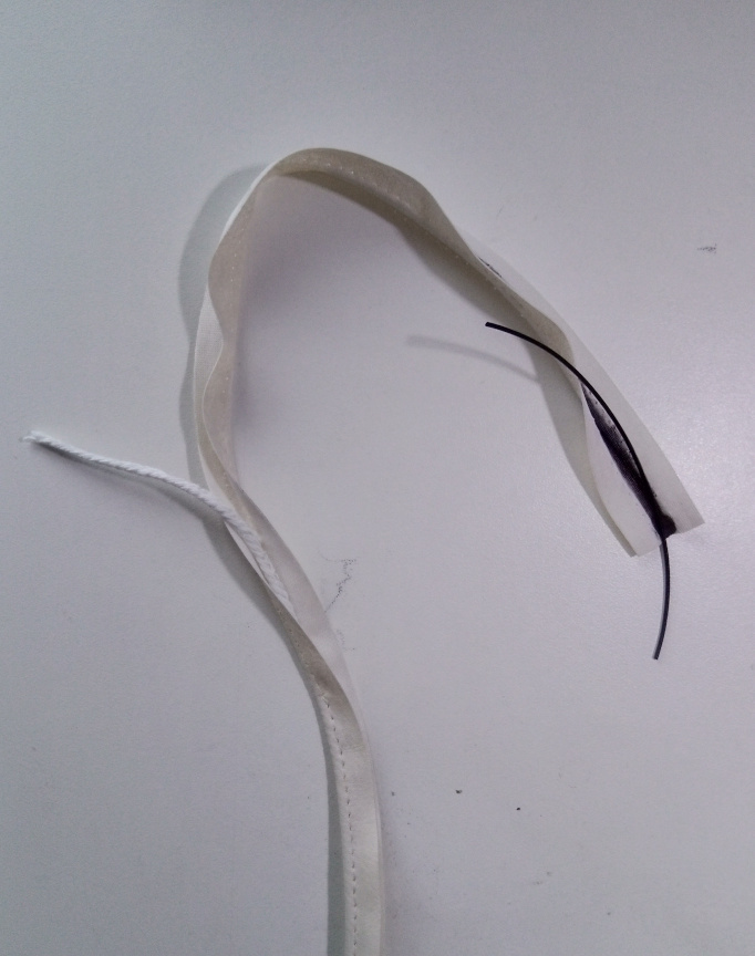

    The piping on the Triumph seats is light grey and very thin and I couldn't find anything close to buy, So I ended up taking apart some I bought and used a Sharpie on the inside to darken it, together with some thin black insulation from electrical wire, this ended up been a fair match.
