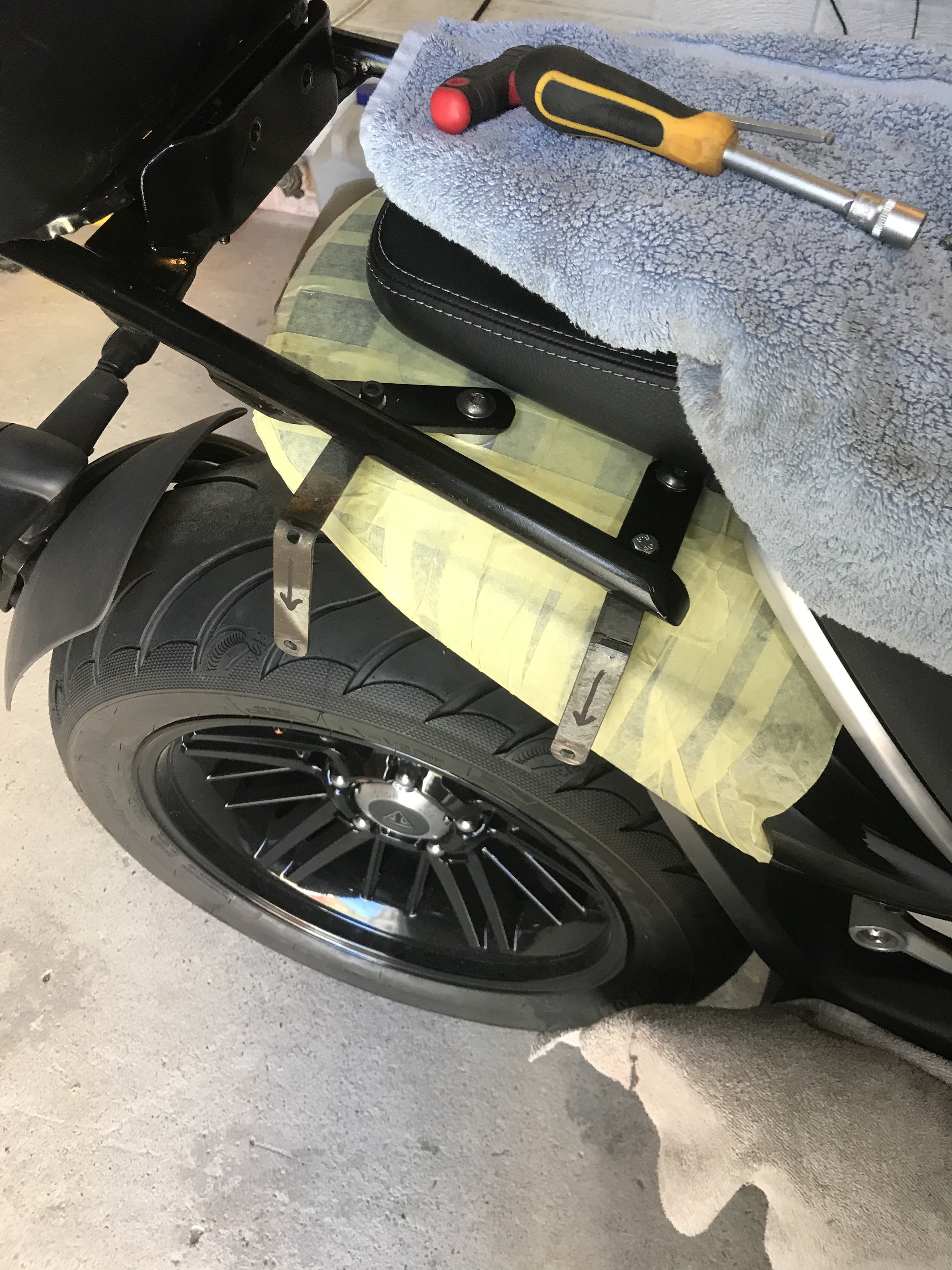

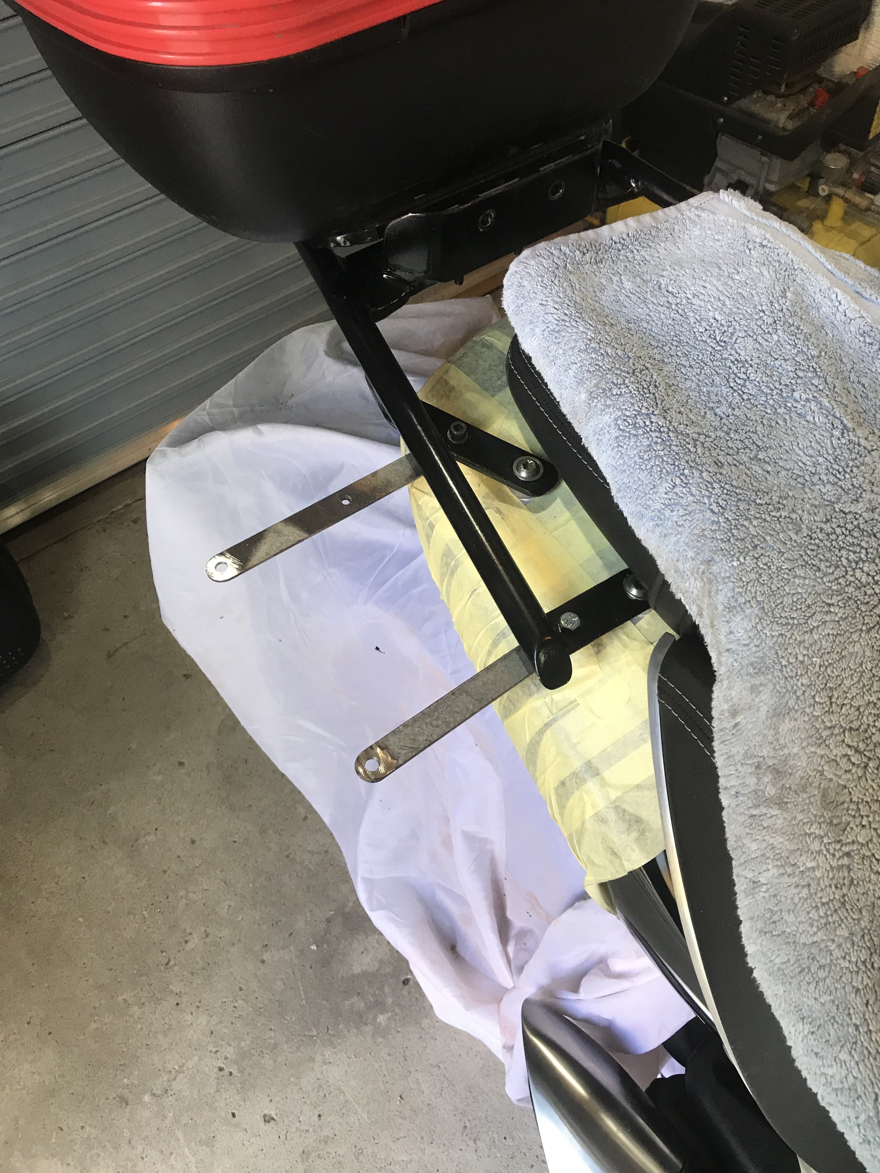

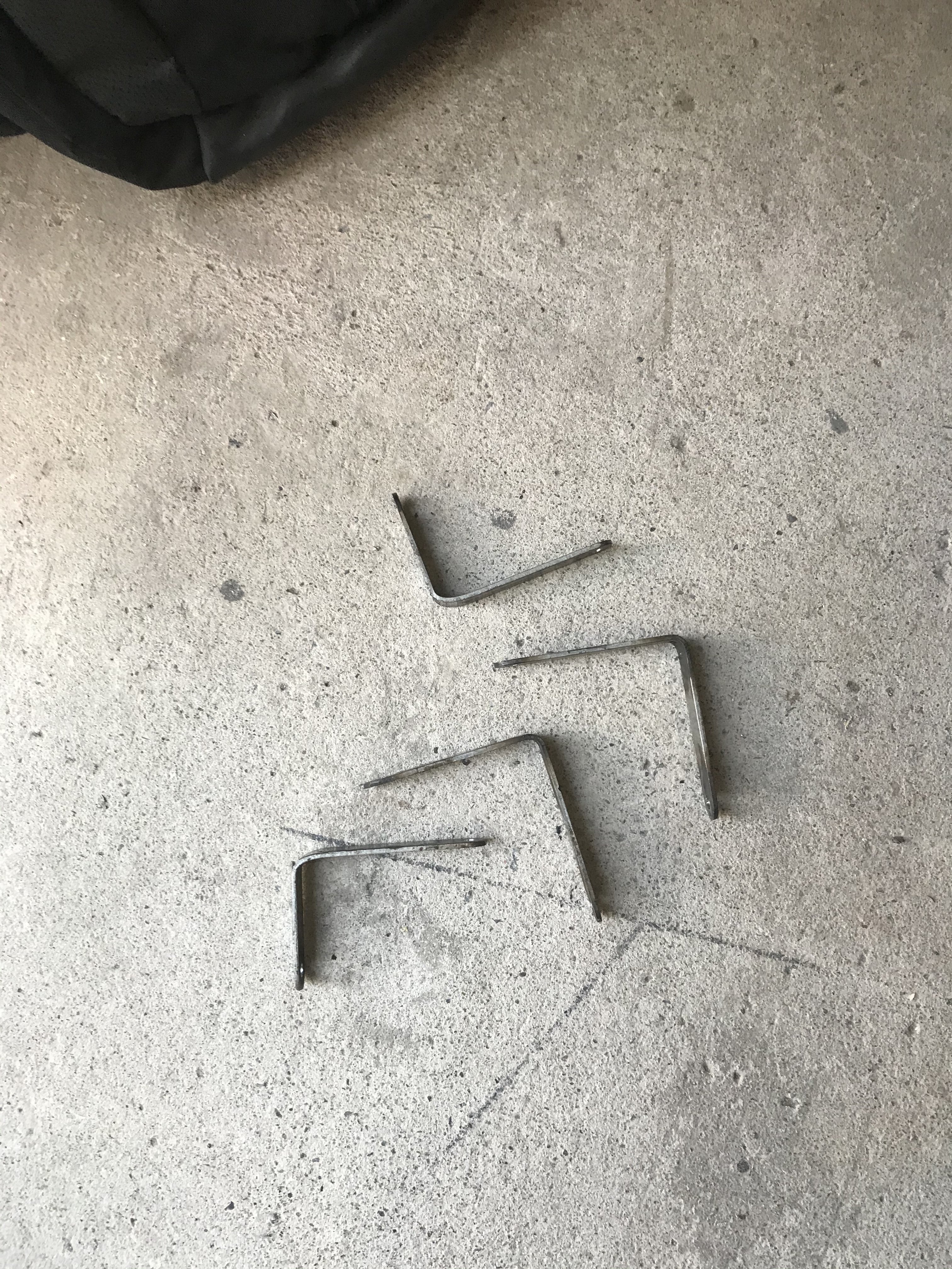

  4. dilligaf
    Measured then knocked into shape in the vice with a lump hammer :) F394D704-1CA0-4FD0-B89C-BB377521A500.jpeg Fitted to CERBERUS :cool:
    These are being done on both sides of the bike :) 0629F0D7-EB55-4968-B0C6-2B034A49B0BE.jpeg

    With the metal so thin - how are you going to stop pannier flex which may cause contact with the wheel on banking?
  7. dilligaf
    It’s not finished yet by a long shot :p

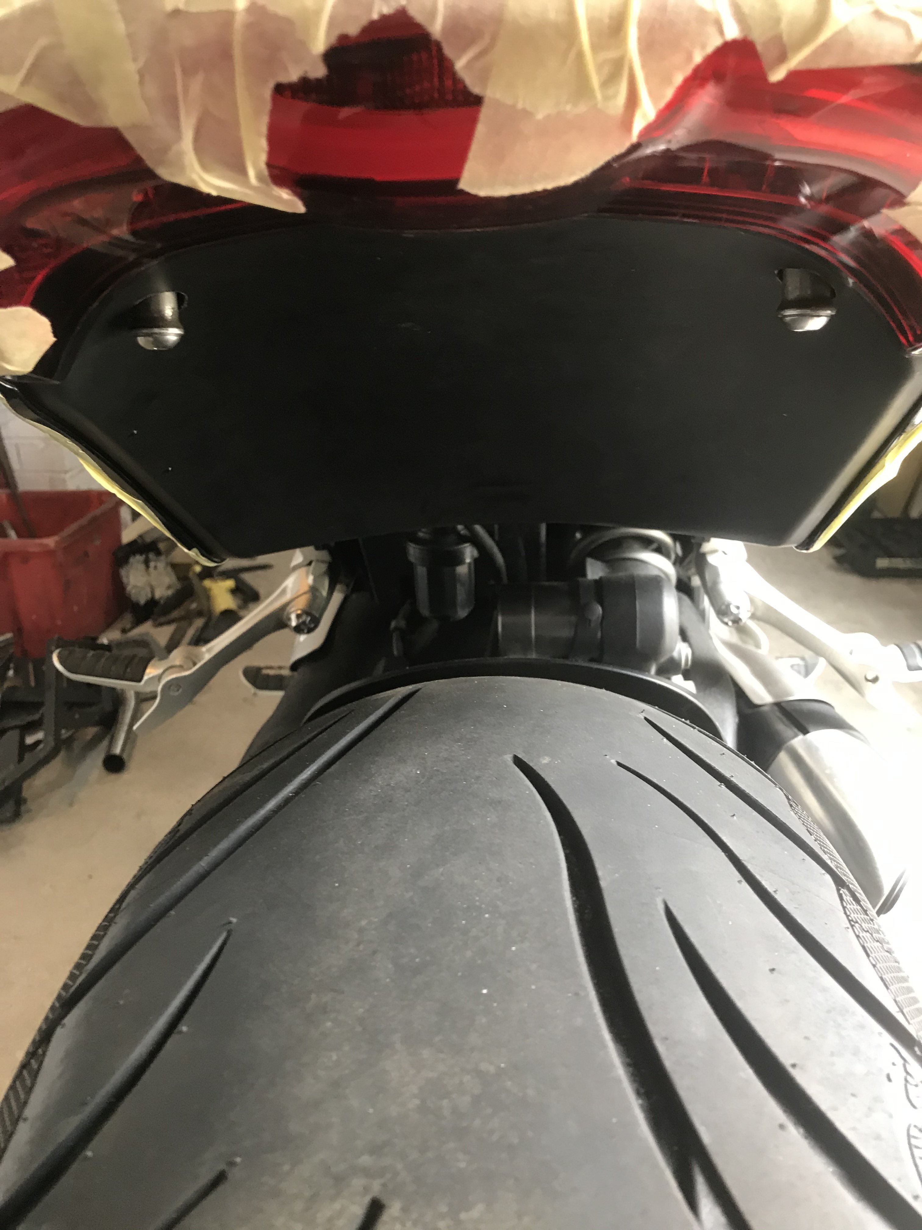

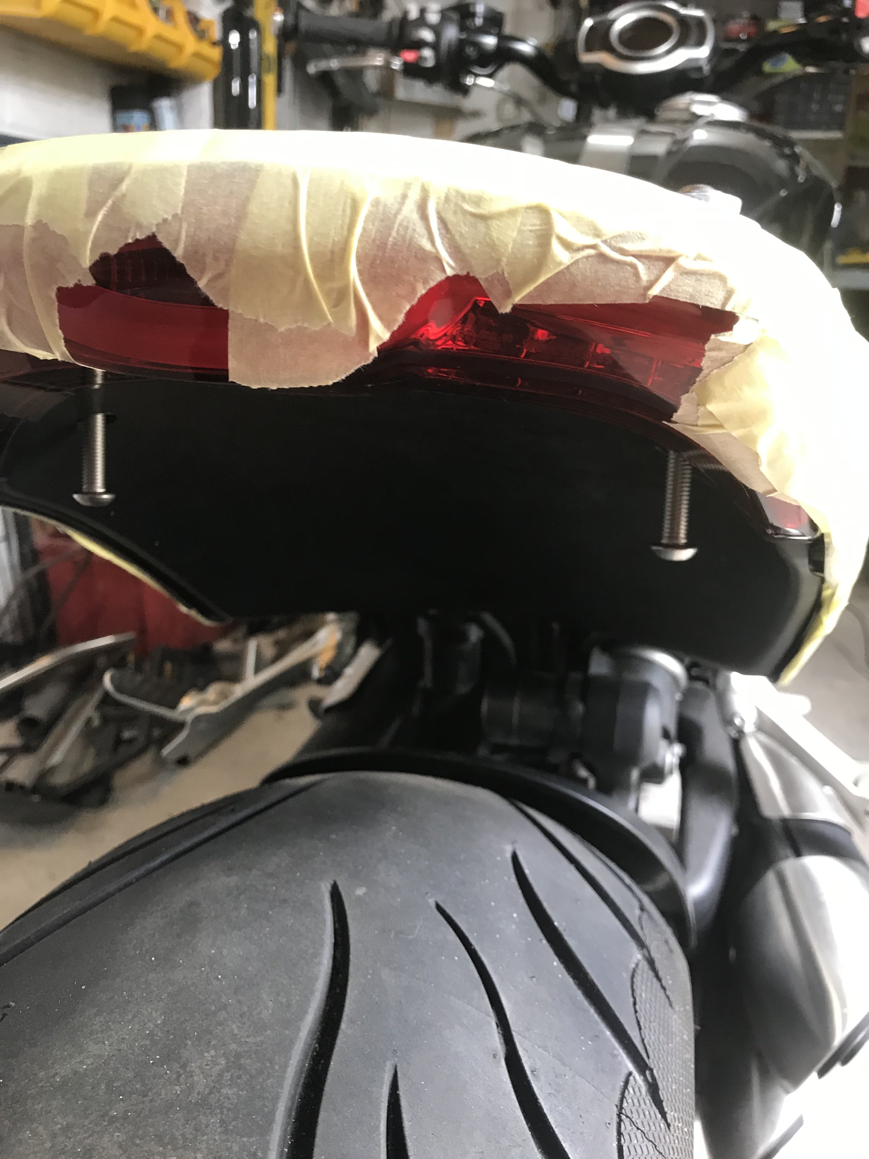

  12. dilligaf

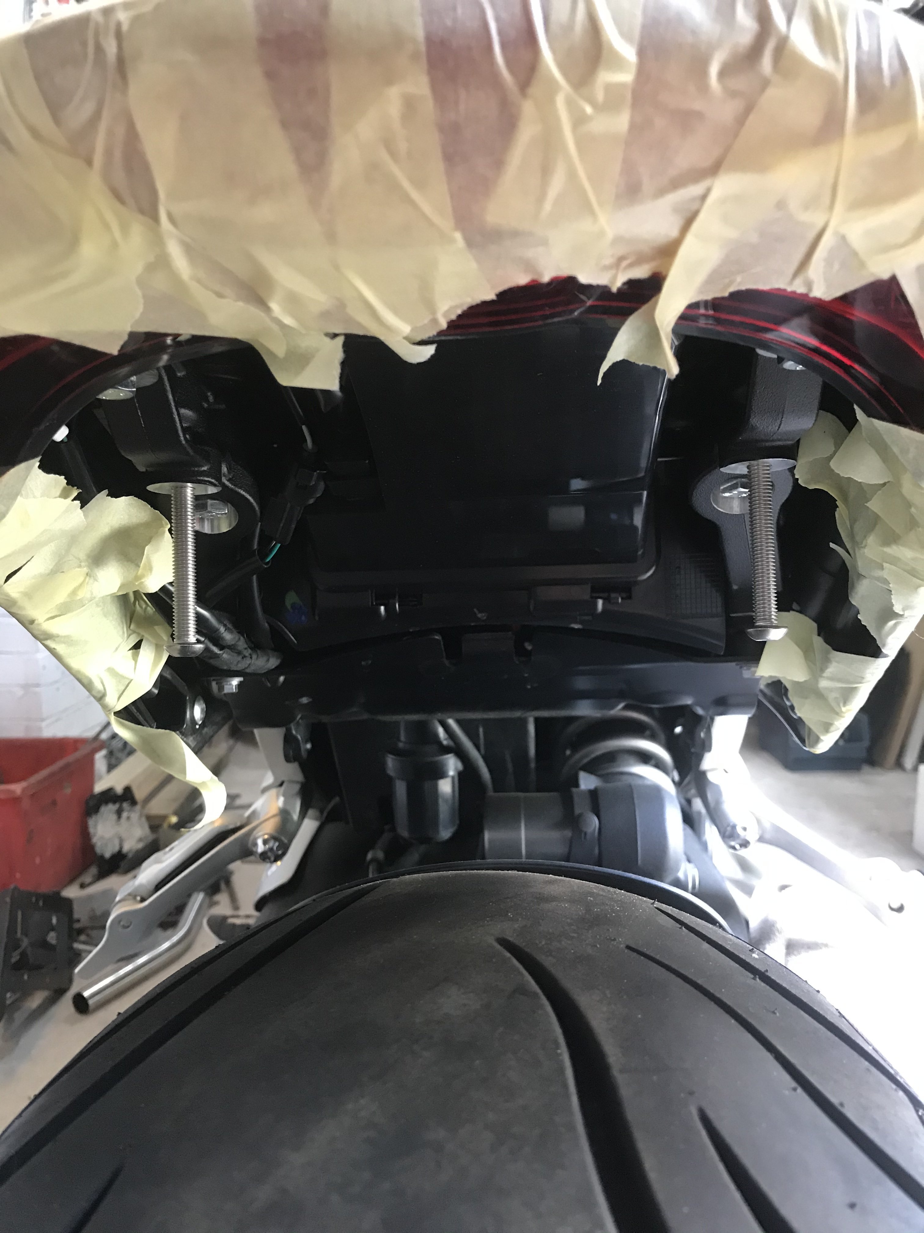

    The two dome head bolts show where I’m gonna mount the lower brackets for the side panniers :)
    Got loads of measuring and working out to do yet though :confused: 4EBAD3E8-1F21-4F02-A8B4-F94858E9731F.jpeg
    • Like Like x 11

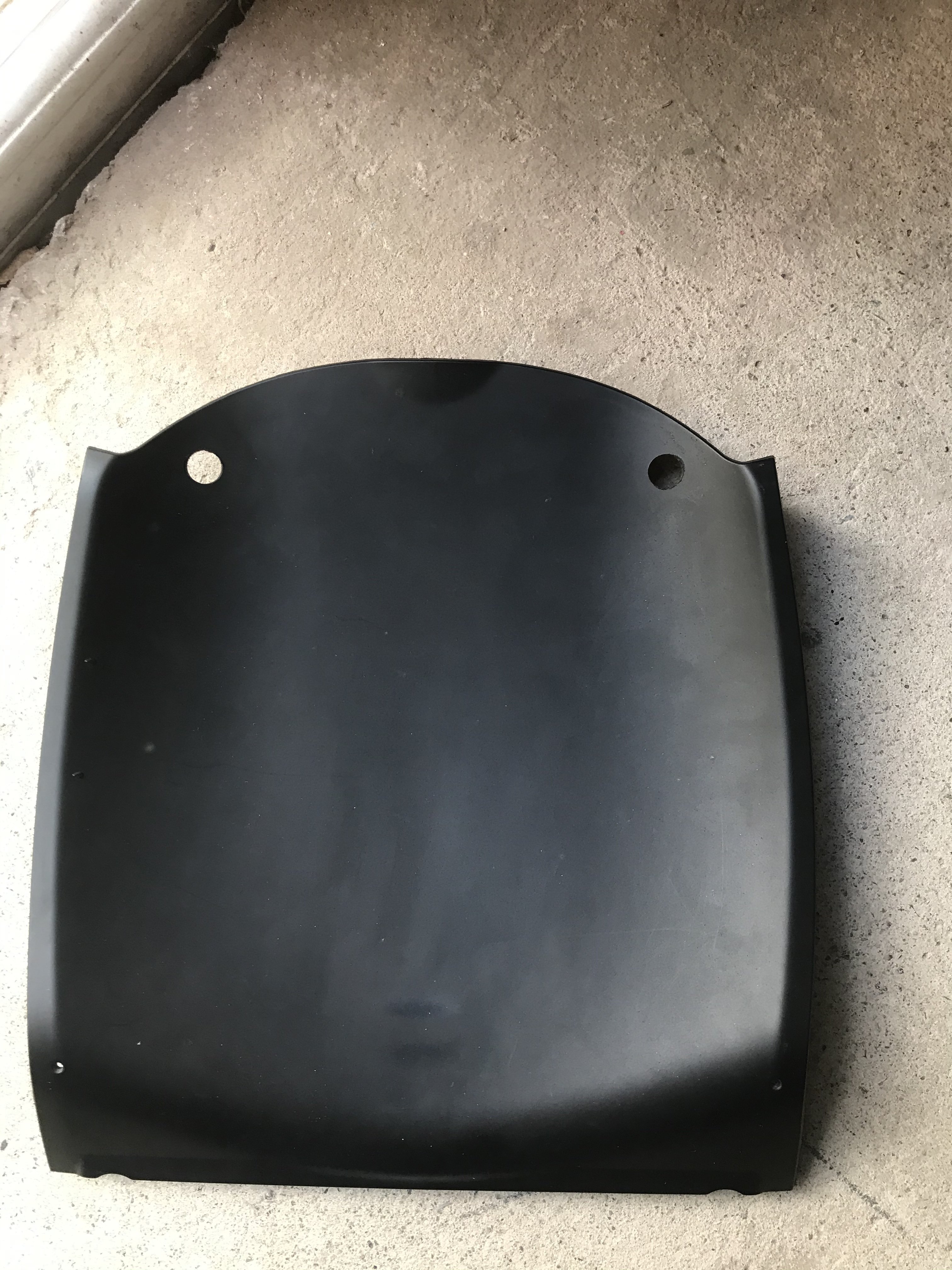

  13. dilligaf
    Re-fitted the undertray and gonna have to attack it from the top side so I get the hole in the right place on the underneath :) 8D4C5B25-C268-448A-B988-694F9D8FFEC0.jpeg
  14. dilligaf
    This is the mounting point I’ll be using as seen from the top :)
    Meant I had to remove everything that I’ve made so far to get access to it :confused:

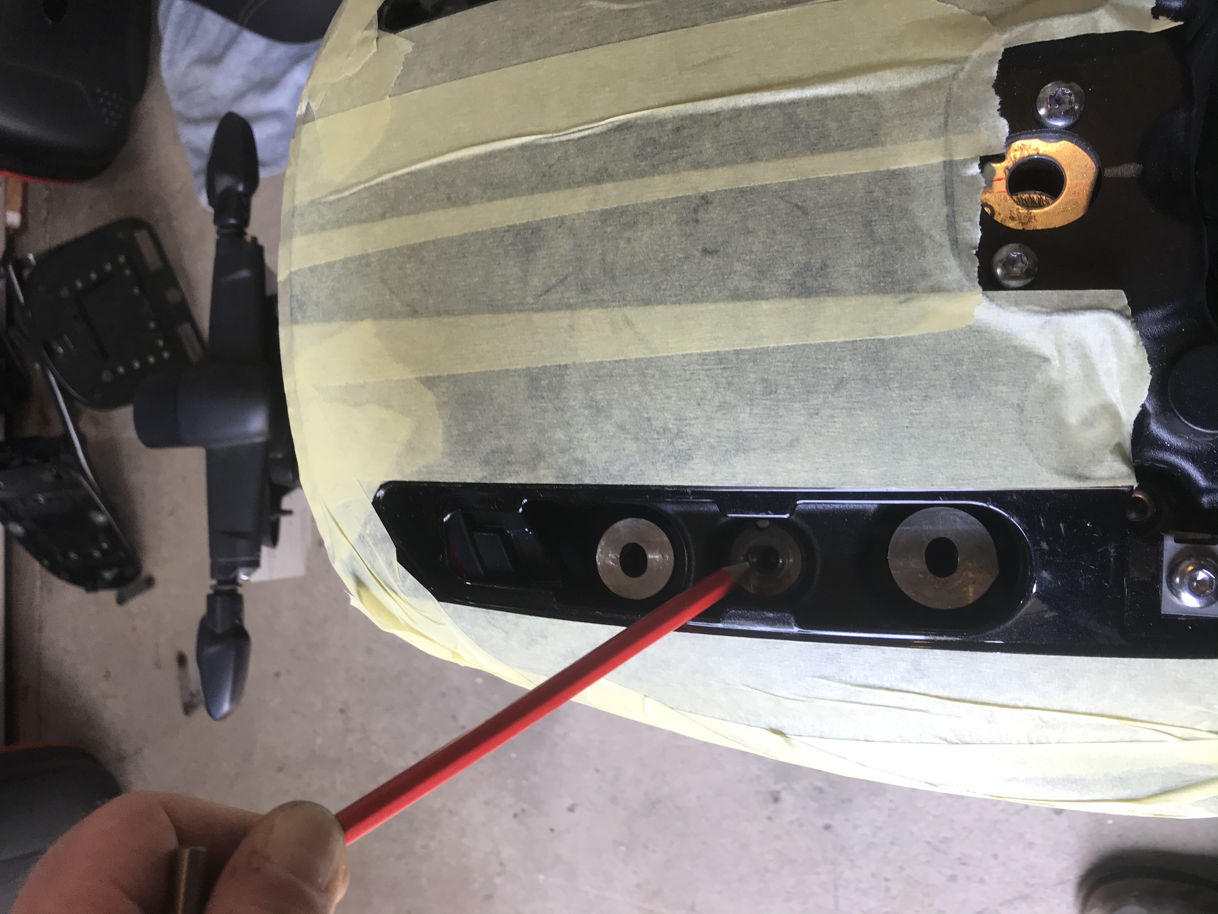

  15. dilligaf
    :eek:Nearly dropped a big bollock:eek:
    After putting the undertray back on the bike I was gonna sharpen a piece of threaded bar and drive it through the undertray so the holes would be in the right place :)
    The bar wouldn’t pass through :(
    Was just about to drill it when I thought I’d better have another look :confused:
    So Feckin glad I did :)
    The mount I was gonna use underneath is about an inch in front of the hole I was looking at at the top :eek:
    Back to the drawing board :weary_face:

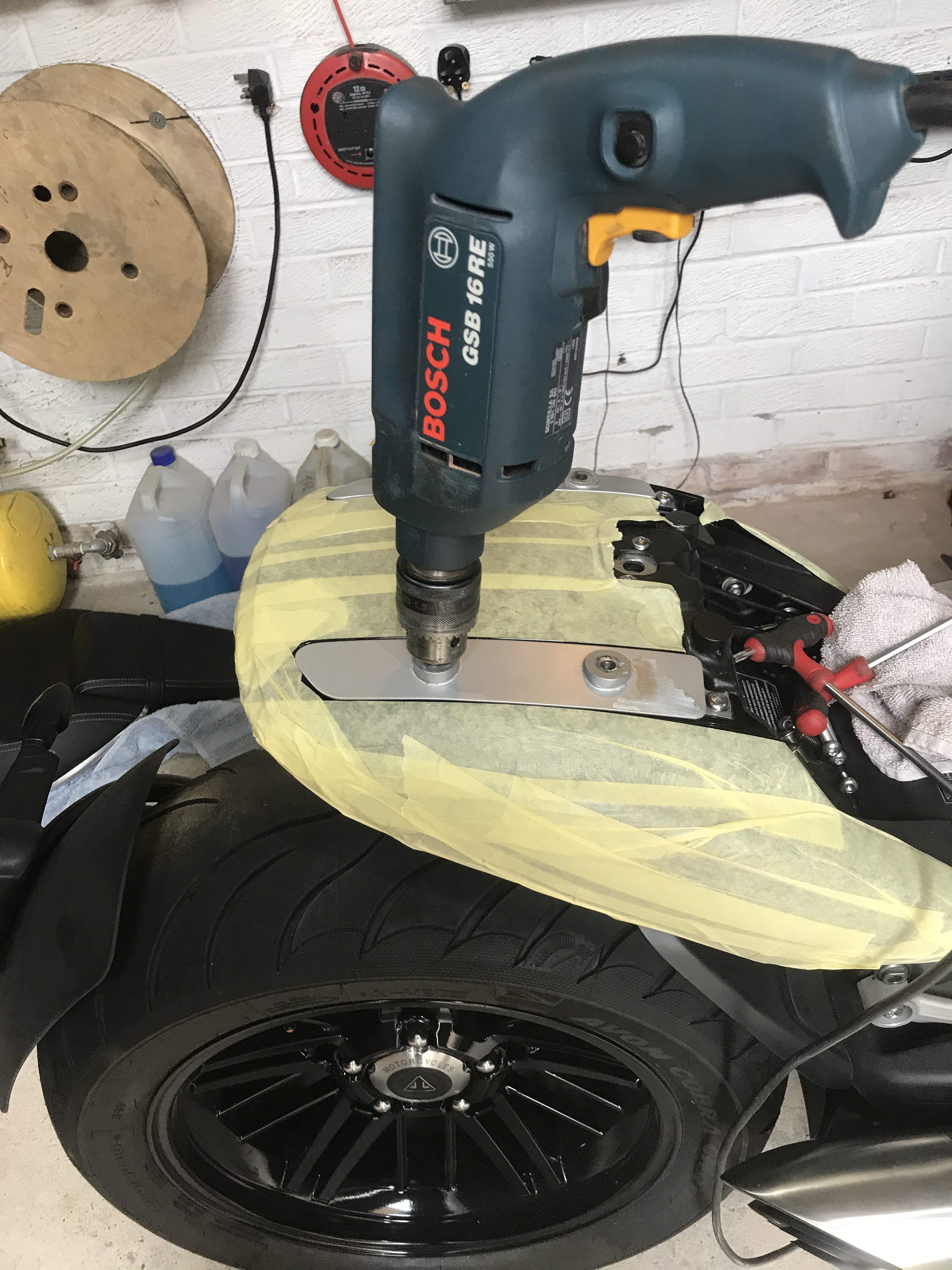

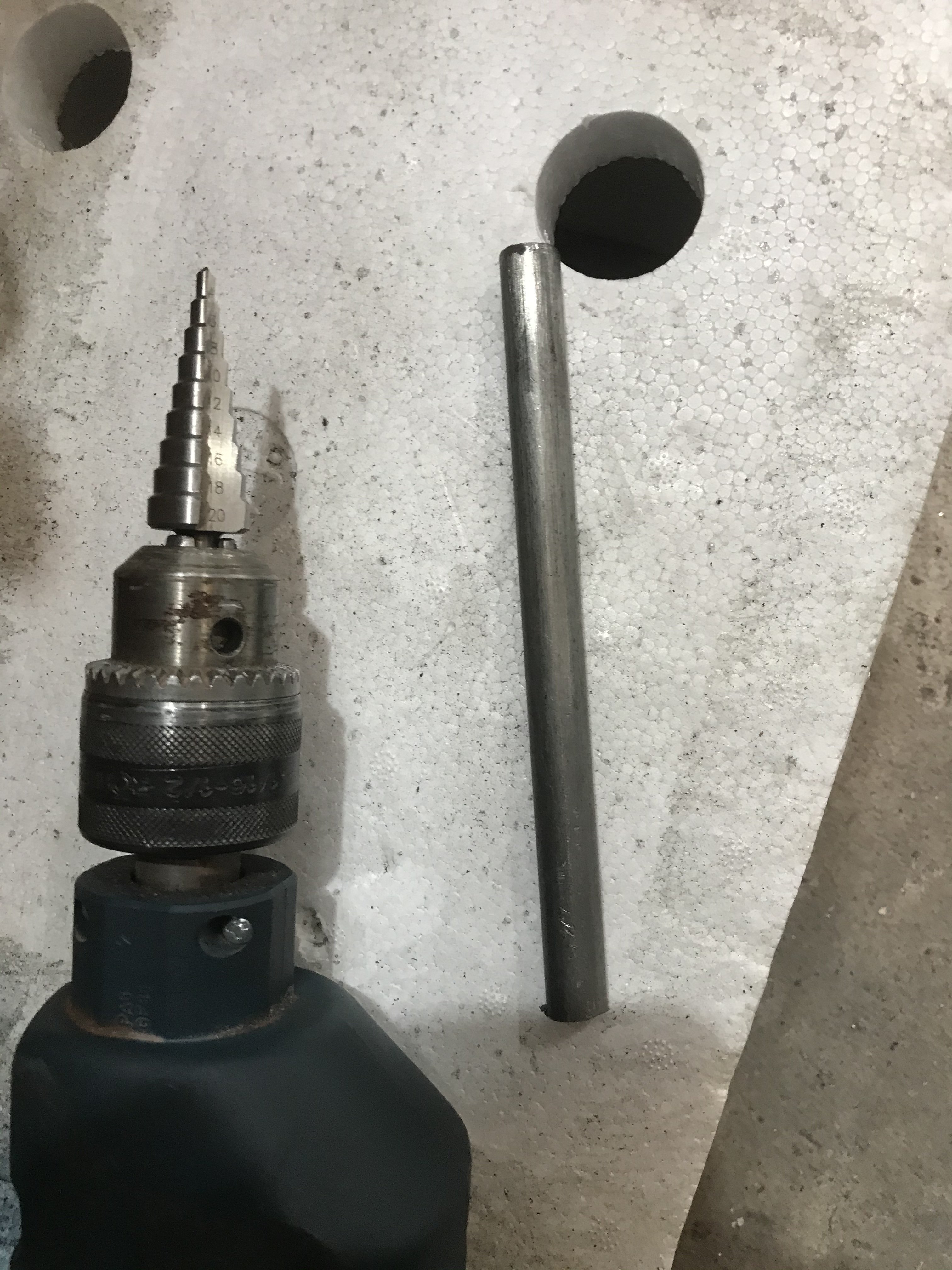

  16. dilligaf
    Getting a bit fed up of putting the Feckin undertray on and off :mad:
    But now using the rearmost mounting like I planned in the first place :)
    That’s why it was so important to get part one for CERBERUS :cool: right in the first place :)
    Anyway problem solved by passing a drill right through the mount and through the undertray :) BEF14BE1-1C02-458E-9AC8-DB970353819B.jpeg

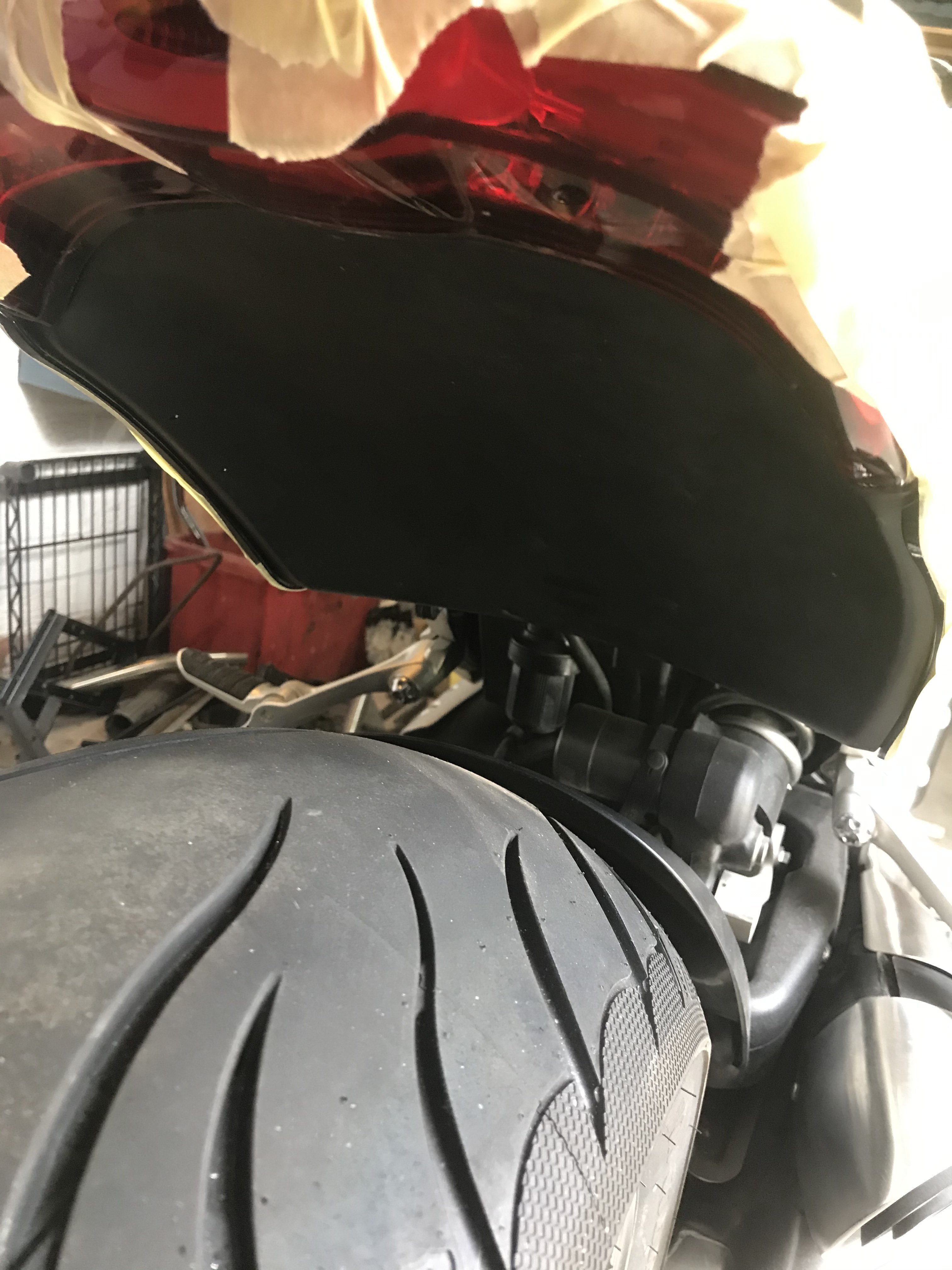

  17. dilligaf
    561FEDF5-847D-42A4-A1A4-5BCB1ED4956E.jpeg Using my hole cutter to make the pilot hole in the undertray big enough for this tube to fit through :)

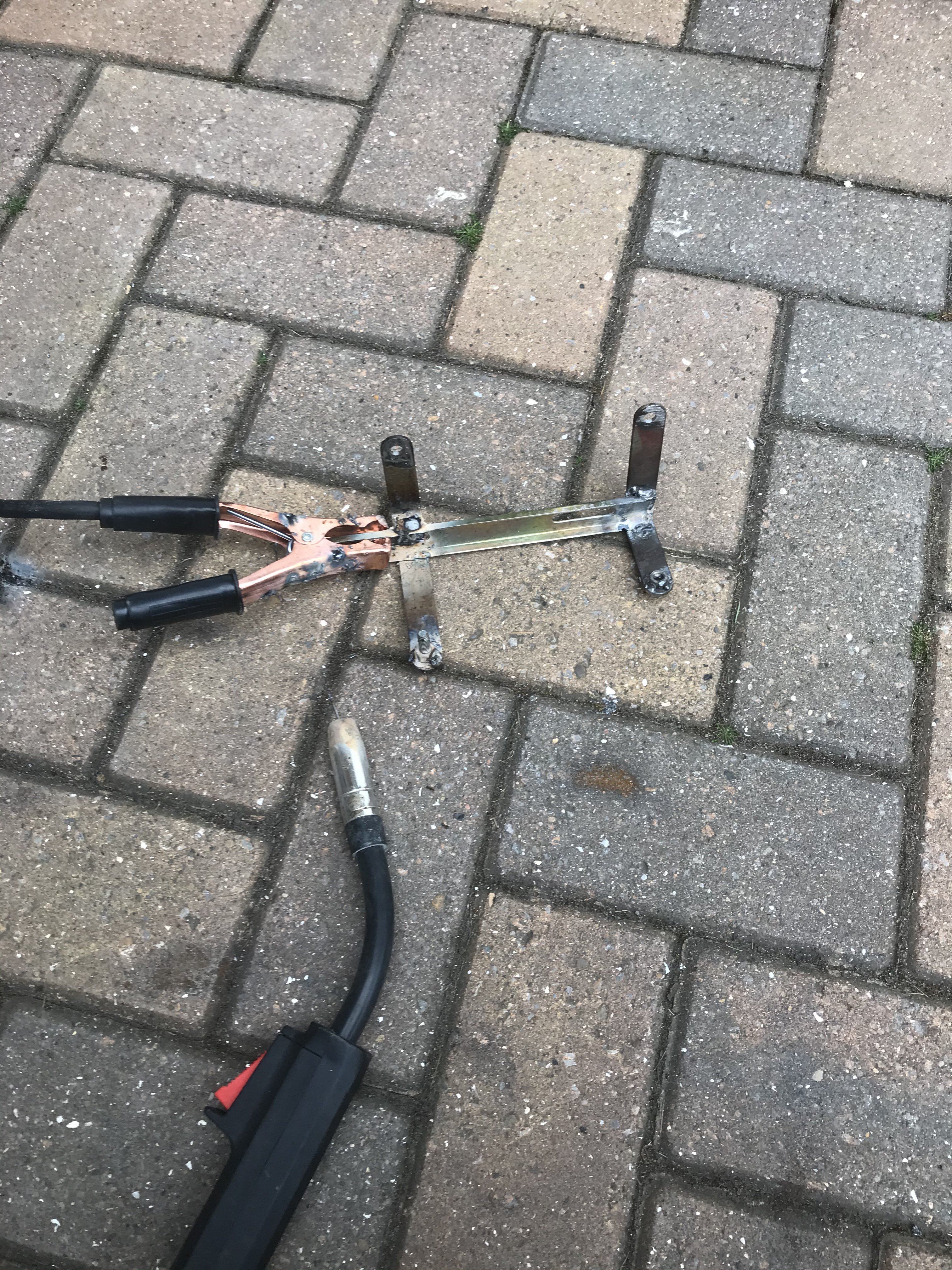

  20. dilligaf
    I’ve had a few days off from this as I misplaced my motivation supplements :(
    Started making these bobbins yesterday and after a lot of trial and error finally settled on this design and got them finished this morning :grinning: DF30F6FF-7796-44C8-BFD5-0B0CDD37E8A9.jpeg These attach to the Underneath of the bobbins I made in something for CERBERUS :cool: part one :)
    after cutting suitable dome head bolts I’m now ready to fabricate the lower pannier mounts :) 6392B9ED-DE48-4B58-AA94-40A54AAC51D8.jpeg
