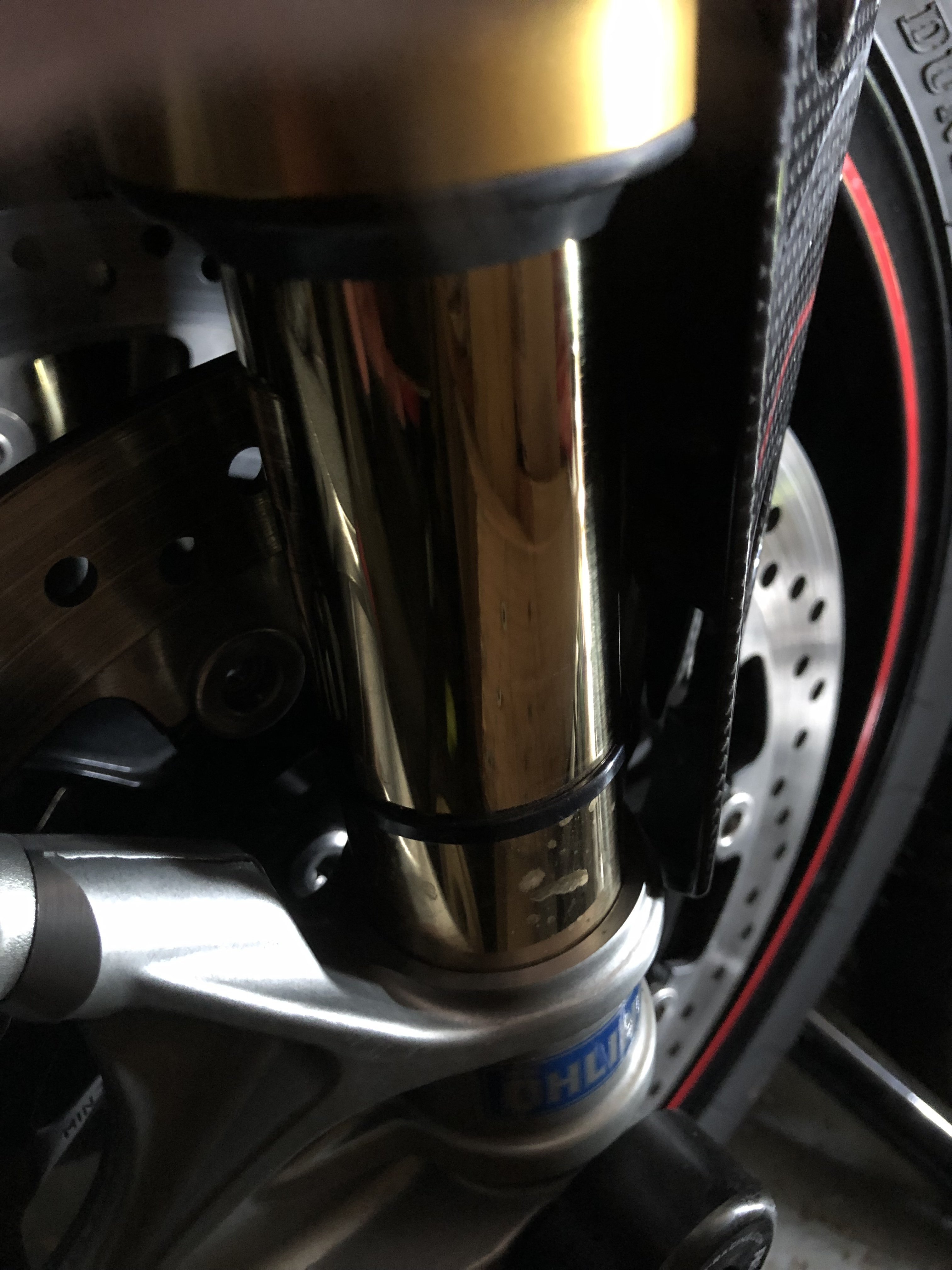

Stick a tiewrap round one of you fork lowers too, this will show you how much of your travel you are using, and you can increase/decrease preload as needed. Plus you can get her to slide up up when you are sitting on the bike, get off carefully and will show static sag.

I mixed it up a bit there, you can use it to measure both static and rider sag, slide it up to dust seal then unweight front to measure static, or with you sat on it for rider sag. But net best way to do rider as you could compress forks a bit getting off. There are a few videos on YouTube by Dave Moss showing how to measure and set sag.
