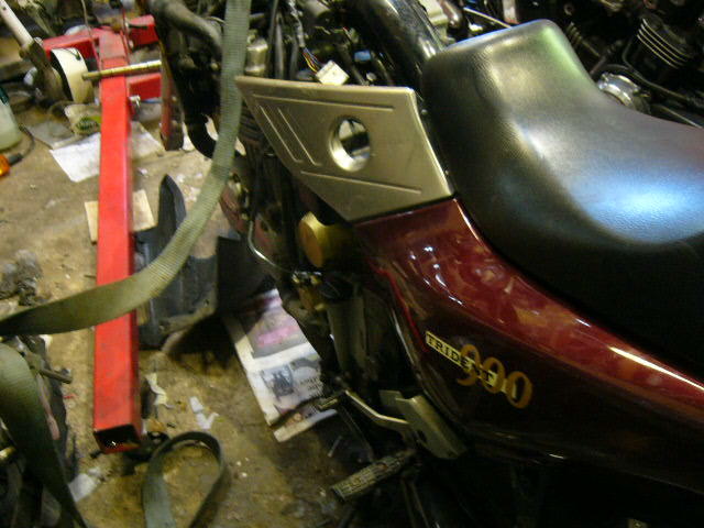

    Now that paint gate is over I have made a bit more progress. I still maintain that PJ1 is not suitable due to the high curing temperature before it becomes properly cured. A bike will normally only get to just over 100 degrees but it won't cure until 150, quite how the average home mechanic should do that is not clear. Anyway it's all black where I want it black now, the electickery is all in and working, bits are getting cleaned, checked, painted and reinstalled. I have had to use a fair few of the bits from the second bike as so much of the first bike was no good eg rad, fan, and loads of nuts bolts brackets etc. It's definitely not worth me rebuilding so if anyone needs a complete spare engine or a nice set of Sprint plastics in blue give me a shout. Anyway, here's what it looks like today, the tank has not been flatted or polished yet, it's just on there to keep it out of the way for now.
