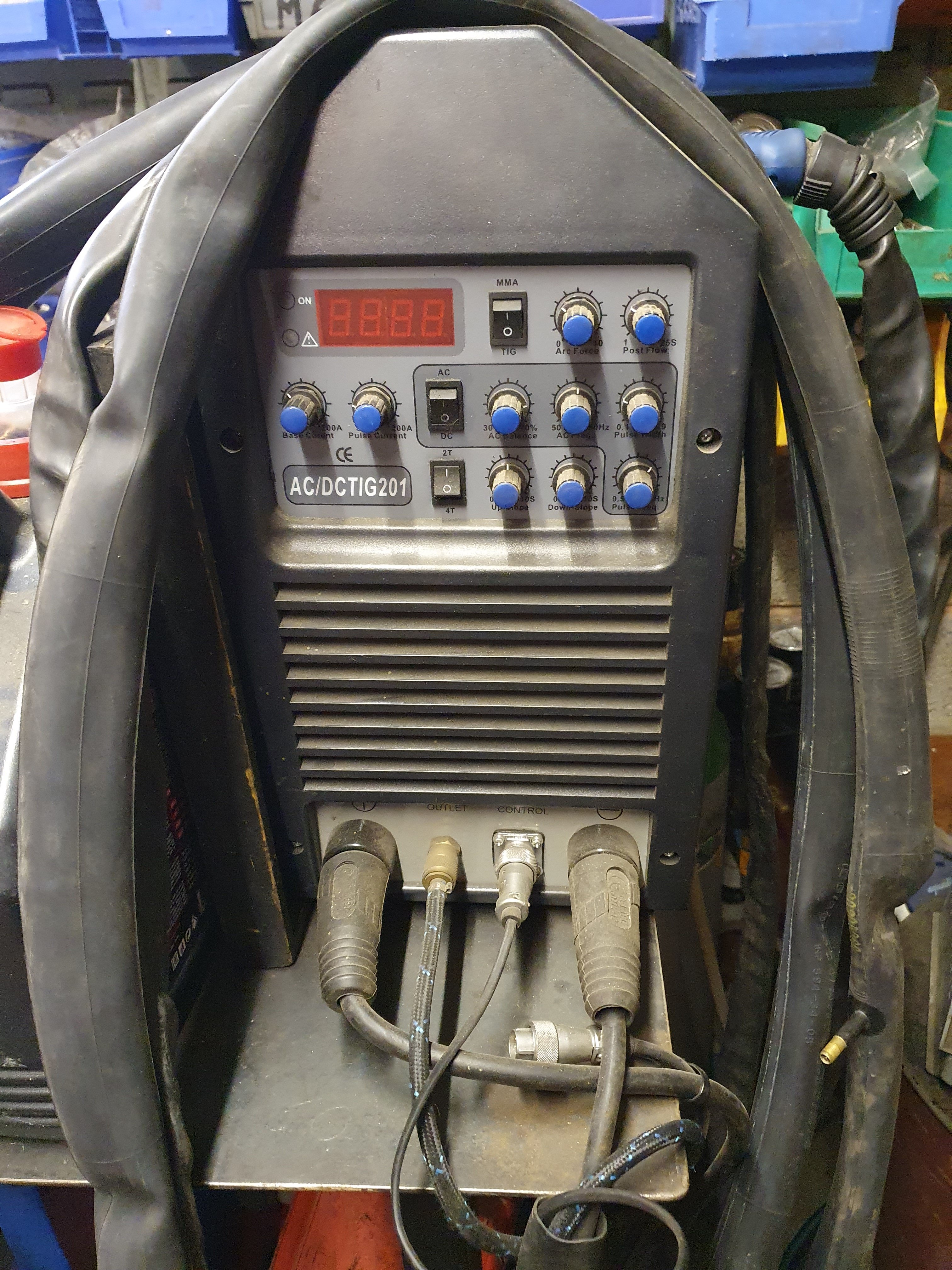

    It depends if you are talking AC or DC and what exactly "affordable" actually means to you personally?
    "Affordable housing" for example means what???? :rolleyes:
    DC for basically anything other than aluminium alloys can be had for under £500 a complete set up.
    Here is my ac/dc 200 amp set which cost over £1200 quite a few years ago.
    This is relatively cheap compared to Fronius etc.
    This set has covered all my needs, but add a further budget of around £120 per time for a non-rental Argon cylinder exchange.

    That is basically the lower power model of mine.
    Aluminium is a good conductor of heat so consequently a higher amperage may be required on thicker sections i.e. non-uniform castings.
    160 A should be ok on 2.5mm thick walled box section for example but 3mm may need additional pre heat. I often use 175-180 A on 50 x 50 x 3mm box.

    An accelerator pedal ( it is what you'd expect it to be and do) can really help a novice i.e. low amps to 100% of set value, or be of benefit to a skilled welder on tricky jobs.
    Thats the spare unplugged jackplug in my photo.
    A further expense but worth having.

    In addition to my above comments running the equipment at 100% is ok for the odd job but keep an eye on the duty cycle.
    For longer jobs the thermal cut out will do your head in and extend your working time massively.
