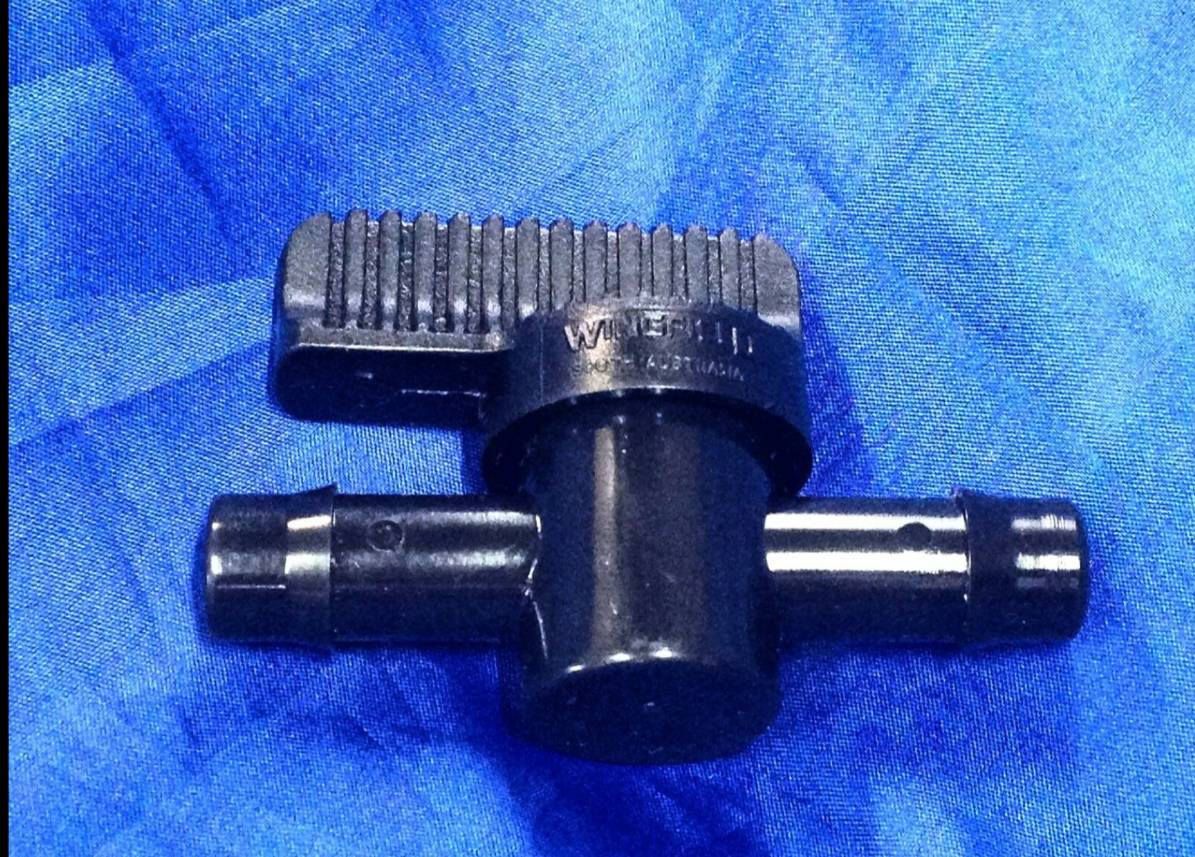

    Has anyone tried using one of these in the AI hose?
  8. crispey
    7,303
    Where do you get one of those? Is it from a home brew kit?

  14. thebiglad
    5,072
    Just a quick thought Bob, that cut-off valve device you were asking about. I would not use that as my 'test phase' method as it means cutting the supply pipe to insert the valve, and what happens if you don't like what you encounter? You would need to buy another pipe to take it back to standard?
  15. Bobbob
    Bobbob Well-Known Member
    Apr 14, 2019
    54
    West Yorkshire
    Good point well presented, I’ll find another temporary method, thanks again.
