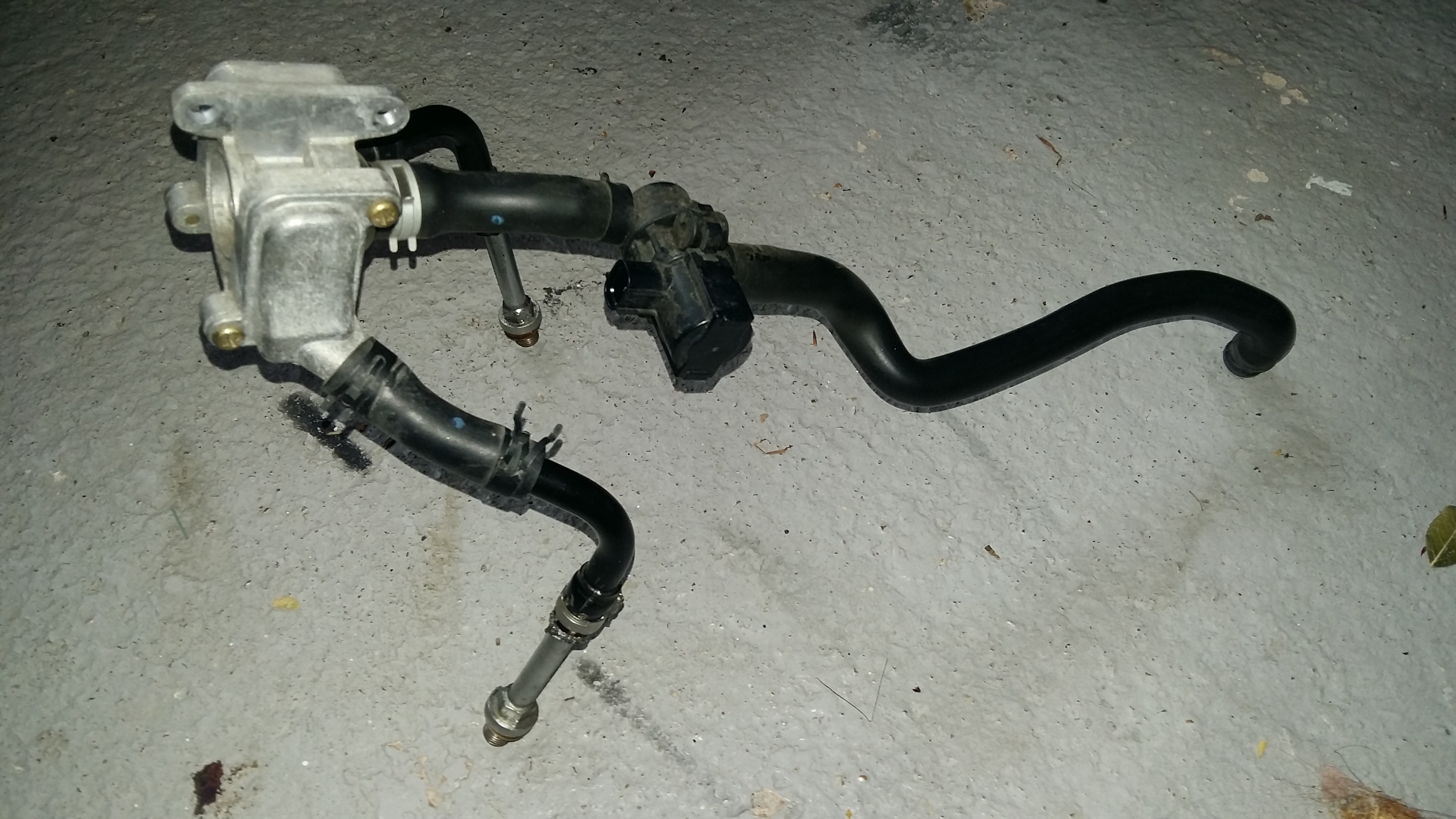

    Finally removed the dreaded AI system from the Bonnie.
    Used the "smart-moto" kit off ebay (the one from Greece with the solenoid bypass).
    Here is what you get rid of!
    Bike runs much smoother without it. :)

    Hi Mick, there are two ways of doing the AI removal in terms of the electrical side. You can do what Steve did, buy an emulator plug that sends a message to the ECU that "all is well"; or you can use TuneECU to turn off the AI within the std. map. So not really re-mapping as such, just a tiny modification.
    Both of these options are only there to ensure there are no EML lights - once the solenoid has been disconnected and the plumbing removed the AI system is no longer in place to operate.
    If you need more info about Bonneville AI removal, just ask OK?

    There's no negative to this other than the lack of popping on deceleration. No loss of performance at all just a smoother throttle response at lower revs. Also stops the pipes going blue as they run cooler.
  9. dilligaf
    Another option is to remove everything except the electrical pump you can leave this in place still connected
    It's what I've done after watching delboys garage on YouTube ;)
  10. thebiglad
    5,067
    You're right of course DG, but it means that the solenoid (not actually a pump, more of a valve) is still opening and shutting, so you get a clicking sound, especially on tickover. Not a big deal, but irritating for some pernickety gits, like me :eek::eek:

    Delboy leaves part of the SAI on to fool the ECU
    Forchetto on Triumph Rat solders in a resistor (much the same result as the Greek kit)
    If I just wanted to remove the SAI and left the silencers and everything else as standard, would I need to re-map?
    3 Options:
    1) Remove and fit the Greek kit
    2) Remove as Delboy leaving the pump in situ.
    3) Remove and solder in a resistor
  12. dilligaf

    4th option is the way to go , remove all and use tuneecu to switch the sai sensor off in the ecu. This is the cheapest option No costs, I used sump plugs from a Subaru to plug up the head where the air injectors sat.
    Mick find someone local who has tuneecu to do the map switching off sai option, I'd do it for you for free ... But shipping your Bike to Perth WA might be the limiting factor ;) :broken_heart: ?

    If you remove the sensors you will have to remap due to different fueling. It's easy to do on Tuneecu, if you can nav the forum it's no harder, nice easy dashboard to use. Also you can check the throttle body balance, mine was unbalanced from the factory which meant a small vibration at medium revs!
    Get rid of the snorkel and baffle in the air box and fit a bell mouth intake with a free flow air filter and the combo is adding BHP as well as better running.
