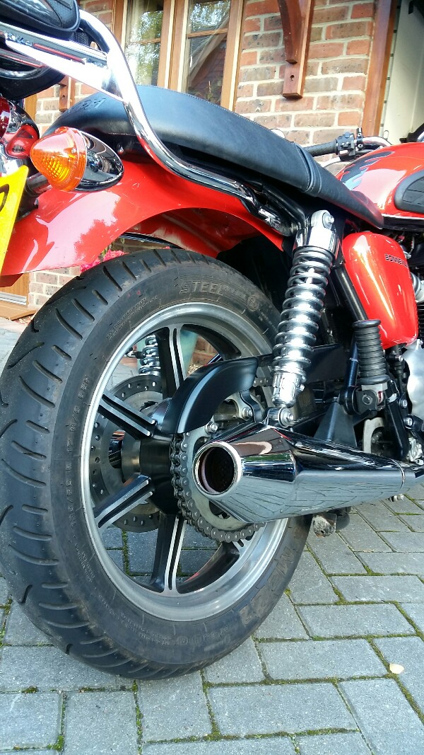

  7. steve lovatt
    They sound good on a run - not loud like the classic ones but better than stock. They sort of burble and you can hear it echo back off buildings and the hedges in narrow lanes. It suits me as a free modification - definitely worth it.
  8. steve lovatt
    Just make sure you have something in place to centre the drill bit otherwise it will end in tears. Nothing seems to happen at first and it feels like you'll be drilling for ever but it will go through ok. I hoovered out the waste with "Henry" after I'd finished.

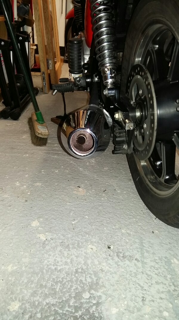

    Have now cut through the end baffle plate with the cutter and it looks much neater.
    The picture is taken end on and you can see the next baffle because if the flash but not in normal viewing.
  9. Taxpayer
    Taxpayer Member
    Sep 20, 2016
    17
    Lancashire nr Blackpool
    Thanx for update, in that last picture is that how it looks now after you have removed the 2nd wall & why did you do it? I presume you have still left the SAI system in place.
  10. steve lovatt
    No the picture is a bit misleading - I only removed the remains of the end plate to tidy things up. What you can see is the second baffle. AI is still in place for the moment.

  13. steve lovatt
    Well I suppose it counts as the second wall if you refer to the very end of the pipe (the chrome end cap) as the first wall. I cut it out because I didn't like the fact you could see it - I thought it looked untidy (presumably the reason why you painted yours) and that that the pipe looks better without it.

  15. steve lovatt
    No mate, the bike runs just fine and no different from the day I picked it up. SAI is still on for the moment and yes, I can now hear a bit of popping on deceleration sometimes, which obviously was there before but you couldn't hear it with the exhausts in stock form. Keep your drill out!
  16. steve lovatt
    It looks like this now.
