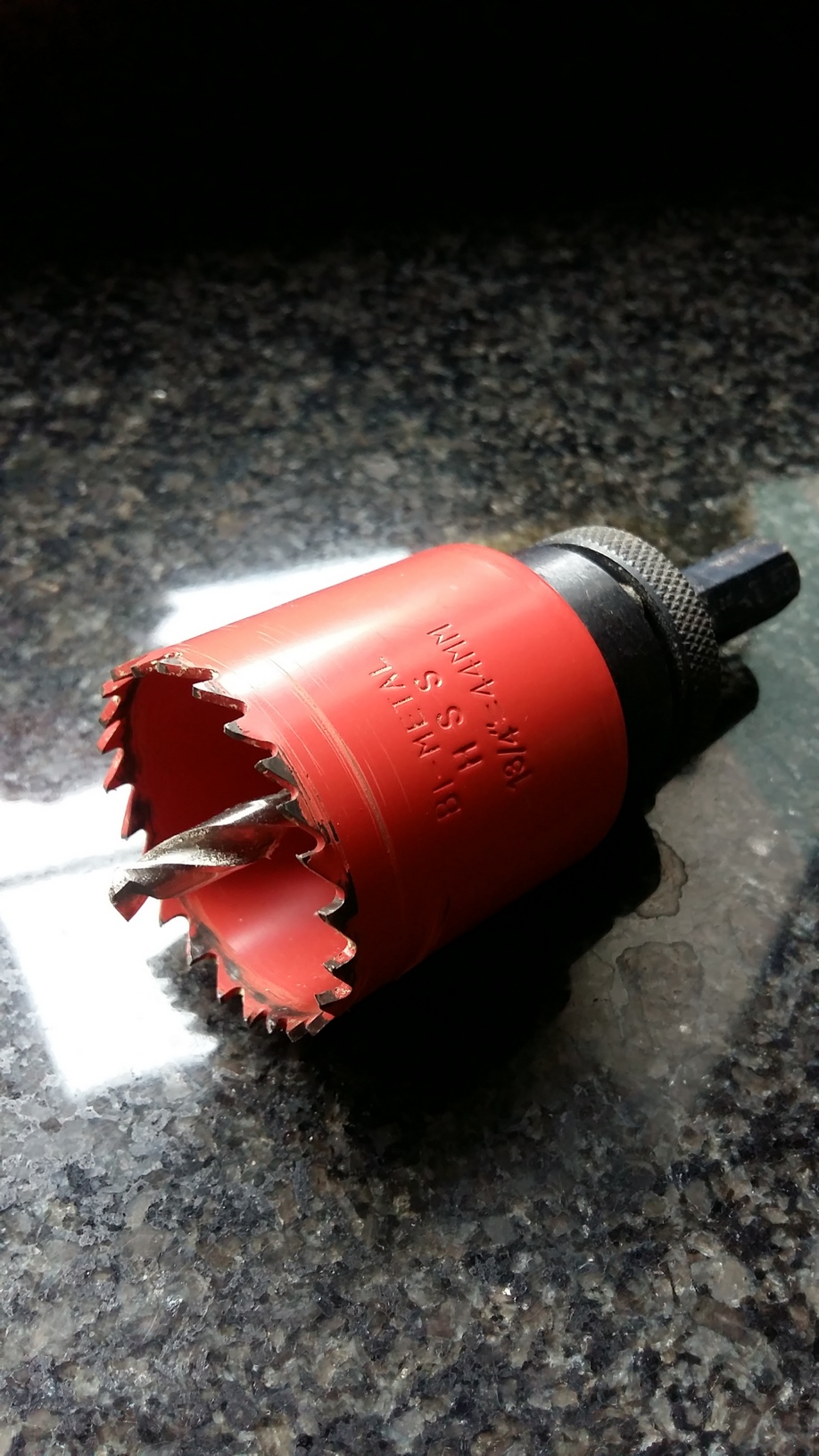

    Although I intend to get some aftermarket pipes for the new Bonnie, I thought I would "de-baffle" the stock ones for now as I did with my T100.
    Quite pleased with the new sound - a bit louder and a different sound, more noticeable on tick-over and at lower speeds.
    You will need one of these: 44mm hole cutter

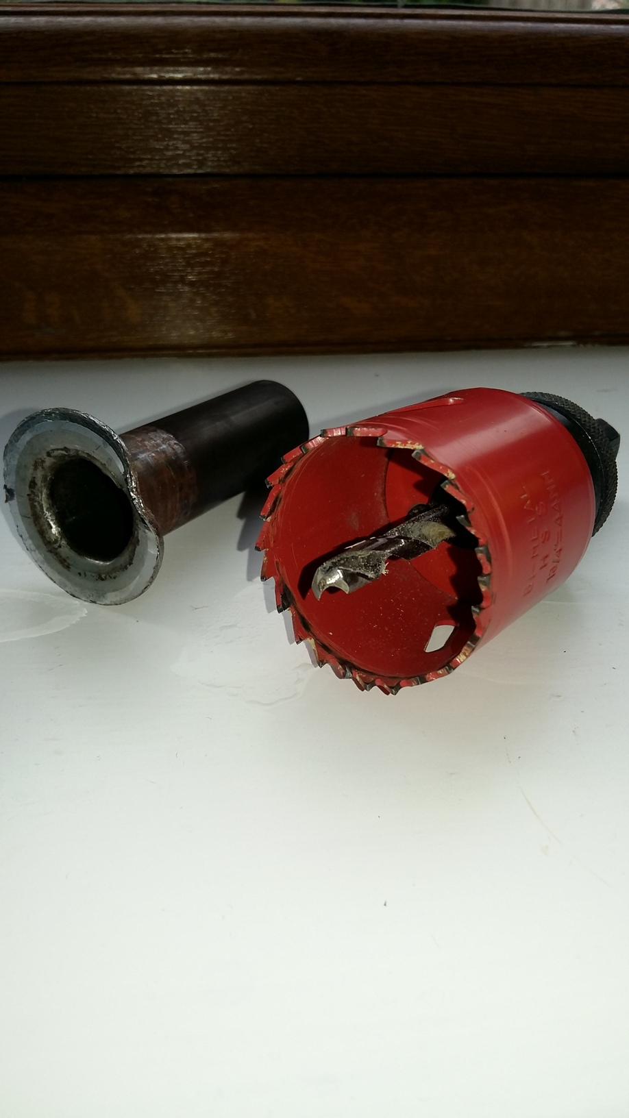

    This is what you remove: Once you have cut through it just pulls out together with the sound insulation.

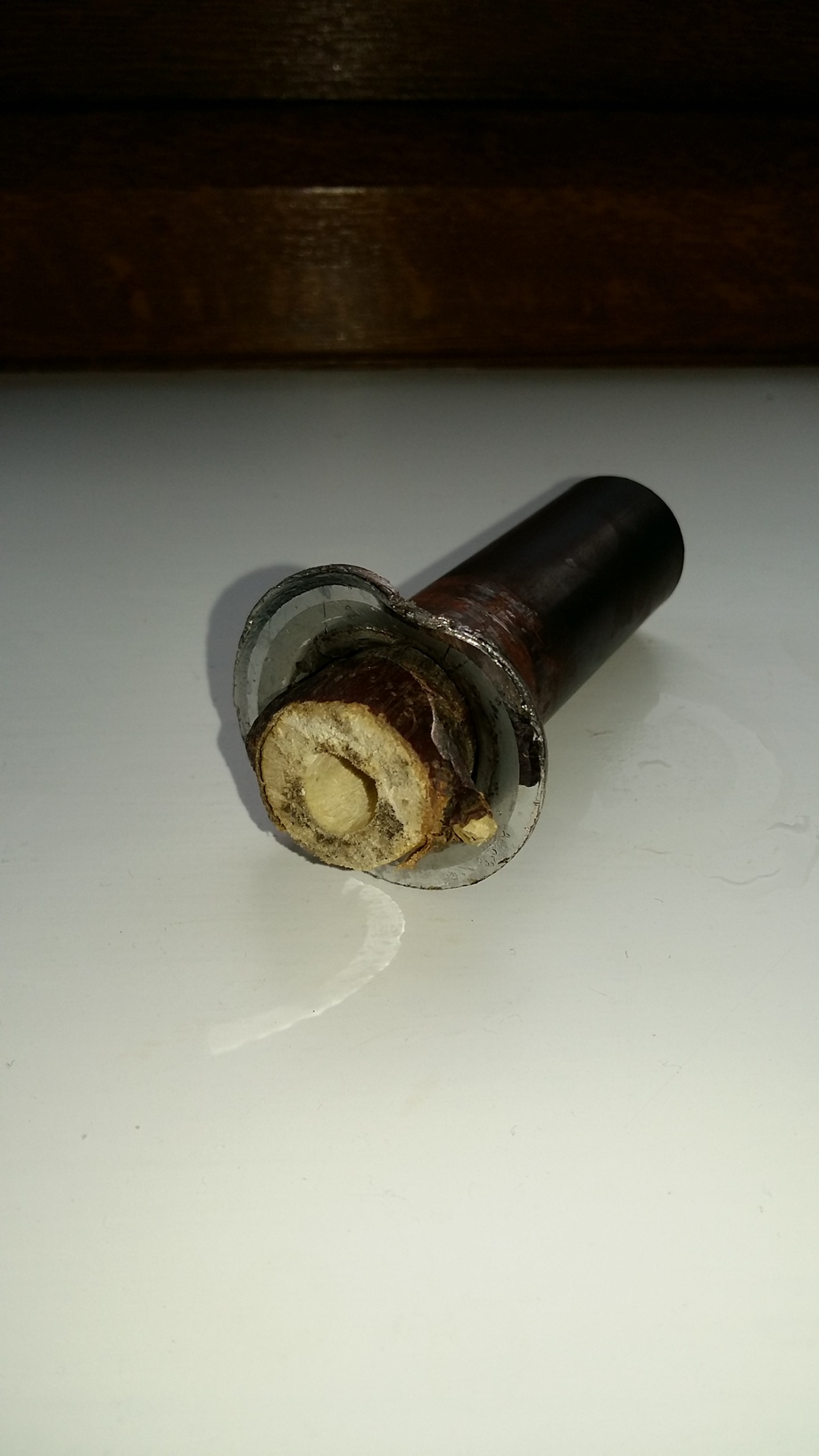

    You need to find a way to centre the drill bit - cue handy branch from the kindling pile!

  2. thebiglad
    5,064
    "Butchery, sheer butchery !!!! Is what some will say." Actually quite nicely done and good pics.
    Nice going Steve, I bet they sound better now ?
