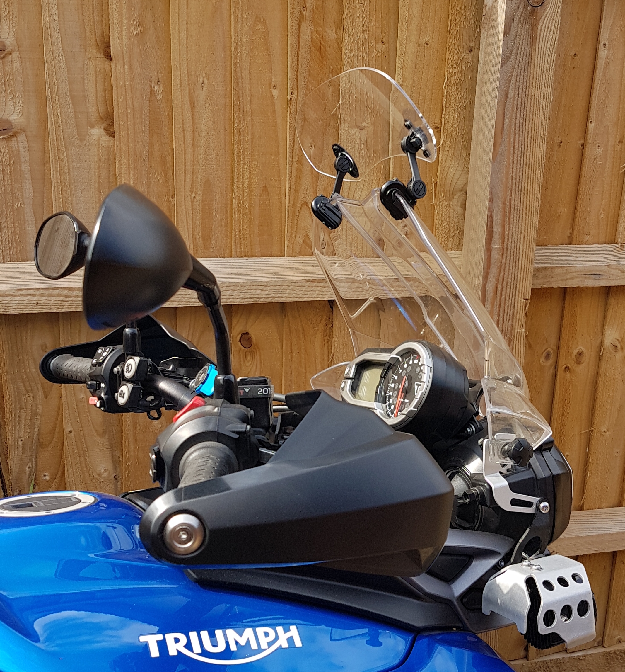

    I got a 2015 XRX recently and I'm really enjoying the bike. But the wind noise from the stock screen is, as has been discussed many times I'm sure, a real headache sometimes.
    I know wearing earplugs is the sensible option but I'd really like to hear from other 800 riders experience with the standard and after market screens.
    Is it true the standard screens on the 2018 onward are really good?
    I've fitted a little spoiler add on from weebay and after a bit of experimentation it is quite effective in some conditions but I feel there is room for improvement. 20220429_170012.jpg

    Thanks for the reply. It seems the Madstad is a Marmite option. Undoubtedly very effective but the appearance is the problem.
    I would probably have gone for a Givi Airflow but they don't seem to make one to fit the XRx with adjustable screen for some reason.
    The Puig touring looks very smart but I haven't found any positive reports from anyone who has one fitted.

    When I had mine I experimented quite a bit. I found it was actually the mirrors that were causing the most noise. Try removing them to see if it helps, if so, a set of bar ends might be the answer.
